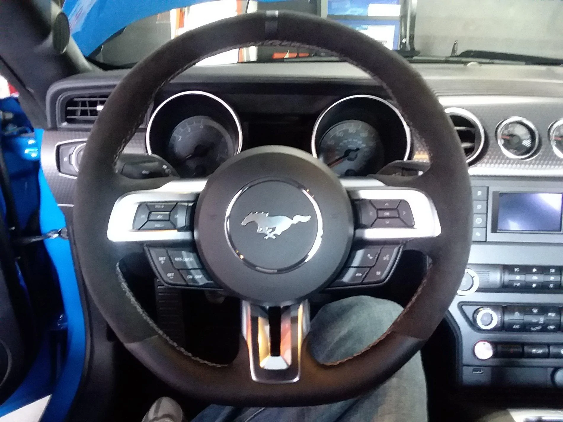

To install a GT350 or GT350R steering wheel in an 18+ GT, you will need the 18+ GT350 or GT350R wheel. You will have to swap out the switches from the GT to the GT350 or GT350R wheel. The trim will be a different color, so you can swap that too if you want. You will lose the heated steering wheel function if you had it previously. It's all a direct swap and can be done easily at home in less than an hour.
JR3Z-3600-CB is the 18+ GT350R steering wheel.
JR3Z-3600-AB is the 18+ GT350 steering wheel.
This is my 2019 GT with a GT350 steering wheel and GT trim. Definitely a worth while mod. Not only does it look great, but it feels so much better than the GT wheel. It's thicker, softer and has more grip to it.
