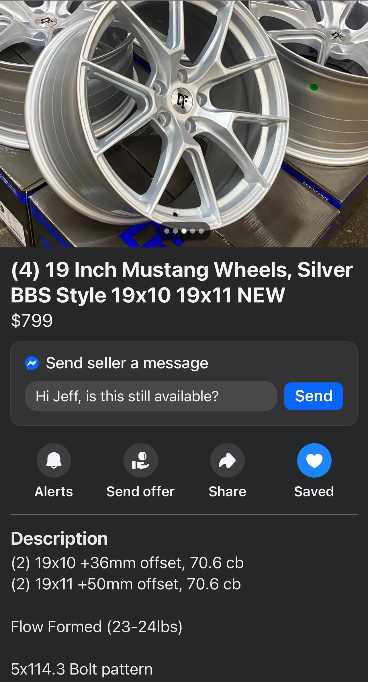

Will these fit without any modifications?
2021LMP750
Oct 29, 2024
56
230
Rockwall,TX
Kris
2021 Mustang GT Premium w/ LMP750 package installed by Long McArthur Performance
Title says it all. I found these for sale on marketplace and want to know if they’ll fit with no other modifications required? Car has stock suspension setup with no plan to lower. Also would like to know largest tire size for front and rear without rubbing. Thanks for your help.
Need4SpeedMotors
Nov 17, 2014
194
21,562
5,144
Los Angeles, CA
www.n4sm.com
N4SM Team
These will fit no problem according to the specs listed. widest tire you can run on these specs are 285/35/19 front 325/30/19 rear
