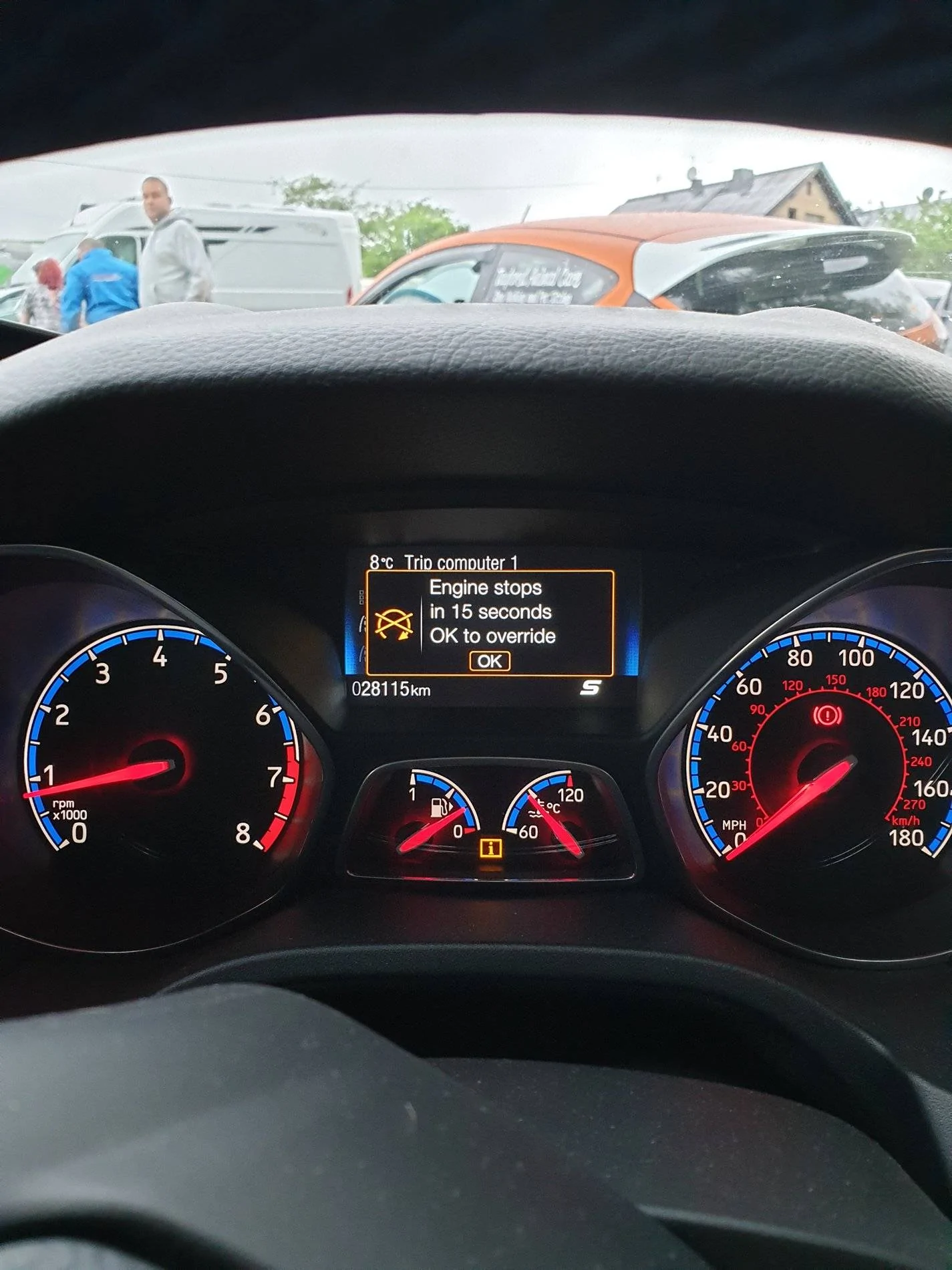

2017 Focus RS
I'd imagine that it's the same for all fords, I had this pop up on my old RS when it had been idling for a while
