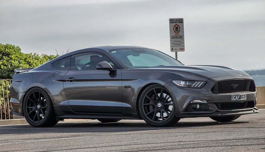

Wheel width will depend on the offsets of those wheels. I had no issues running exact same wheel and tyre sizes on my last car. Fronts were a 30 offset, rears 55.
Your speedo will most definitely be off, because the rear tyre diameter is 4% larger from memory. You can either correct that in Forscan by following the instructions in the wheel & tyre section, choose a tyre with a diameter closer to stock, or just put up with it and drive marginally slower around speed cameras which is what I did.

Thanks
They have a +20F and +50R offset
Do you by chance have any pics of yours on your car

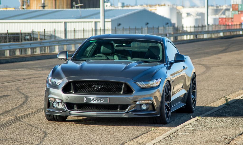

Man 20 is a very aggressive offset, I experienced rubbing on mine at +30 - we're talking no paint left underneath the fenders (although I was very low on coilvers). You're talking about 10mm more poke than mine, not sure that's possible.
The rear is fine with enough camber, again kinda depends how low you are.
Camber in these photos is -2.2 at front, -1.4 rear
Stock suspension setup on mine.
They do look good on your car thanks for the pics
