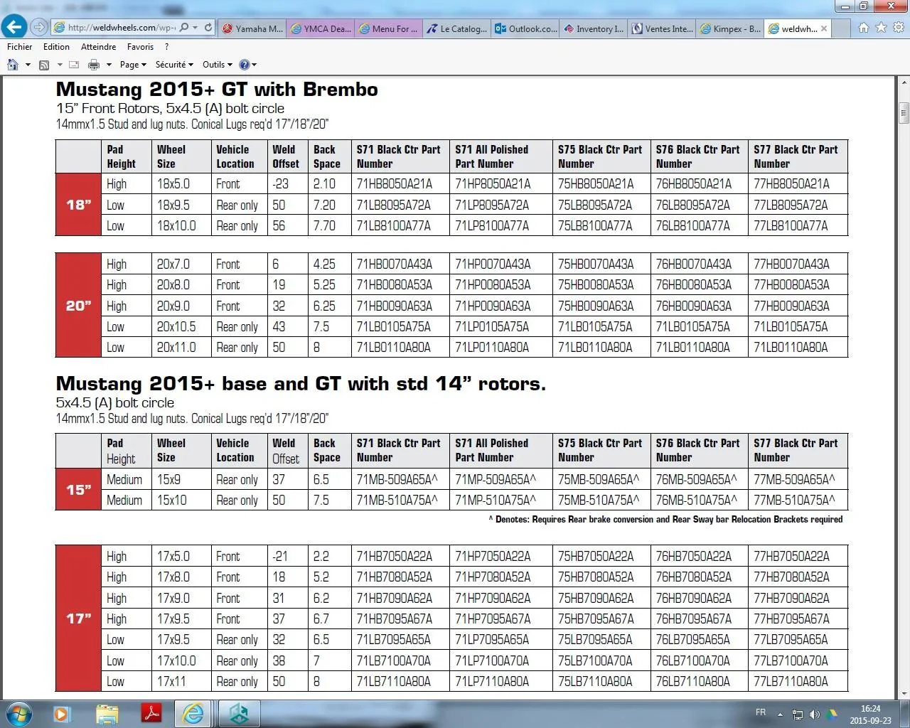

hi
rear brake is the same or not with PP brembo and GT
the 17 is not list with the PP for the rear wheel???
help me :)
3sgte
Aug 11, 2015
38
montreal
BLACK
both GT and GTPP have the same rear caliper with 13inch brake rotor?
why the rear Wheel listing is not the same
