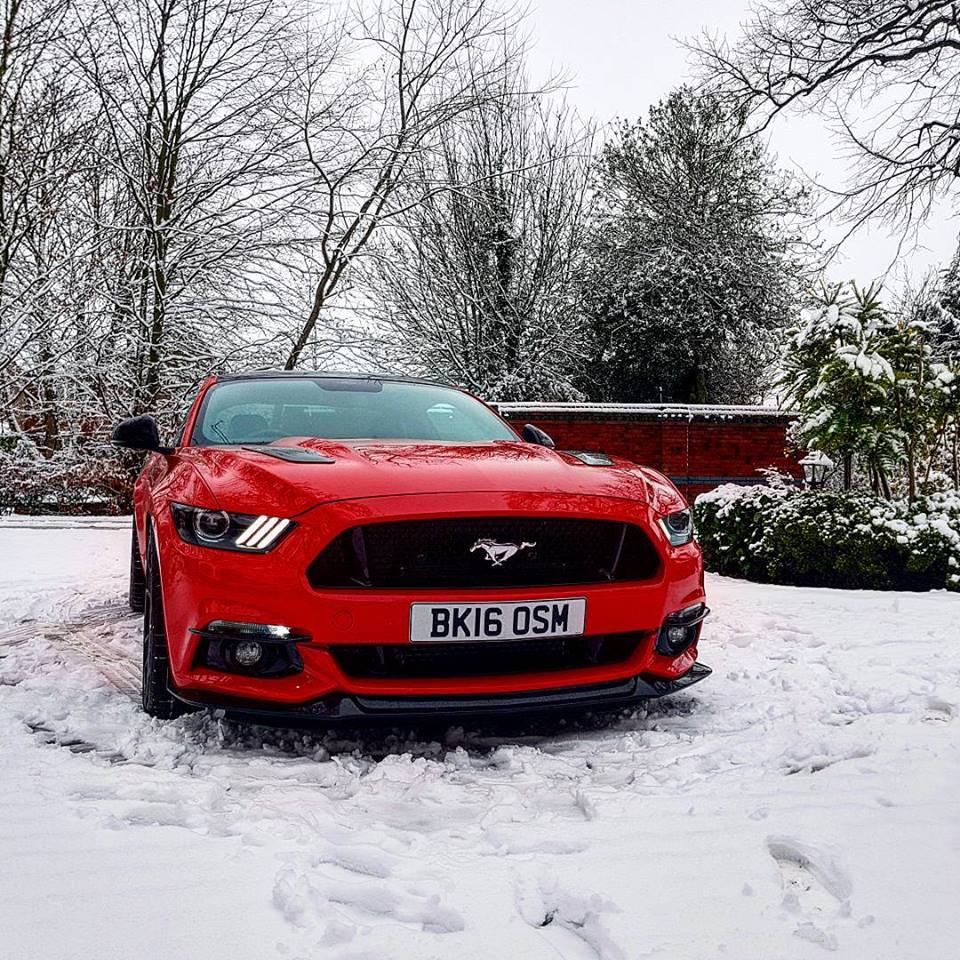

Spare, i wouldn't say it's spare. I have a second GT splitter... however it's nowhere near as just easy as putting it on and it bolts up. The job took me a good 20+ hours and is definitley not something i'd ever recommend.
Your best bet is to buy the cali-special splitter, as it bolts straight up.
What you'll need is:
GT Bellypan
GT Wheel Arch Liners
GT bolts (or just some 7mms)
GT Splitter
GT splitter mounting bracket (I don't have one of these, it's on my car the only one i had, it comes when you buy it).
All in all it costs a fortune to do "Properly"
I've somewhat hillbilly modded mine adding some extra mounting plates to the corners and shimming the front of the belly pan down so it fits into the wider and front spacially shorter splitter.
Alternatives other than the afformentioned CS splitter is actually painting it gloss black (EBM ONE) and painting a splitter from steeda/apr also gloss black, and then it'll look more aggresive, paint the mounting rods black and bobs your uncle.
Seriously though, don't fucking do it; and i rarely tell people not to lol!
Here's a shot of my EBM with it:
