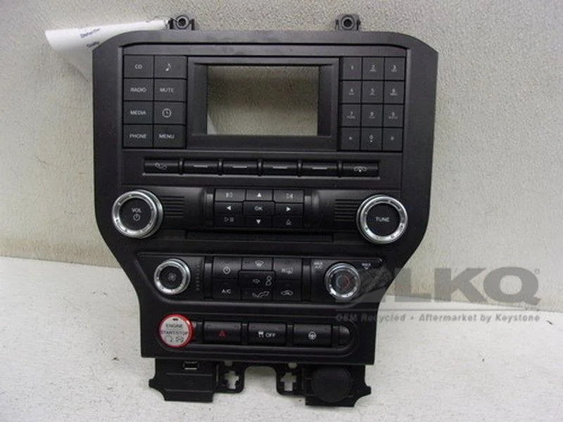

I own a 2015 Mustang Gt. 5.0, with a new Chinese 10.1" stereo.
(you know the one).
After , A lot of troubleshooting, with the can-bus, I have discovered the AC side of this board, to be bad. It had decided to stop talking. :(If I run forscan, the module does not respond.
I am able to control fan speed, vent changing, and the light on the ac button does light up. But this is it.
My compressor will start and blow cold, if I jump the pins on the relay..
Also, in case you wonder if I checked r134 levels, Well yes I did with my trusted gauges, and levels are good. I do question the pressure switch, though. Don't know why, but it just looks guilty, lol.
So,
I would like to check with our members, if anyone has one of these circuit boards , that they would let go of? I can not pay very much. Cheap would be great.
