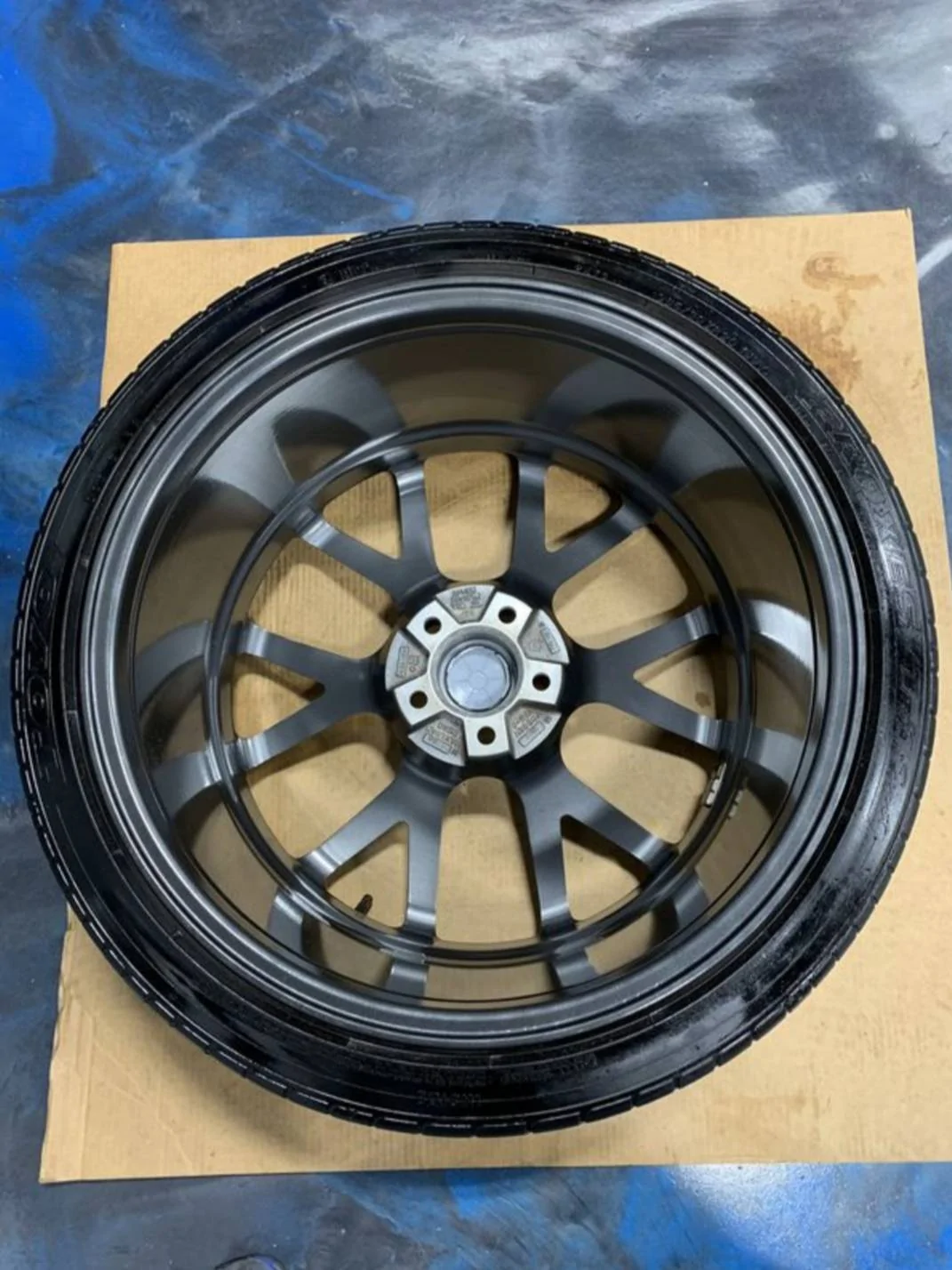

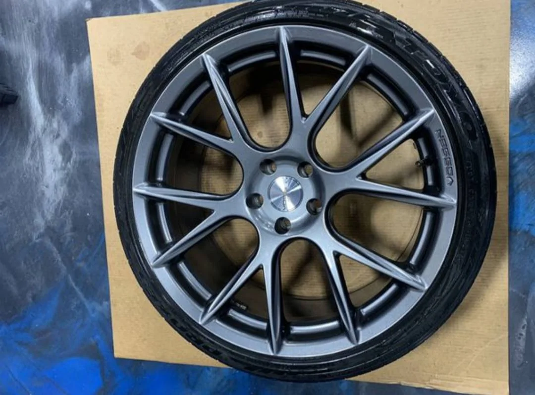

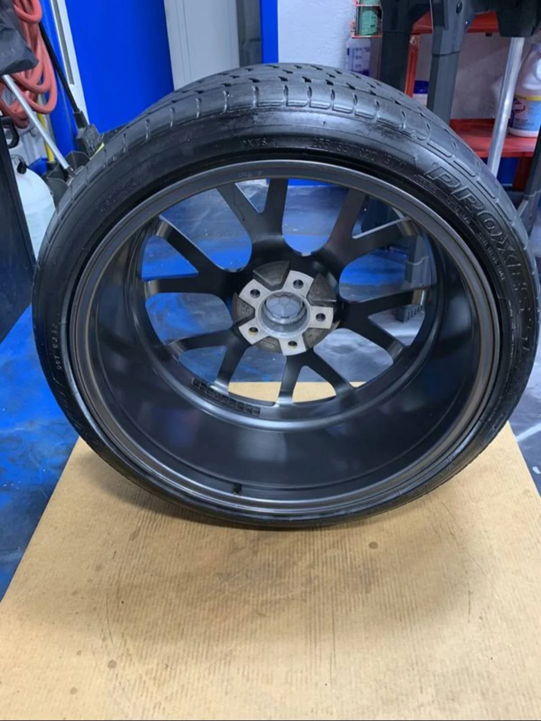

I'm looking to buy purchase these rims and I would like y'all input.
Gloss Gunmetal Finish with Toyo Tires

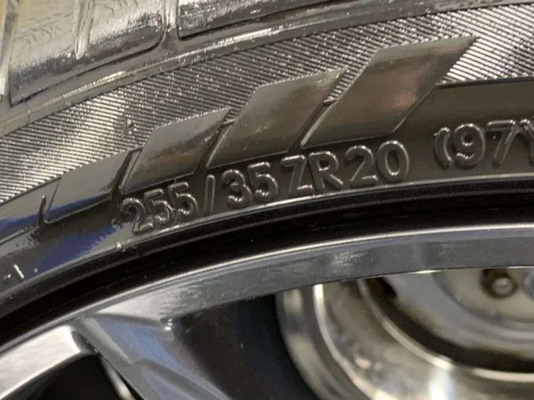

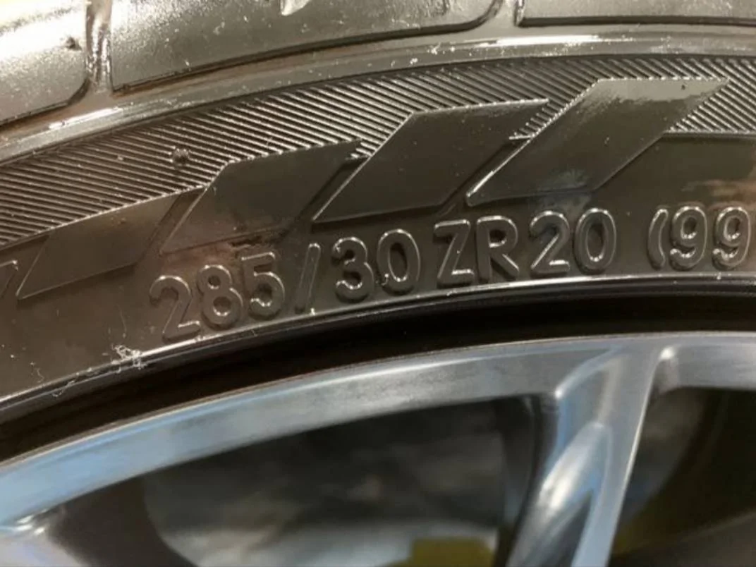

20x9.5 ET 25 Front (Tires are 255/35r20)
20x 10.5 ET Rear (Tires are 285/30r20)
5x114 Bolt Pattern
Brand New Center Caps
Full set of Gorilla Locking Lug Nuts with extra key
Rims have under 4,000 miles on them
what's the biggest tire I can go with the 10.5 without it looking odd.
Is the 25 ET enough or would I need spacers.
I tried looking for these rims on a black mustang but cant find any.

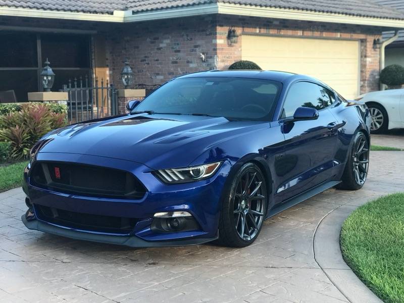

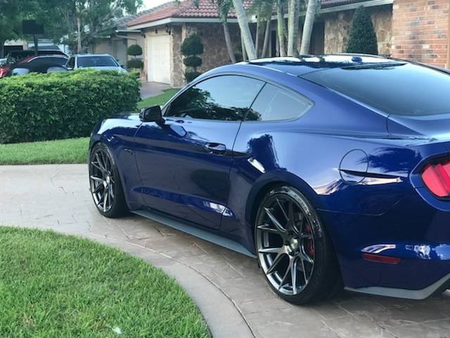

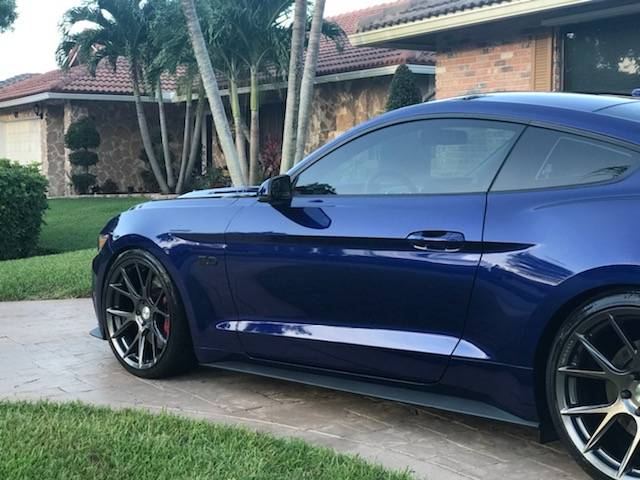

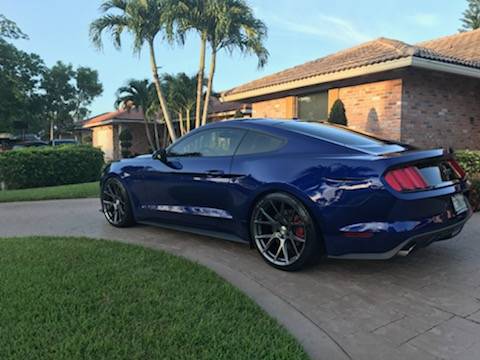

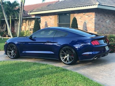

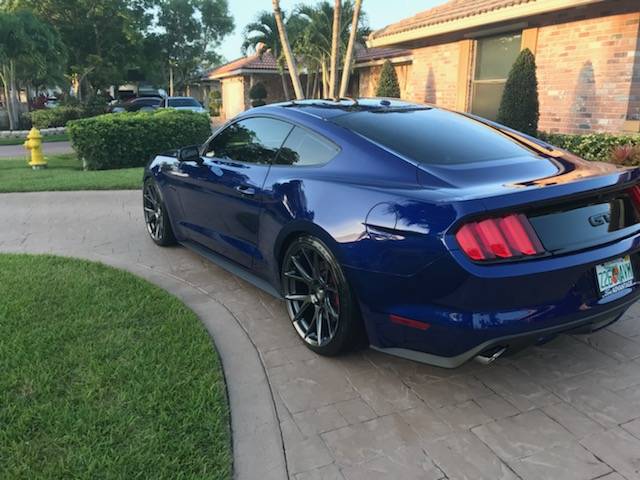

The guy selling me these wheels sent me pictures of how it looked on his GT. Im in love!
That looks good. The rear doesn't look like it sticks out more than the front, which is what typically happens when the front and rear offsets are the same.

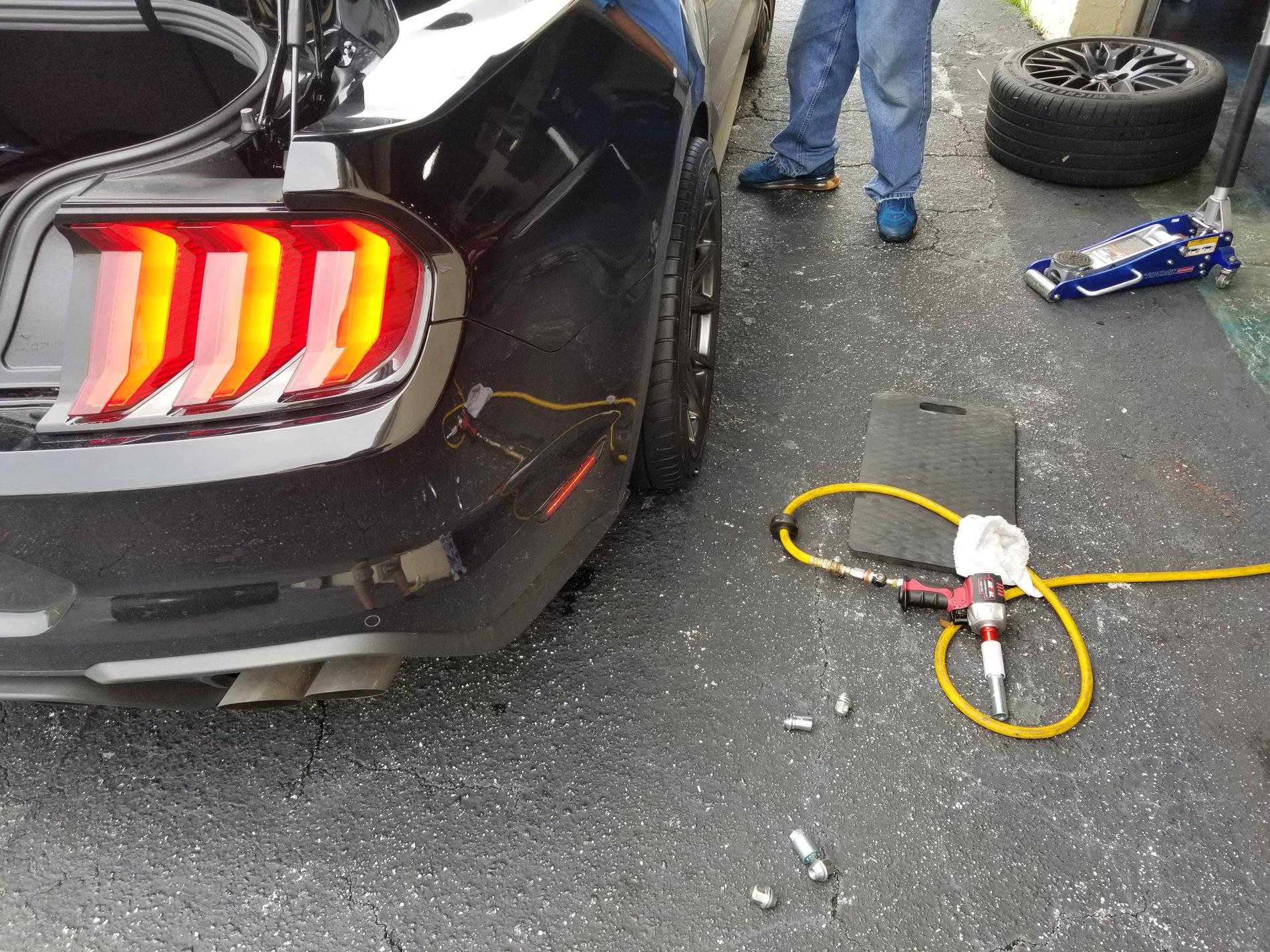

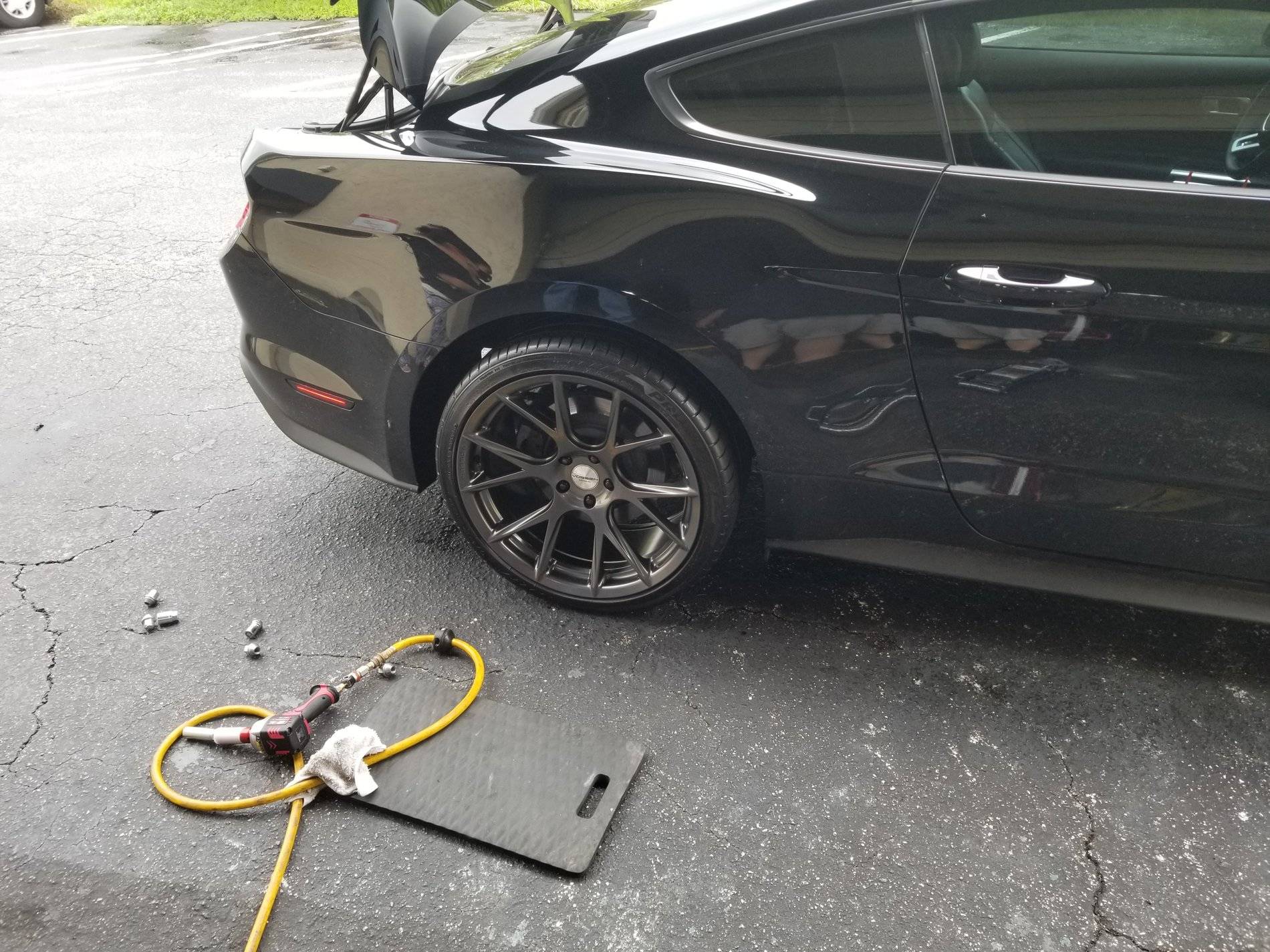

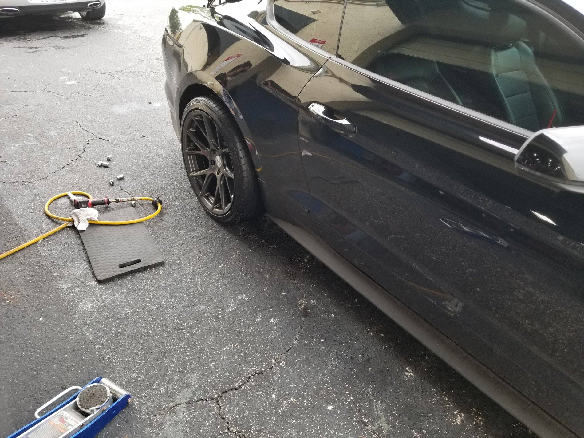

So I was finally able to test fit the wheels and the poke seems like alot. I don't mind that height as that can be fixed with a drop. Will come camber and a drop fix this or should I find a wheel with better rear offset?
MidwayJ
Sep 9, 2018
1,882
2,868
Dallas, Texas
Jay
2019 Mustang GT Coupe
I don't know. You might try the aggressive fitment thread. I try to stick with offsets that get you to flush but don't poke.
