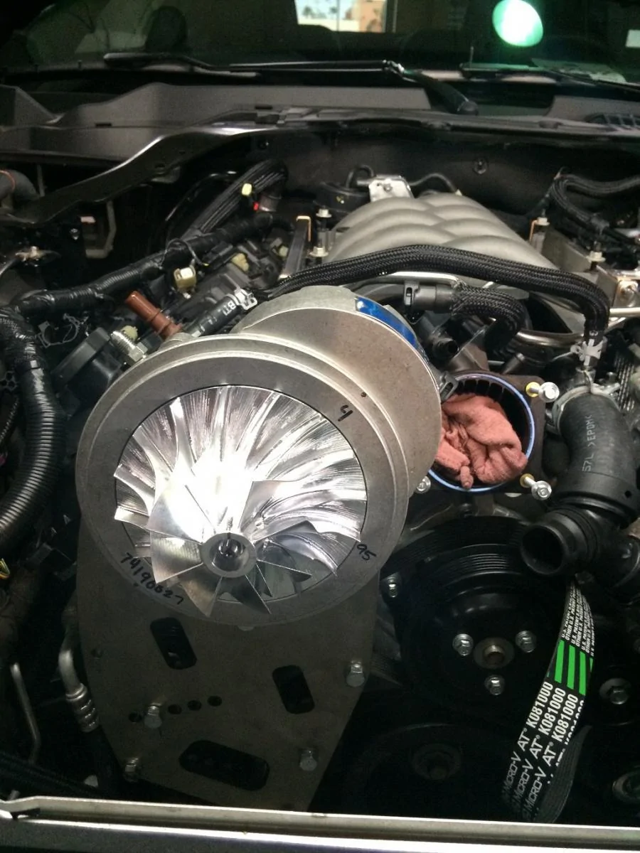

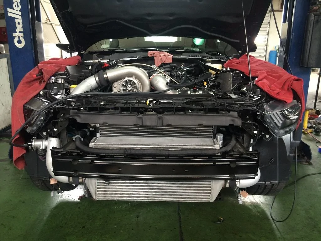

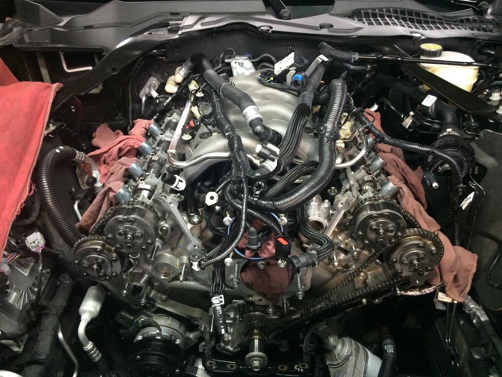

power I looking for is somewhere around 700-750 to the wheels on 93 and 800+ with ftw red race gas

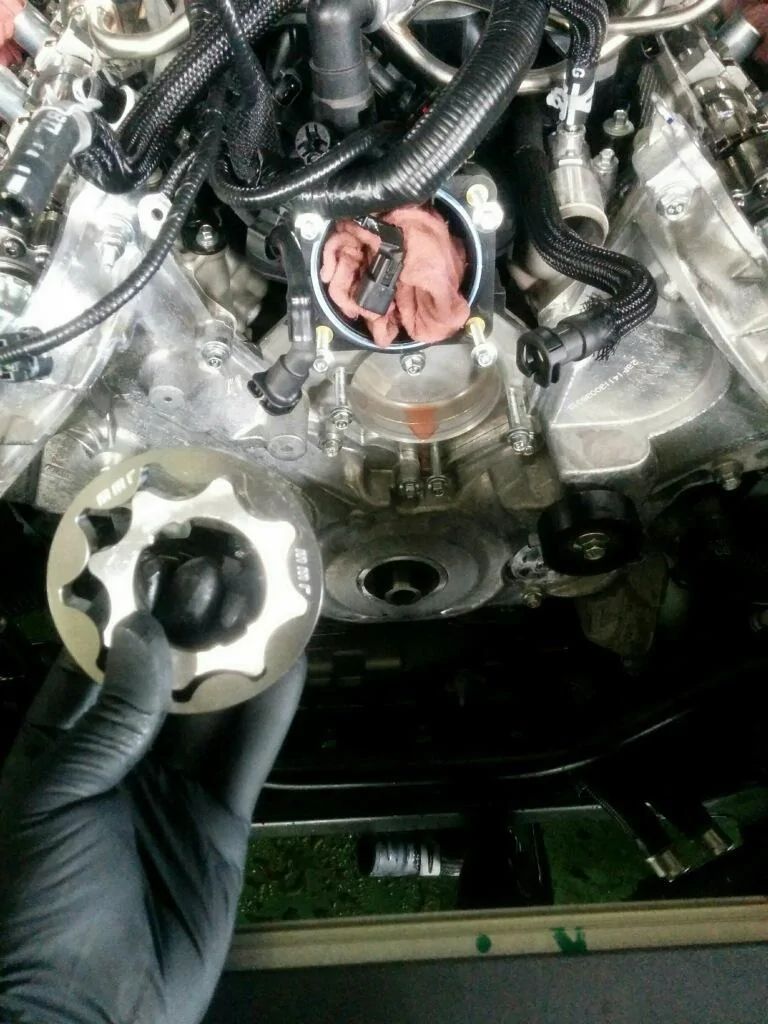

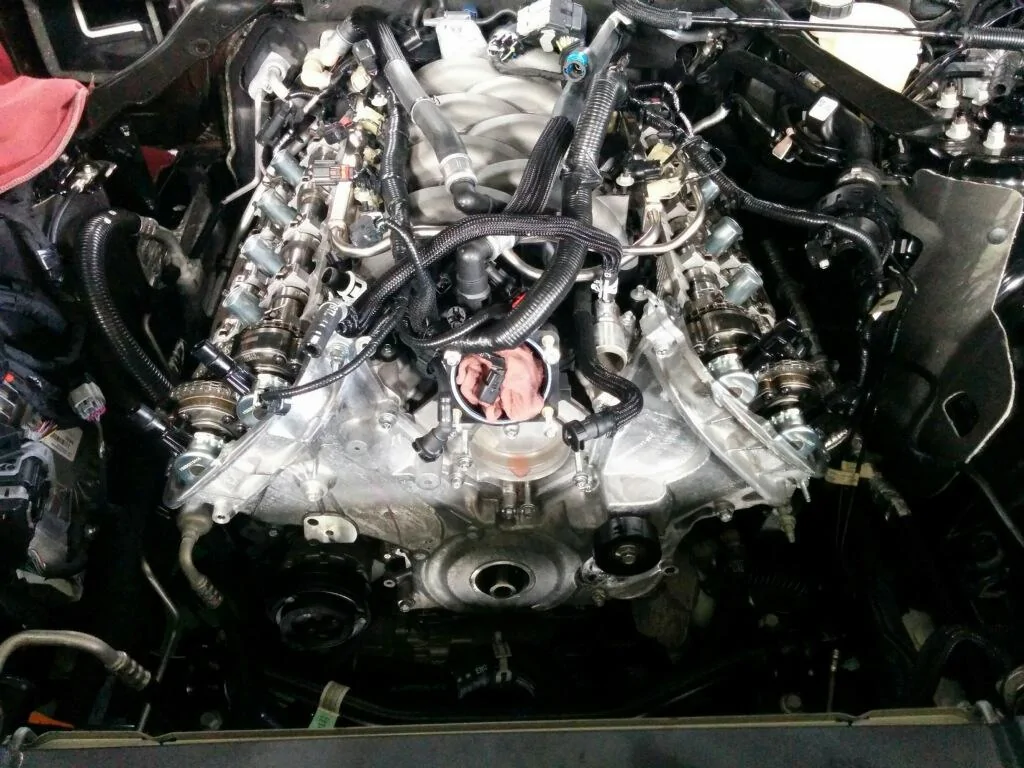

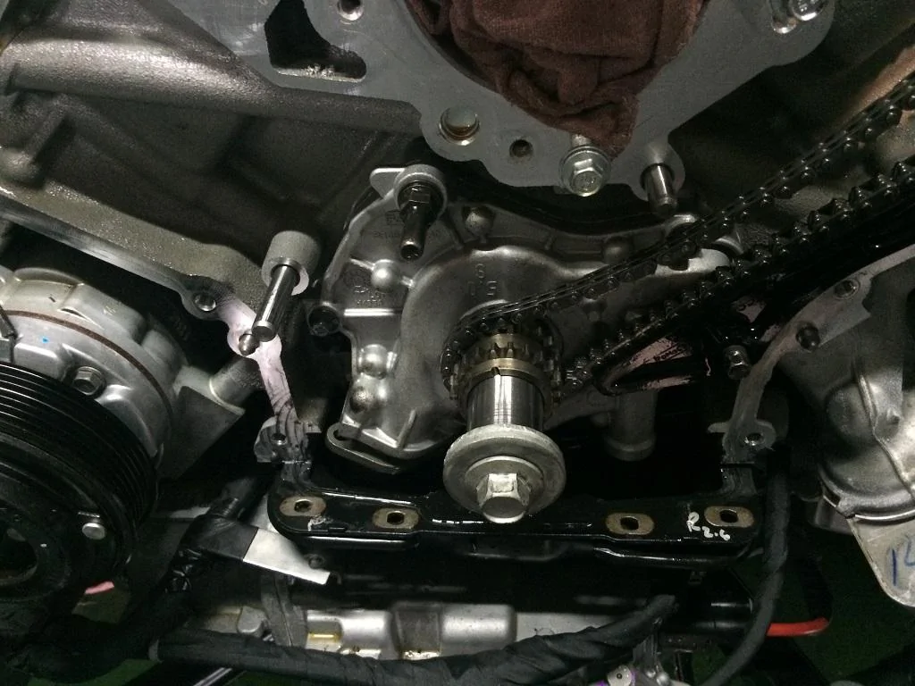

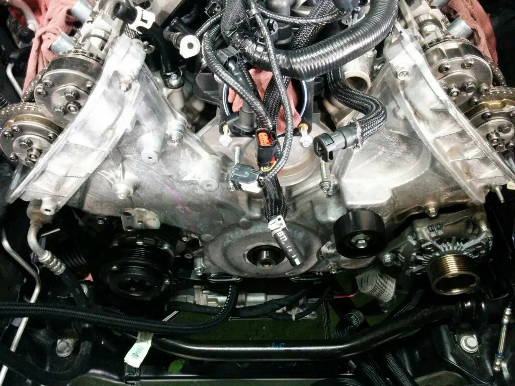

oil pump gear took a full 8 hours and it was a bit involved but it was my first one that I have changed
lol I wish sprite would sponsor or maybe Team Beef Cake would :cheers:

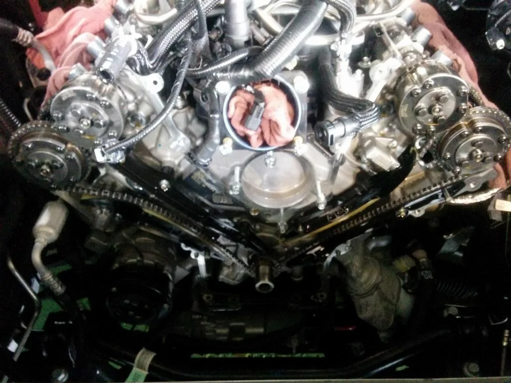

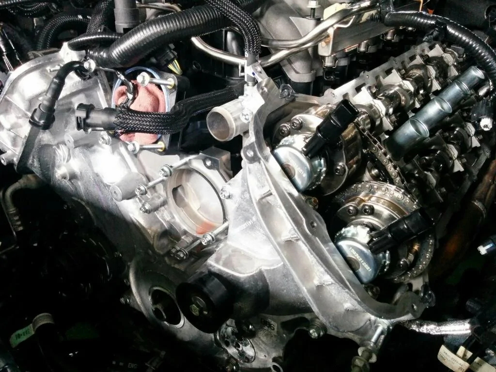

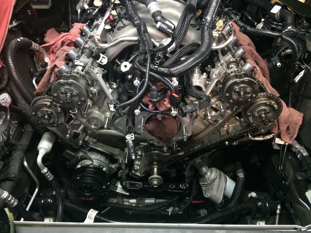

Any gotchas with the gears? I'm thinking about doing them myself. Just curious what I'm in for. Any special tools?
The gears install for someone that has a lot of patience and is very anal during the process mark each bolt and torque each one correctly also remember the timing chains spots and take lots of pictures during the process to remember how everything went

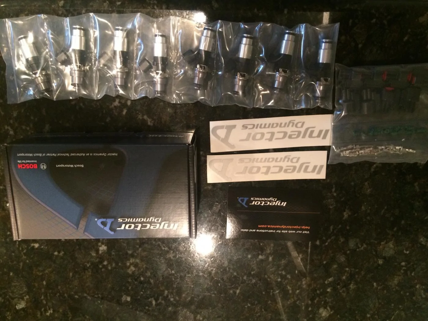

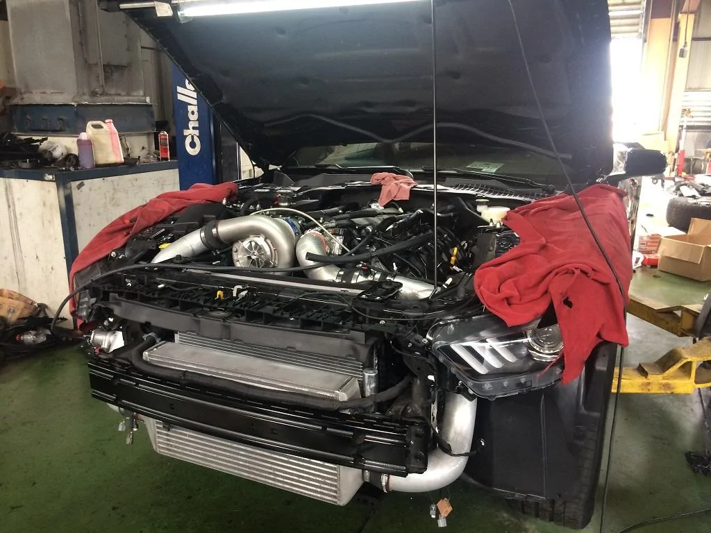

So I went all out and purchased a beefcake fuel system
Then added a 8 rib 3.47 pulley
E85 refill
Here are the results
I got a couple boost leaks to fix then Iam going in for some more dyno time
Thanks to terry aka beefcake and Jon Jr over at Lund racing
