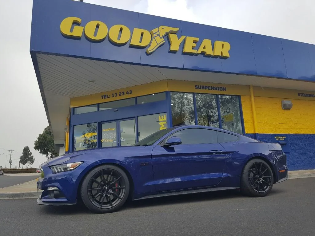

They didn't come with bump stops, I am running the Vogtland Sport
