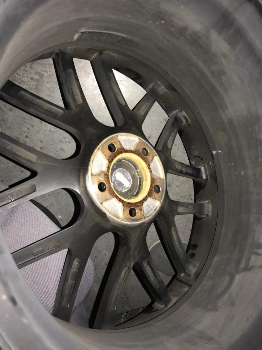

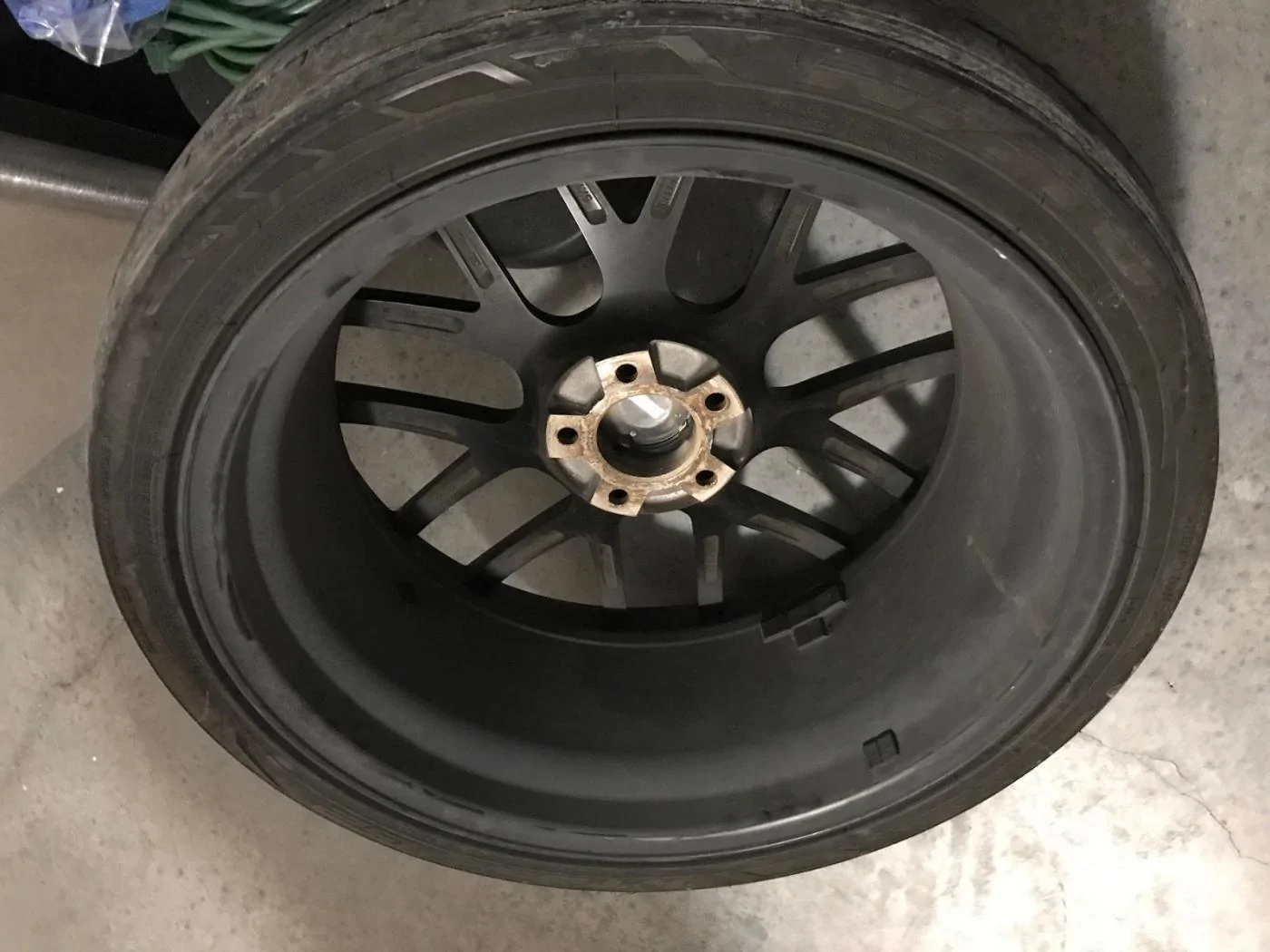

attached two pics they have groves for the spacers front ones have close to half an inch in clearance (0.468 mil) and rears have a little over a quarter (.265 mil) first pic is the rears second one is the front
Thanks, Danny. 1/2 inch in the front might work. I just need to find out the length of the OEM studs so I can calculate out much of the OEM studs will stick out past the 15mm and 20mm spacers. If they stick out less than 1/2 inch, I think the spacers will work with Velgen VMB7s. :cheers:
