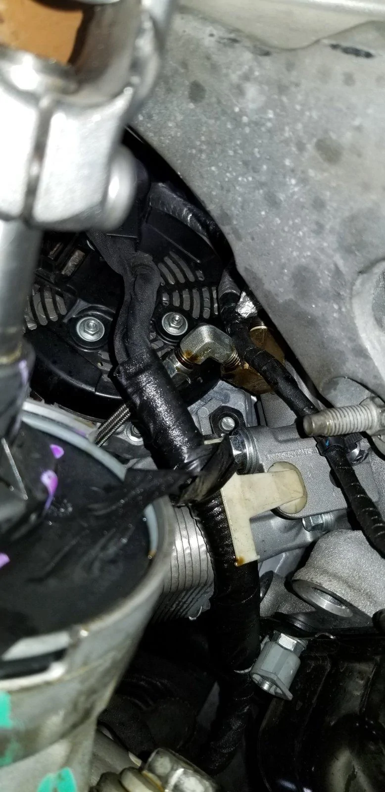

Noticed a small puddle of oil underneath the car today. I took a picture of the line where the oil is leaking but I can't trace the line because there's so much stuff in the way. I know they had to drill a hole in my oil pan because the blowers use engine oil to lubricate the blower but I checked around the oil pan and its dry. In the picture is this same line that goes directly to the head unit of the blower? Do these lines normally come loose? And if that line goes to the head unit, where does the line from the oil pan go? Thanks

The line that goes to oil pan is a return non pressurized the line In your pic looks like the pressure feed line that is T’d at the oil pressure sending unit check to see if it’s loose depending of where it’s leaking might have to undo it to tighten the t fittings
