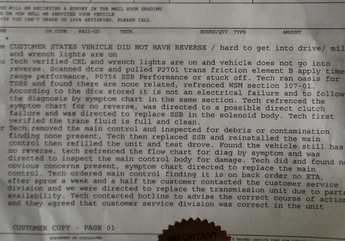

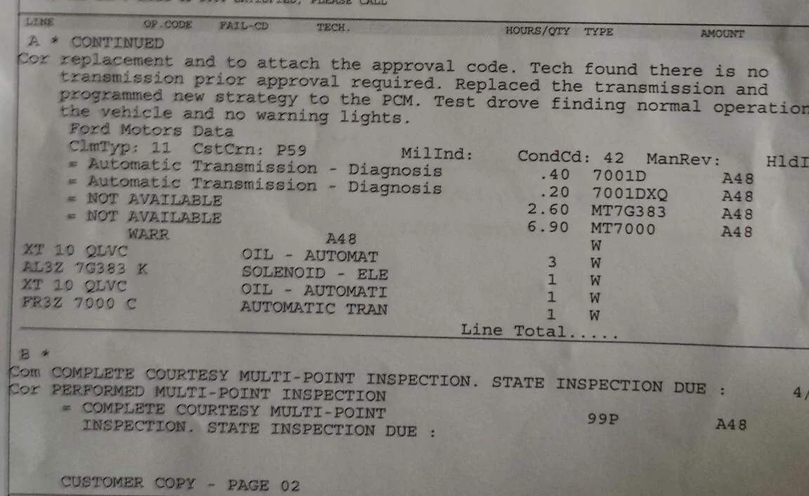

Geez, it would be nice if he spaced that write up out some.

Reporting a transmission problem from down here in Australia -
Had my new GT auto Mustang for 3 weeks and driven only 380 kms in it before it would not move in Drive or Reverse.
Found that car could be driven, after a push, very very slowly.
Thought it was in Limp Home Mode, but dealership said problem is possibly the torque converter and/or pump.
Service Dept is going to examine all parts and send photos to Ford engineers.
Waiting on outcome.
