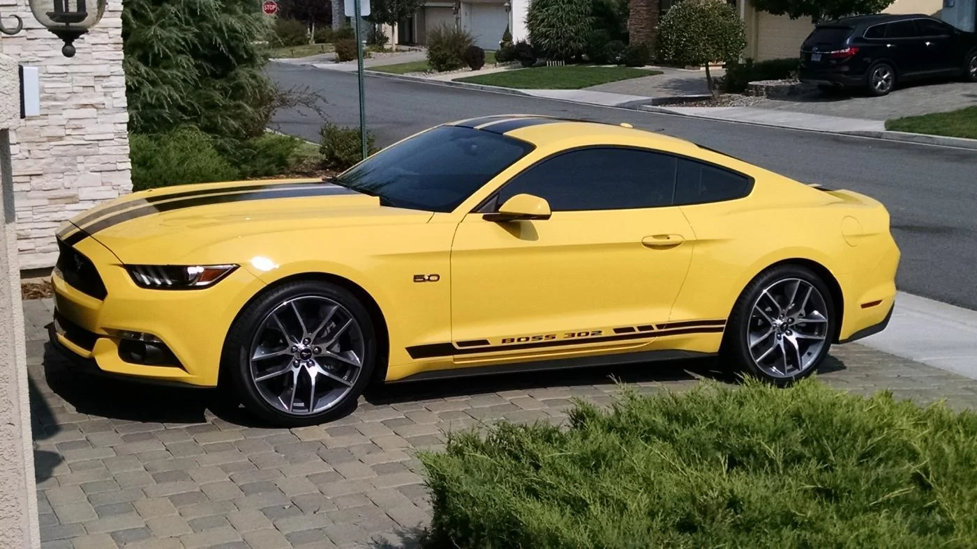

Hi, just bought a set of foundry wheels without tires.....
They are very rare here in Europe.
I seems that 265/35/20 is the stock setup?
Unfortunately this size is very exotic and expensive here....
Do you guys have pictures of these wheels with 255 or 275 tires so I can decide for alternatives.
Thank you!!

Out of curiosity, what did you have to pay for the 20's? To your request, here's a shot with 275/35/20 on all 4 corners.
