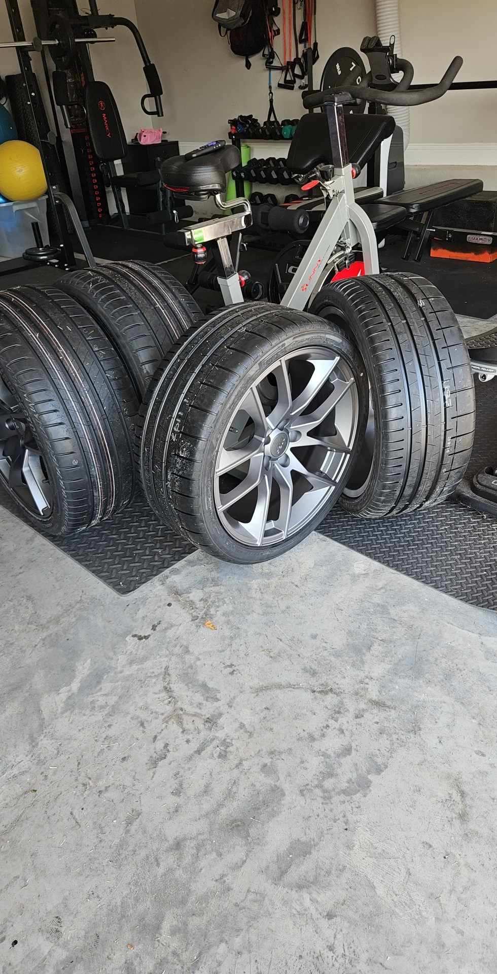

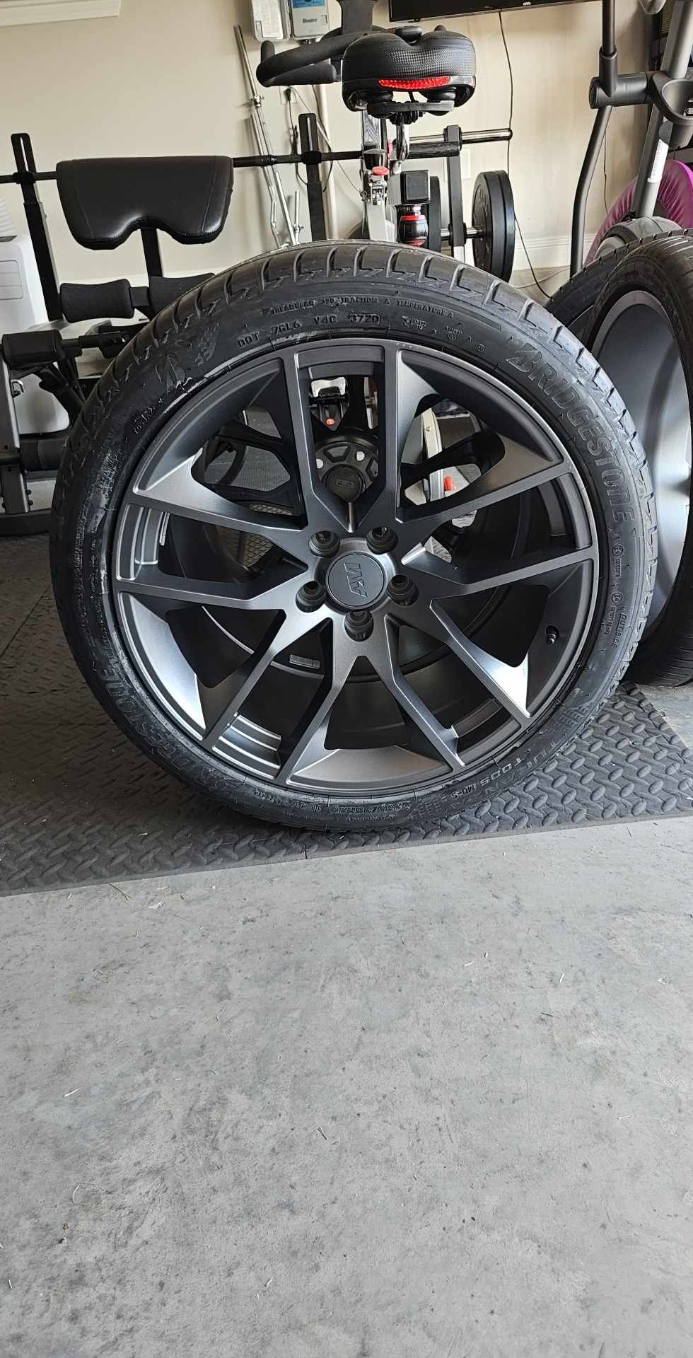

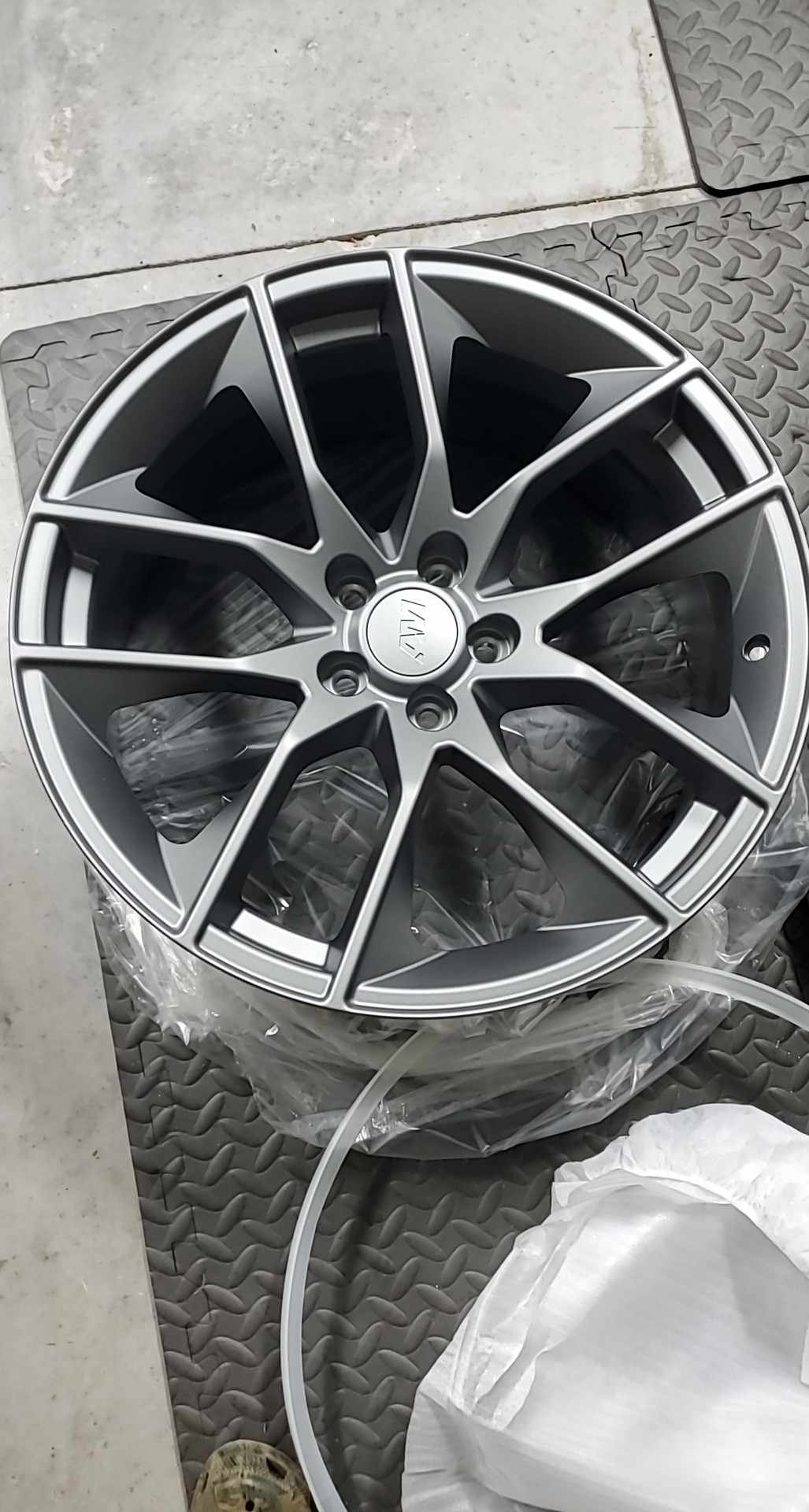

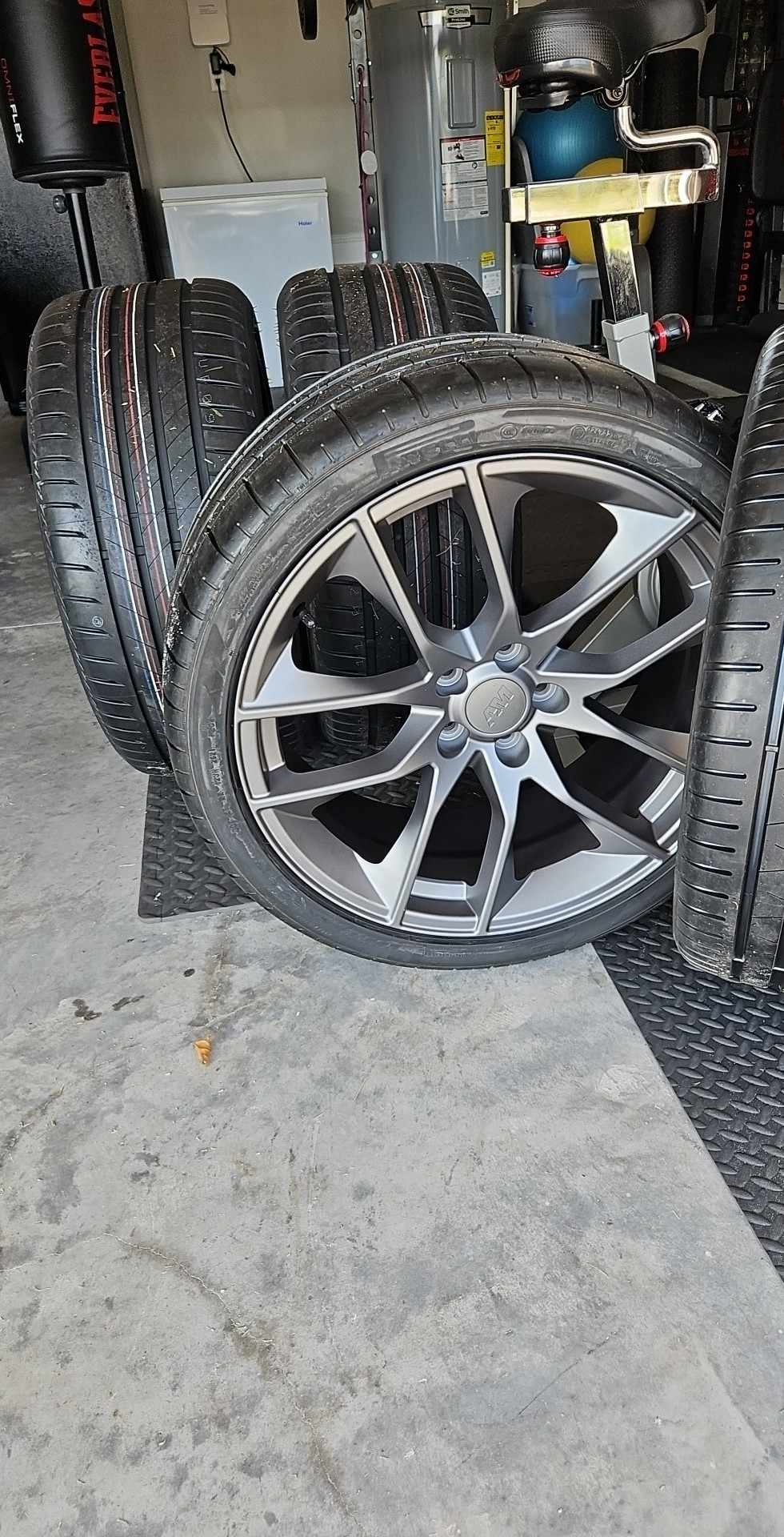

Just got AM Magnetic charcoal wheels. Front is 20x8.5 offset 30mm & rear 20x10 offset 48mm. AM recommended 255 35 for front & 305 35 for rear. On Steeda non adjustable pro action struts/shocks/linear 1 inch springs with 1/4 spacer.

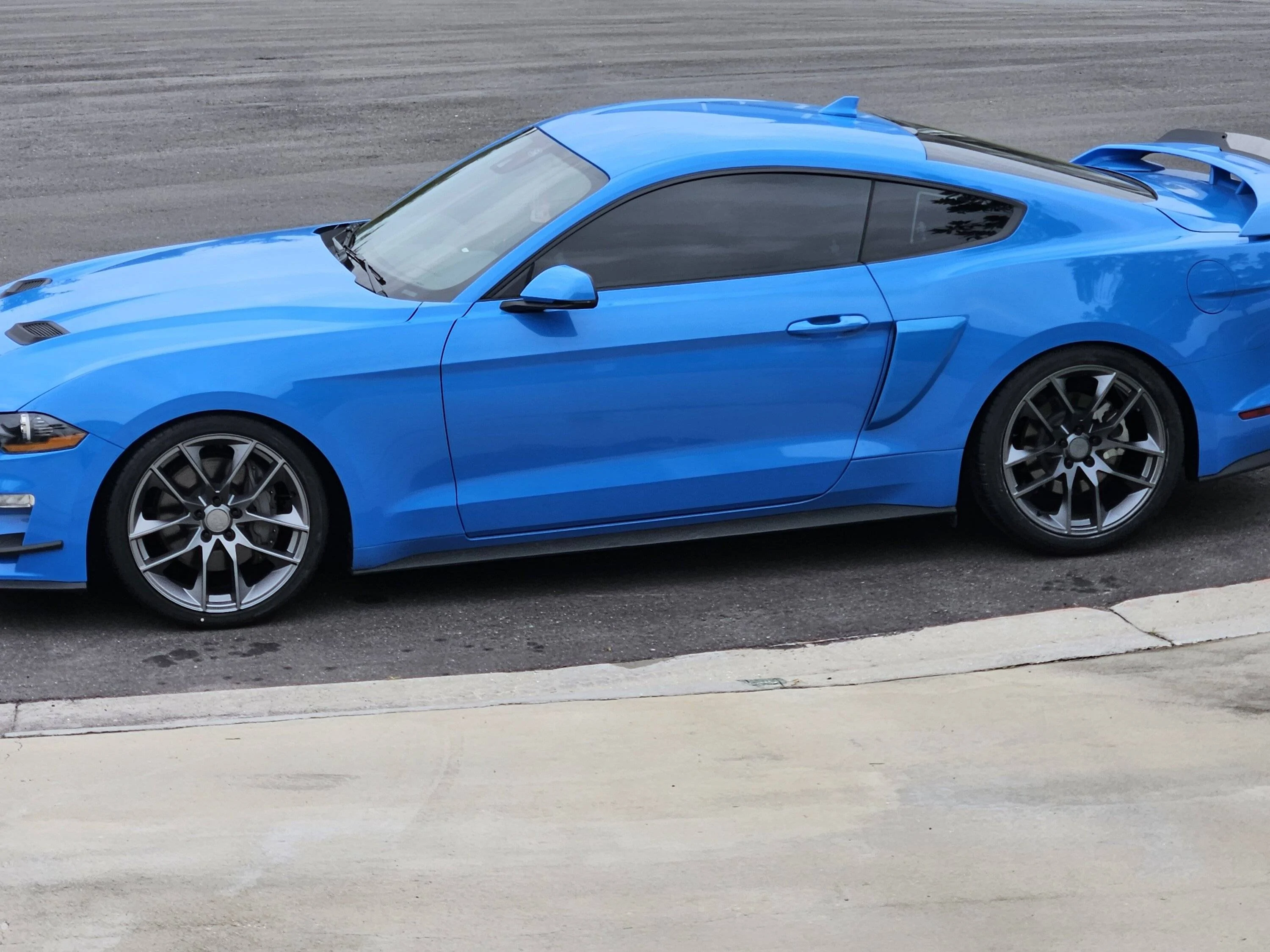

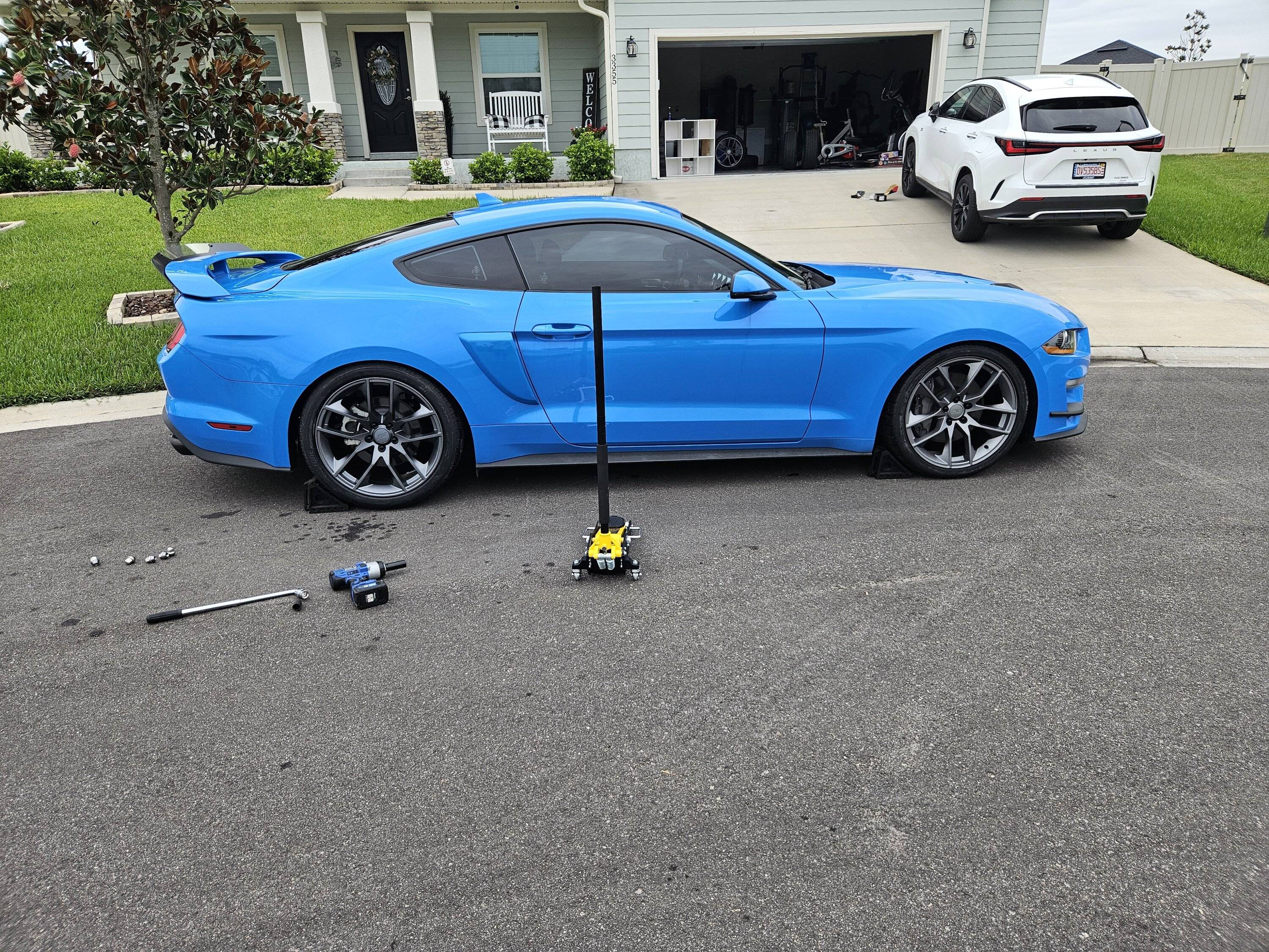

Good weather finally as storm passed. Size & offset are perfect.
Looks nice! You got the best sizes for those wheels. Glad you upgraded the lug nuts, too.
