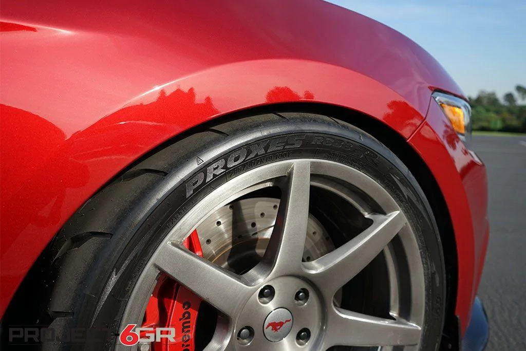

Will 19X9.5 rims fit 295/30/19 tires?
Here is a 19x10 mounted on a 295/30/19 R888R tire for reference
Hope that helps, if you have any other questions, feel free to contact us, we are here to help and share over 15 years of experience.

Since the wheel is only 9.5" wide it will only allow for you to use a certain amount of tire for contact patch, anymore then that is just extra meat in a sense and buldges over the wheel. You can get away with it, but here is the thing its track you said so there are extremes the tires will go through, when you overbuldge the tire rolls.
This is overbuldge
Now you can use a 275/35/19 or a 285/35/19 all around on a 9.5" and track your fine, if your going to use that 11" then the 295 on that is fine.
