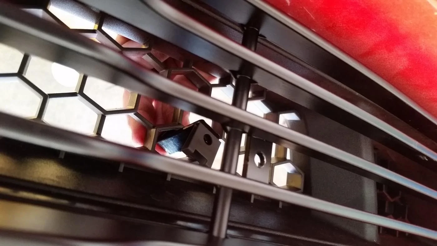

I have them - got the top grille on fine, the bottom one - it is either not designed well or is not designed to work with the non ACC bottom grille. Or at least it does not work with my lower grill on performance pack GT. It covers the stock lower grill and comes with two small j-hooks that are supposed to "attach to the honeycomb" to keep the grille on. Well maybe it works with ACC lower grill, but my grille honeycomb is way too far back to reach, and the t-rex grille itself does not fit inside the stock grill, due to size it covers it up - so there is no way it can work as designed. Pretty pissed off since I have my bumper off and the cheap upper part of the bumper sides was so thin most of the connecting tabs detached with very little effort - have the wife at walmart getting some extra long zip ties to see if I can rig up some way to make the grille hooks reach.

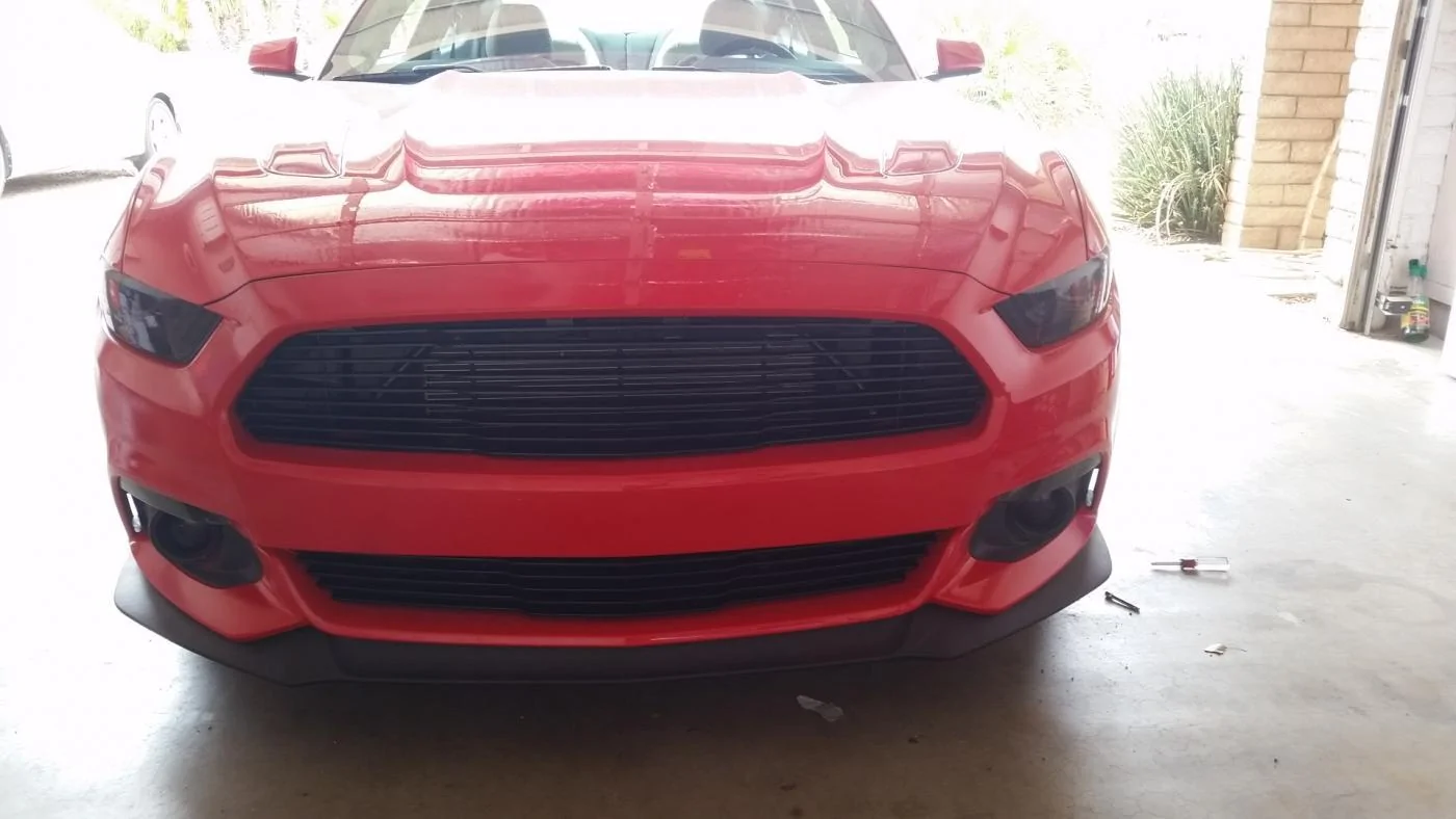

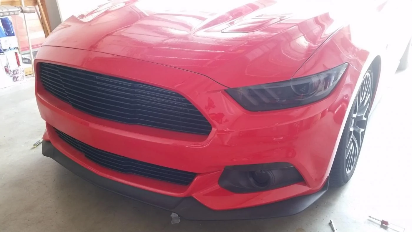

here are two picks plus one of the wayyy too short/ill designed hardware.
but looks great once installed. getting tons of compliments.
to install the bottom grille I used like 16 black 11 inch zip ties

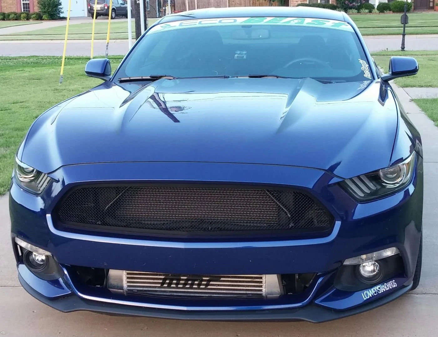

Upper mesh
