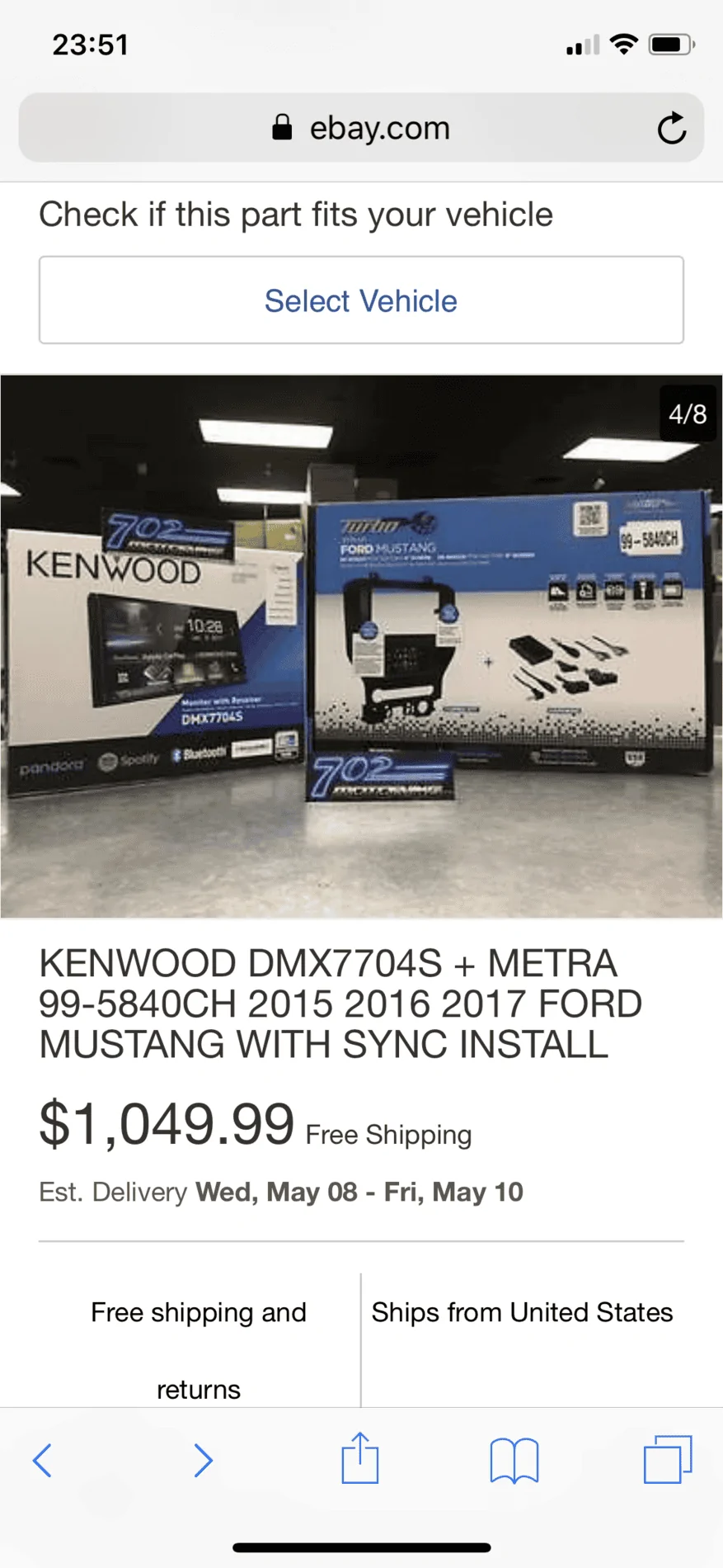

hello, I have a 2015 premium GT and previous owner swapped out the sync 2. I’m looking to get it back but what would I need?
Haha sorry they swapped in a kenwood radio unit and metra climate control unitWe need to know what “swapped out the Sync 2” means to help. Did they swap an aftermarket unit? If so, what model? Swap in a microwave, coffee pot, vending machine?
I’m fairly confident it’s this exact setupHaha sorry they swapped in a kenwood radio unit and metra climate control unit
