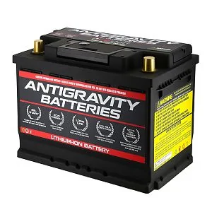

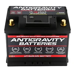

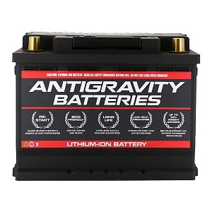

HI all,
I was just about to post about this exact issue regarding Battery Dimensions and fitment in the Mustangs and specifically the GT350s. So this is great to find this post.
We are a new site sponsor and sell lightweight Lithium-Ion Batteries... I'll give you an example below. We just came our with our Automotive OEM sized lithium Batteries....
So here's my questions. Can anybody confirm if the H5/Group47 battery will fit into the existing GT350 battery tray and fit with the cover? As explained above by the H5/Group47 battery is 5/8th inch taller than the 67R battery. But we also know that the 67R is the same physical size as the 96R which is also know as the T5 (in Euro terms). So while the 67R=96R=T5 in terms of sizes.... they are all actually 5/8" inch lower than the H5 battery, but the exact same in Length and Width. So height is the only concern.
So with that being said.... can anybody confirm absolutely that they can fit the battery cover over the H5/Group47 if they have done this change? And was there any issues?
Any assistance would be appreciated. We really want to confirm this as our new battery comes in sometime next week.
Also for those interested.... Here is what our Lithium Batteries are about...
Below is the new battery and here is the link to read about it.
https://shop.antigravitybatteries.com/products/starter-batteries/automotive/ag-h5-rs/
So this new line of RE-START Batteries is a dedicated Automotive Batteries, not like some other smaller Lithium Batteries that some use. They are available in the most popular OEM Automotive Battery Sizes to fit most any Performance, or Passenger Vehicles on the Road. Additionally they have our RE-START built in Jump Starting that can Wirelessly activated.... so in essence you would never be stranded with a dead battery... no matter where you are and if the battery drains you just press the provided Keyfob to access the built-in jump starting and start the car.
Another Cool Feature is that we are making them in different Amp Hour Capacities. Most of these new batteries will have a 24Ah, 30Ah or 40Ah option. So you can choose what works best for your application. For example if your into the biggest weight reduction then our 24Ah in the H5/Group47 size weighs 8.5lbs.... on the other hand if you want something with alot of extra capacity you can opt for the 40Ah version which weighs 15lbs.. but is better for a Car driven in freezing weather, and where you have alot of extra accesories. We have a 30Ah model also that splits the difference but those are about another month or so later as they are still in production.
Below are some pictures...
