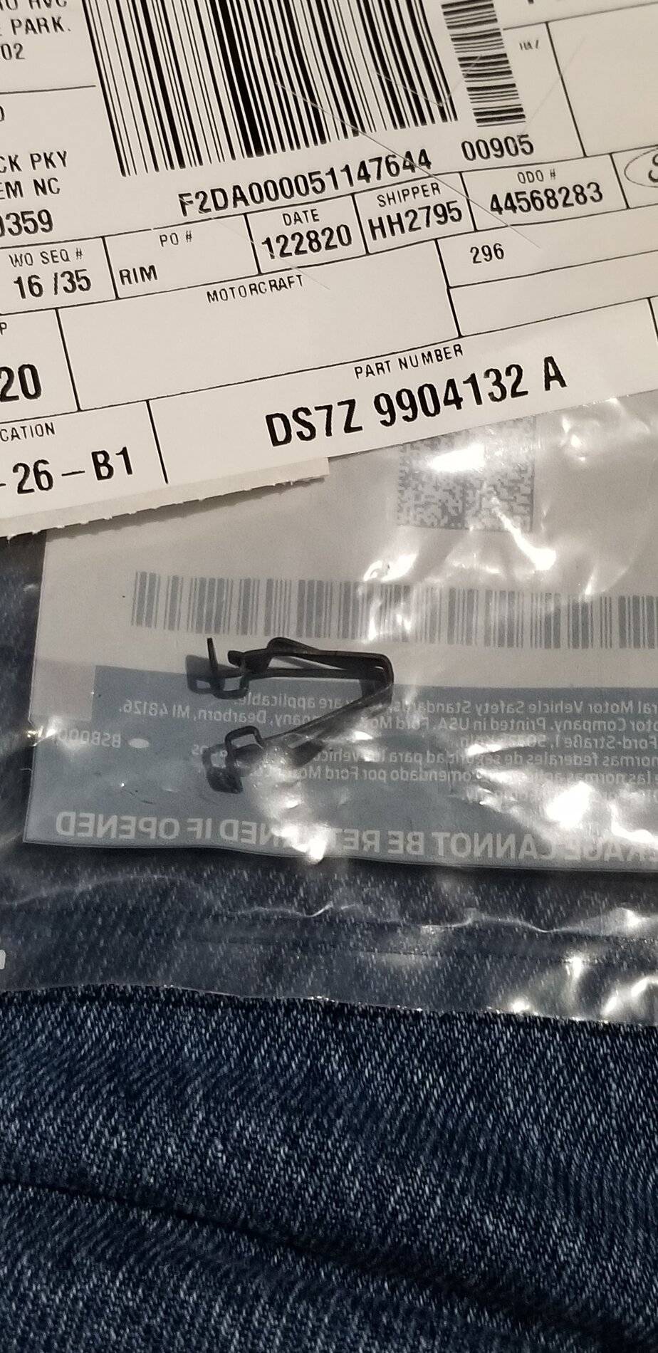

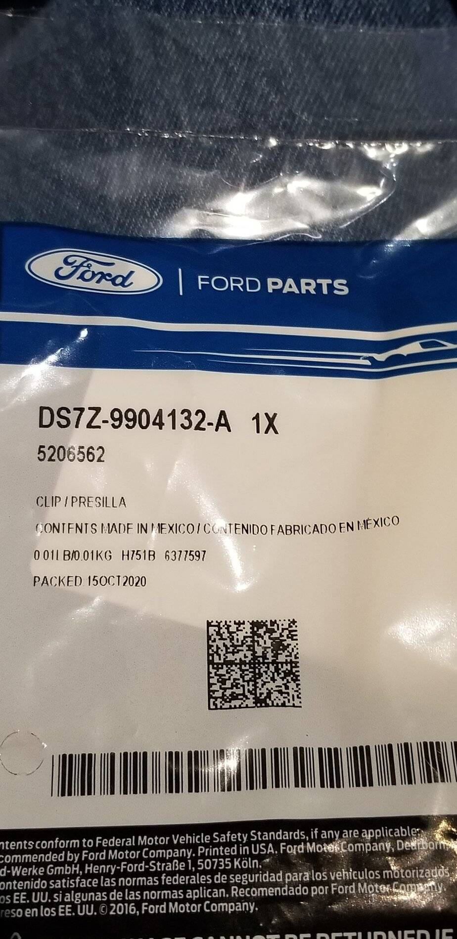

Resurrecting an old thread -- because I didn't find much information about this clips for the visor anywhere and a search brought me here.
I had to replace the visor on the driver side in my 2017. The mirror light and homelink quit working. Not a tough job (not sure why the you tube video I found it took the guy 2 hours to pop the little cover off). The metal clip is something I would advise just going ahead and buying one because it is very easy to break it like the OP did and I did.
This is the part number from Ford in the picture. The GM clip is about twice as wide and won't fit. And Ford dealer locally charged $5,27 for the clip (a pair of the GM clips was $4 at O'Reilly).
