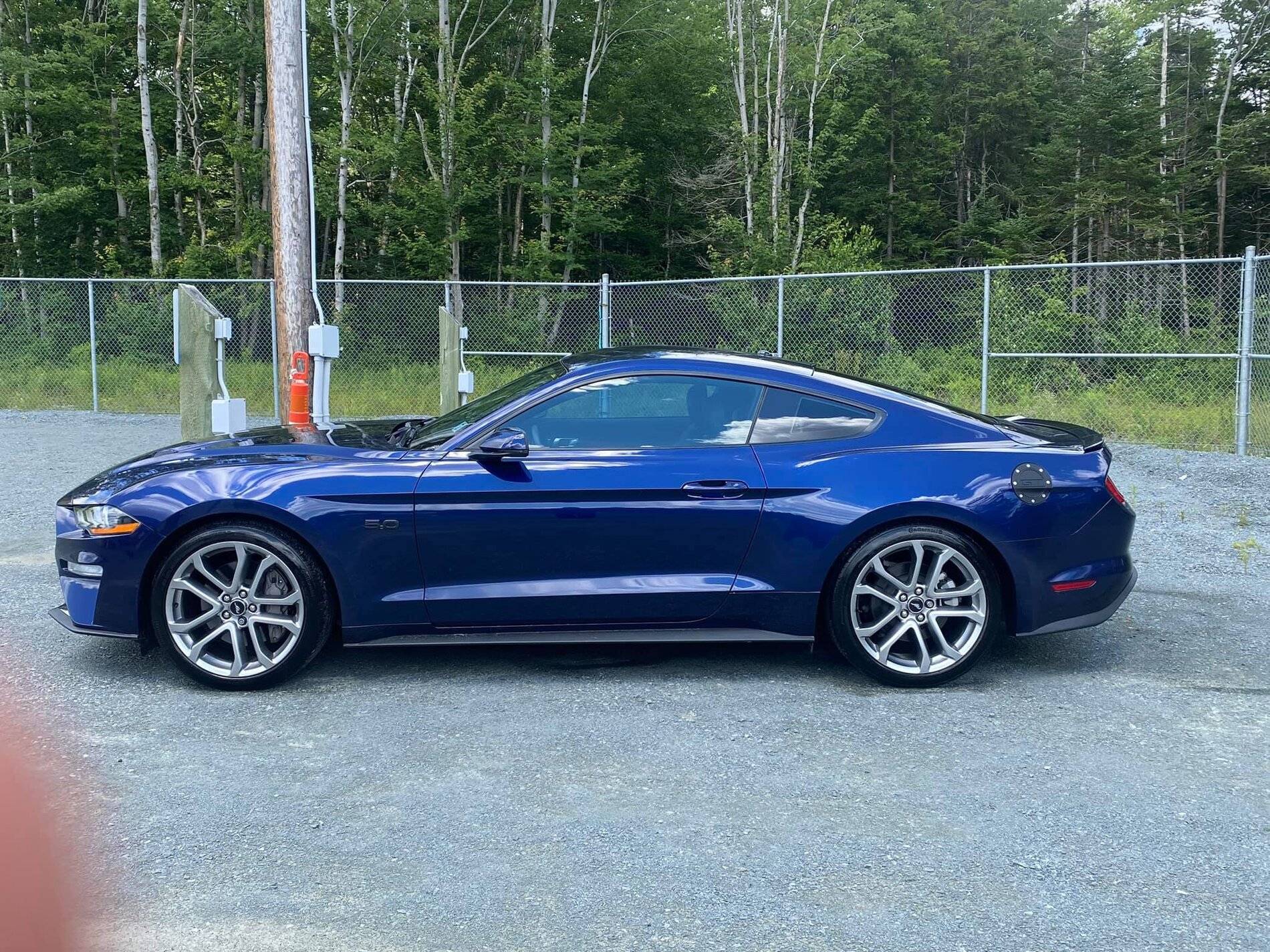

hey guys got a 2019 gt premium and want to lower the car just got my steeda sport progressive springs.now want to get the irs subframe spacers kit too.but will i need camber bolts for the front.Also will get it alignment done after i get springs in.Just want to know if i need anything else for the front .thanks dave

HI Dave,
We strongly recommend the Steeda Camber plates upfront when you install the Steeda springs.
The OE Front mounts are NOT adjustable for camber and when you lower a Mustang it induces excessive negative camber in the front of the car with no way to get rid of it. The camber bolts are an okay option but the camber plates are strong & more robust.
Our Steeda Camber plates allow you to get the camber right back to the -1.0 degrees setting that is recommended.
