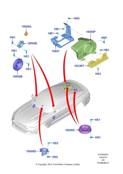

Those speakers in the parcel shelf look like they belong in a clock radio, the magnets are tiny. I remember having a look at them when I was mucking around with the spare wheel. I think that will be a good starting point, upgrade them first and see how that goes. I don't want to fit a sub if I can avoid it, and a couple of decent speakers up the back may make enough difference.
I agree they suck, but the ridiculously tiny magnet would mean it's a neodymium magnet. They just do magnet stuff a lot better than the traditional ferrite type. It would of been interesting to hear if the standard stuff sounded any better with just the amp upgraded before I swapped out all the speakers.
