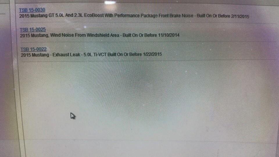

UPDATE: so ford looked at today and said it must b something to do with my aftermarket exaust and i need to take it where i got it installed. ... hopefully they werent just saying that to get me out of the service center. only looked at it for like 30 min...i wonder what the chances are of a rock or something getting into my exhaust system.
