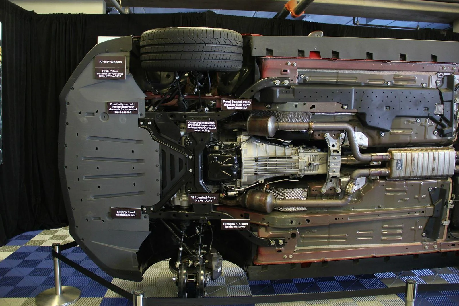

See where the two ball joints are on the bottom wheel. And notice how flat the hat portion of the brake rotor is. Then try to see that in the upper wheel. It is all deep inside the wheel not for show but for performance and handling.
You don't have to take my word for it read about the suspension Ford copied when BMW introduced this geometry on their car. They didn't invent it Porsche and most everyone else does it as well. Deep dish wheels cannot be made to do the same thing.
Cool Picture...Thanks for sharing it! :cheers:

I saw this at SEMA a couple of years ago and did not know what I was looking at. Thanks.
