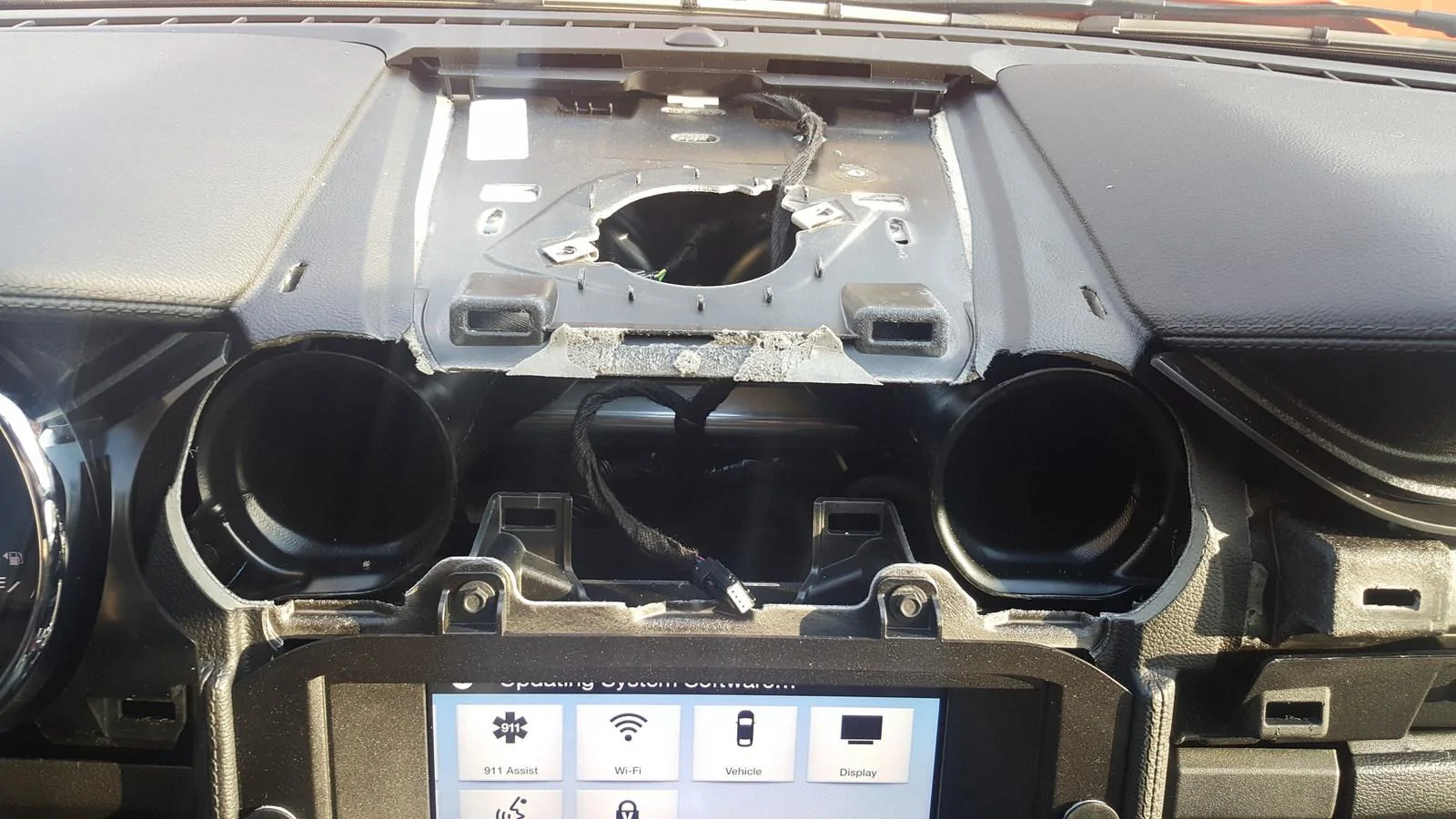

Chef jpd
Apr 1, 2016
63
2,989
3,121
Brooklyn, NY
John
Pull off the center dash cover,
See the connector in the center of this picture? That is for the PP gauges.
You will also need to remove the center vent tube.
20161215_092540 by chefjpd, on Flickr

ronemca
Sep 7, 2016
38
499
77
ON Cda
Ron
2016 P/EB w PP
Pull off the center dash cover, <snip text + pic>
Excellent pic, Sir! It's definitely worth a thousand words! :cheers:
Is that photo from a car that has the gauge pack?
Chef jpd
Apr 1, 2016
63
2,989
3,121
Brooklyn, NY
John
Yes, from a PP ecoboost.
