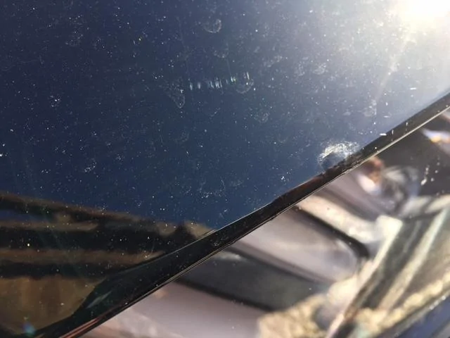

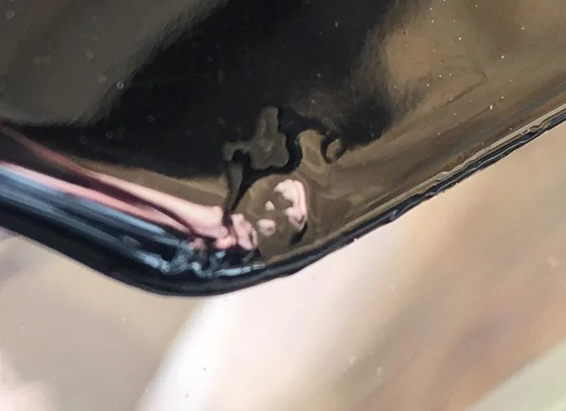

Not great images (taken on phone), but....
Drivers side
Passenger side
