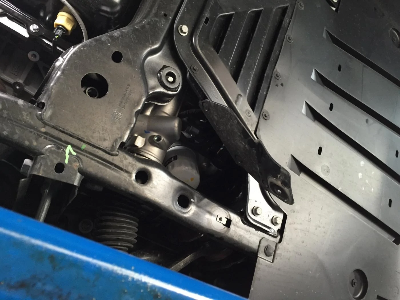

By the looks of that picture I'm betting that changing the filter is going to be a messy job.

Scary to me is a dealer tech couldn't figure out the filter was behind that little flap. Took me about 1 min on my back under the thing on ramps to figure it out.
Know my PP GT says 5w 20 on the cap. It wasn't what went in it, though. That is one hell of a thin oil.
I also used cardboard placed under the filter to keep the runoff oil from making a mess and running into and all over the tray.
