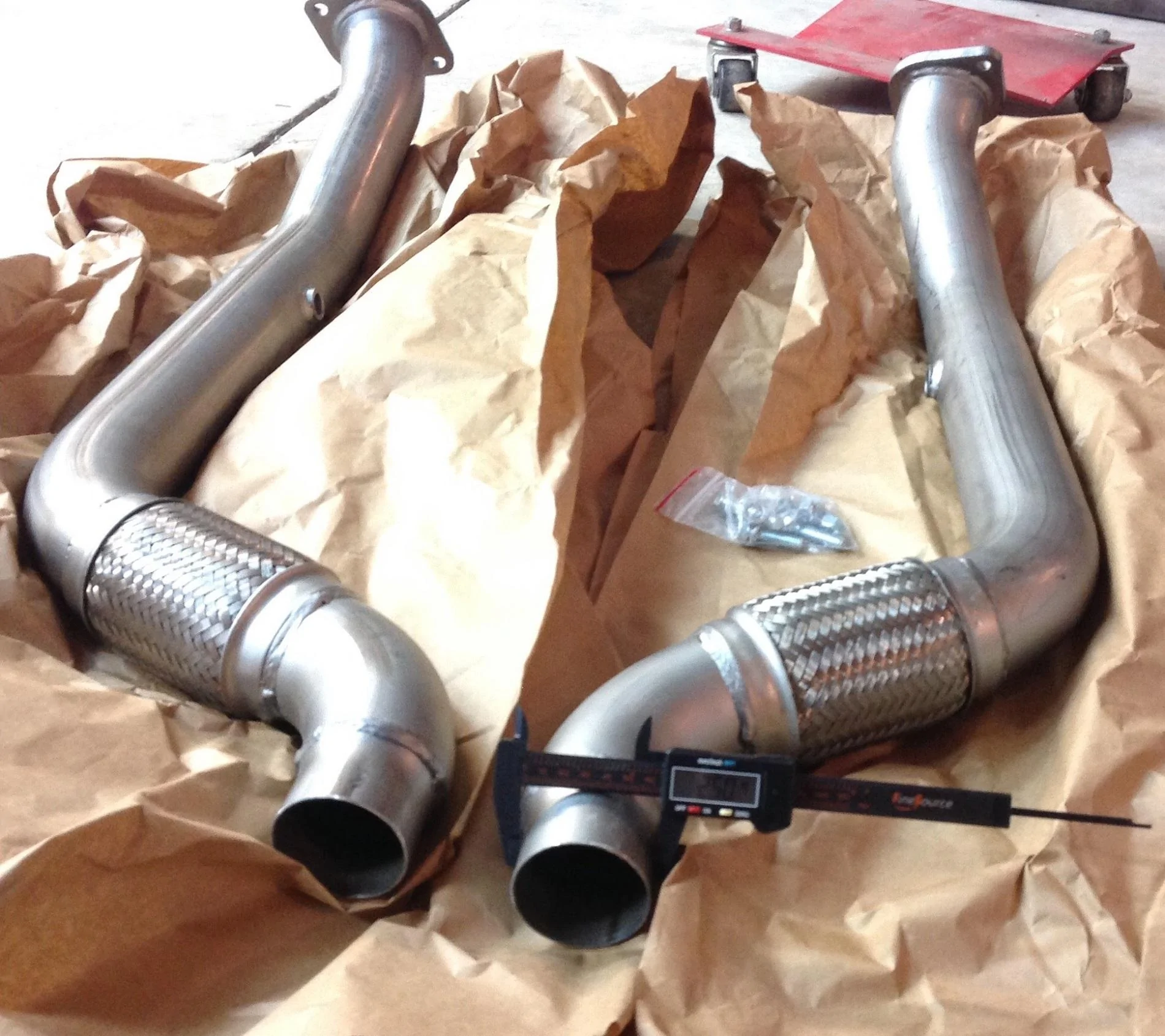

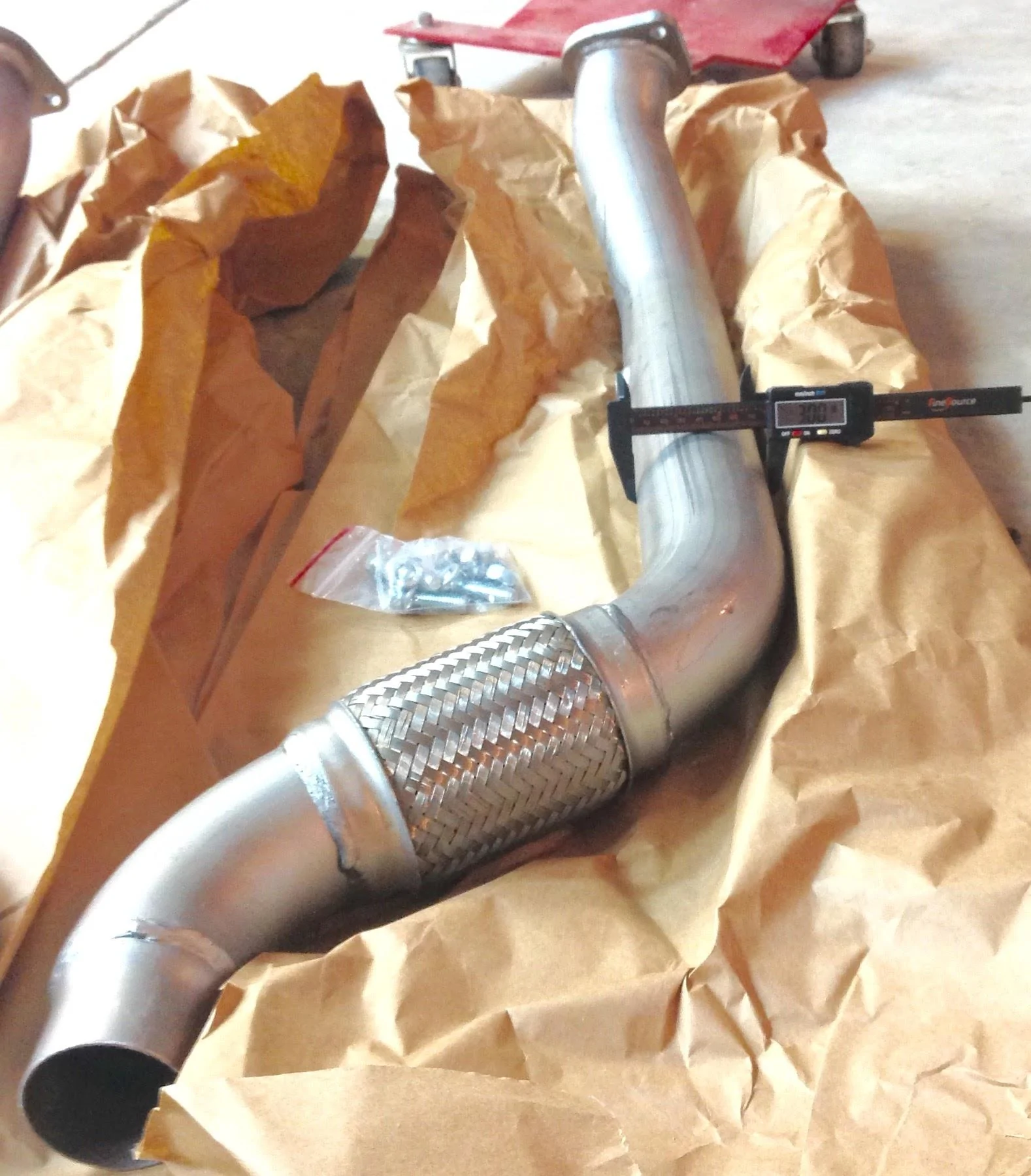

I recently completed the install of Lethal Performance's off road mid-pipes on my GT350 without tuning the car or throwing any codes. I used the second version that comes with a flex section. My goal was to make it louder and maintain the factory warranty. Below is a review and summary of the install process.
The stainless tubes were true to size. They measured 3" and transitioned down to 2.5". The welds looked like they we're MIG'd and painted over. Over all they looked very good.

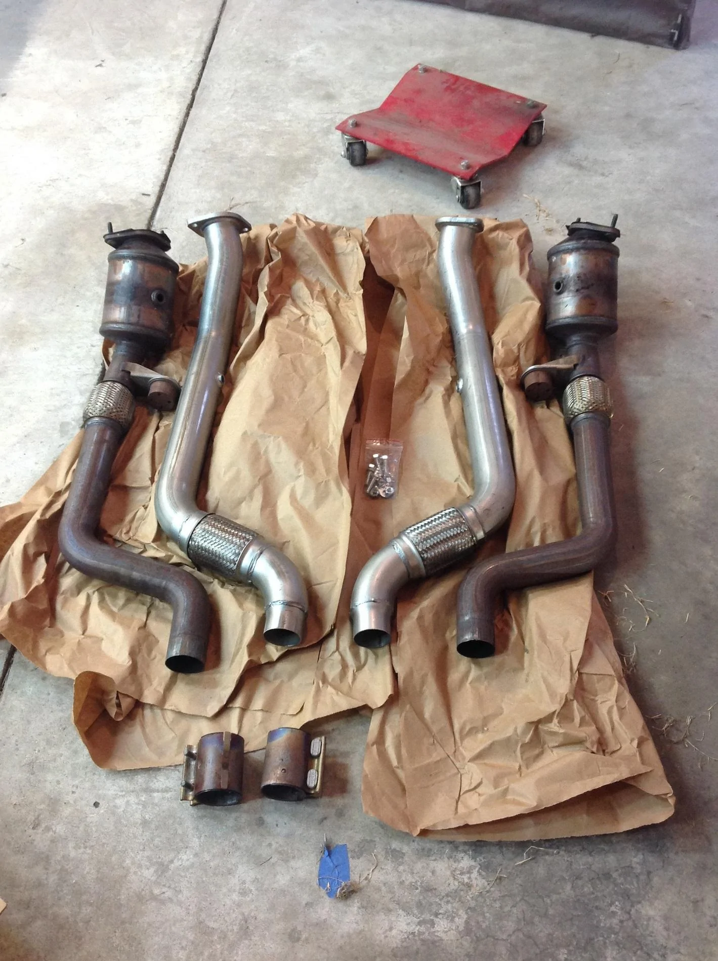

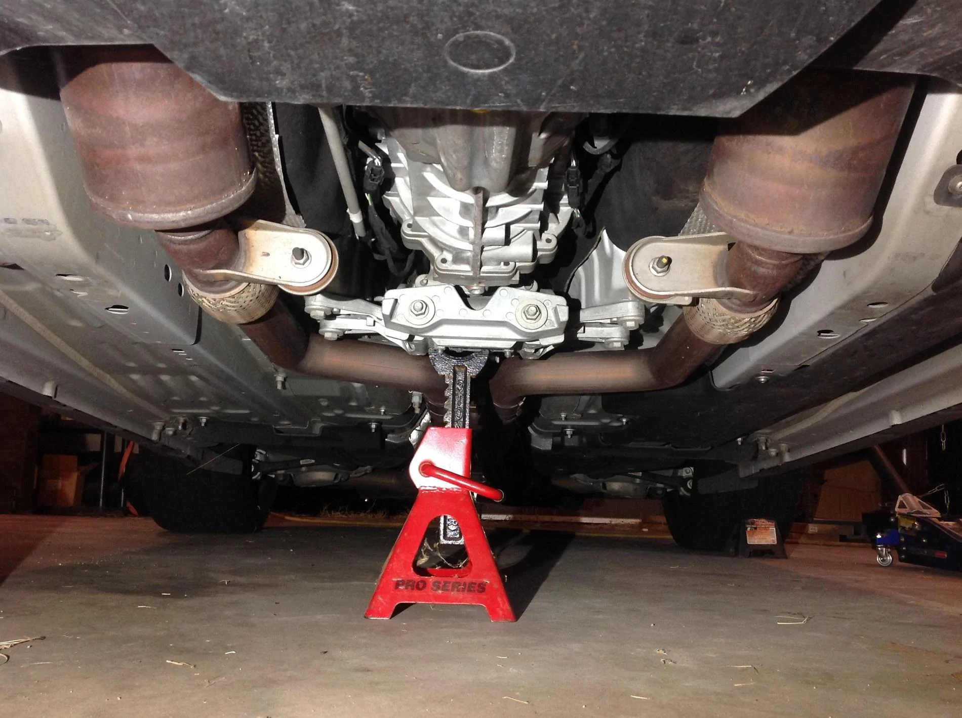

The factory exhaust before removal.

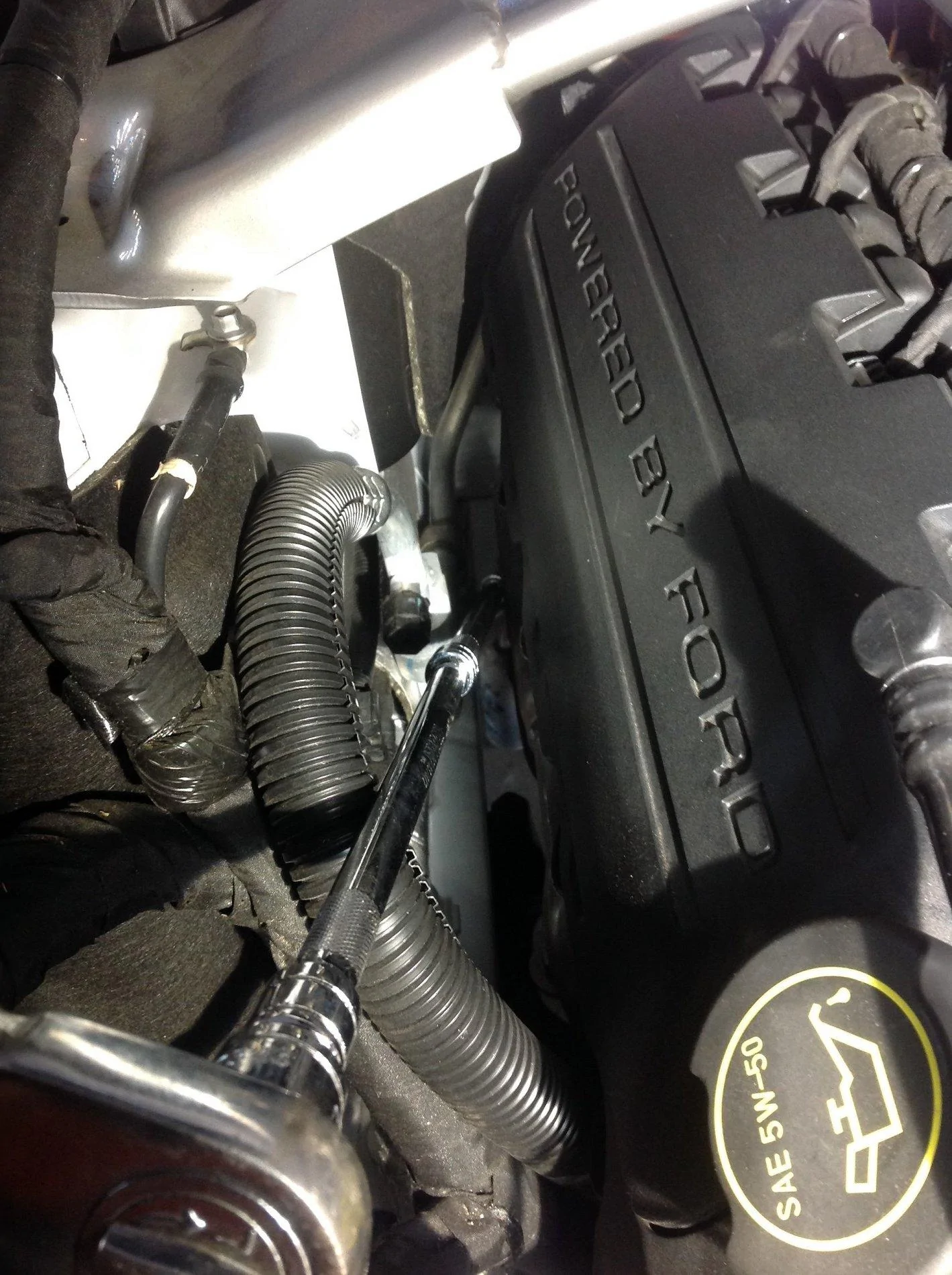

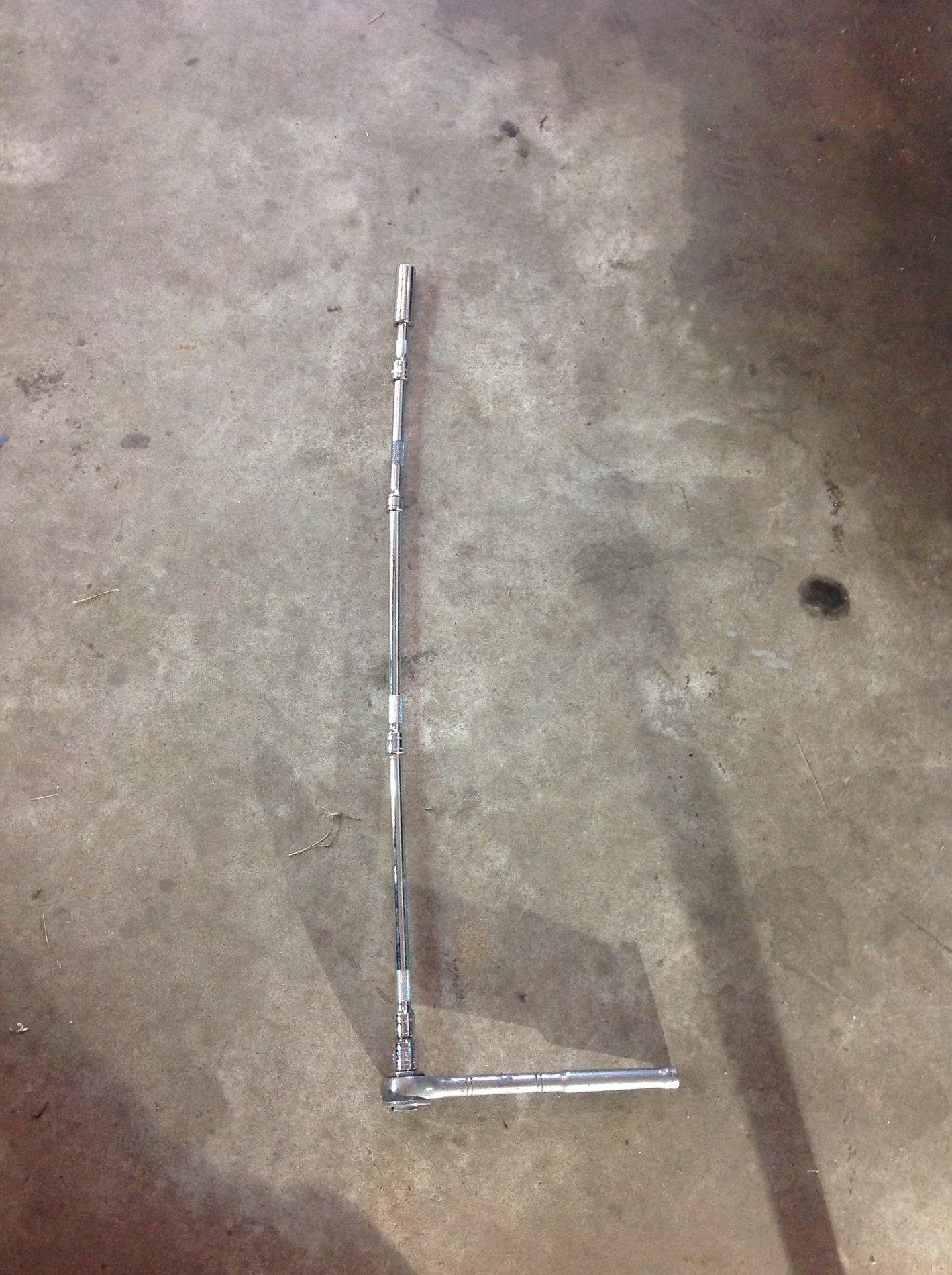

The factory exhaust bolts were very tight and hard to get to. I had to remove both front tires. The hardest bolt was the upper passenger. I got at it from the top of the engine bay.

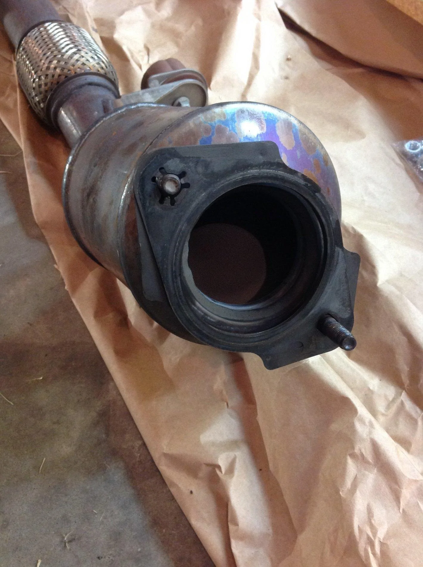

Lethal's next to the factory cats.
Don't forget to remove, clean, and reuse the factory steel gaskets.

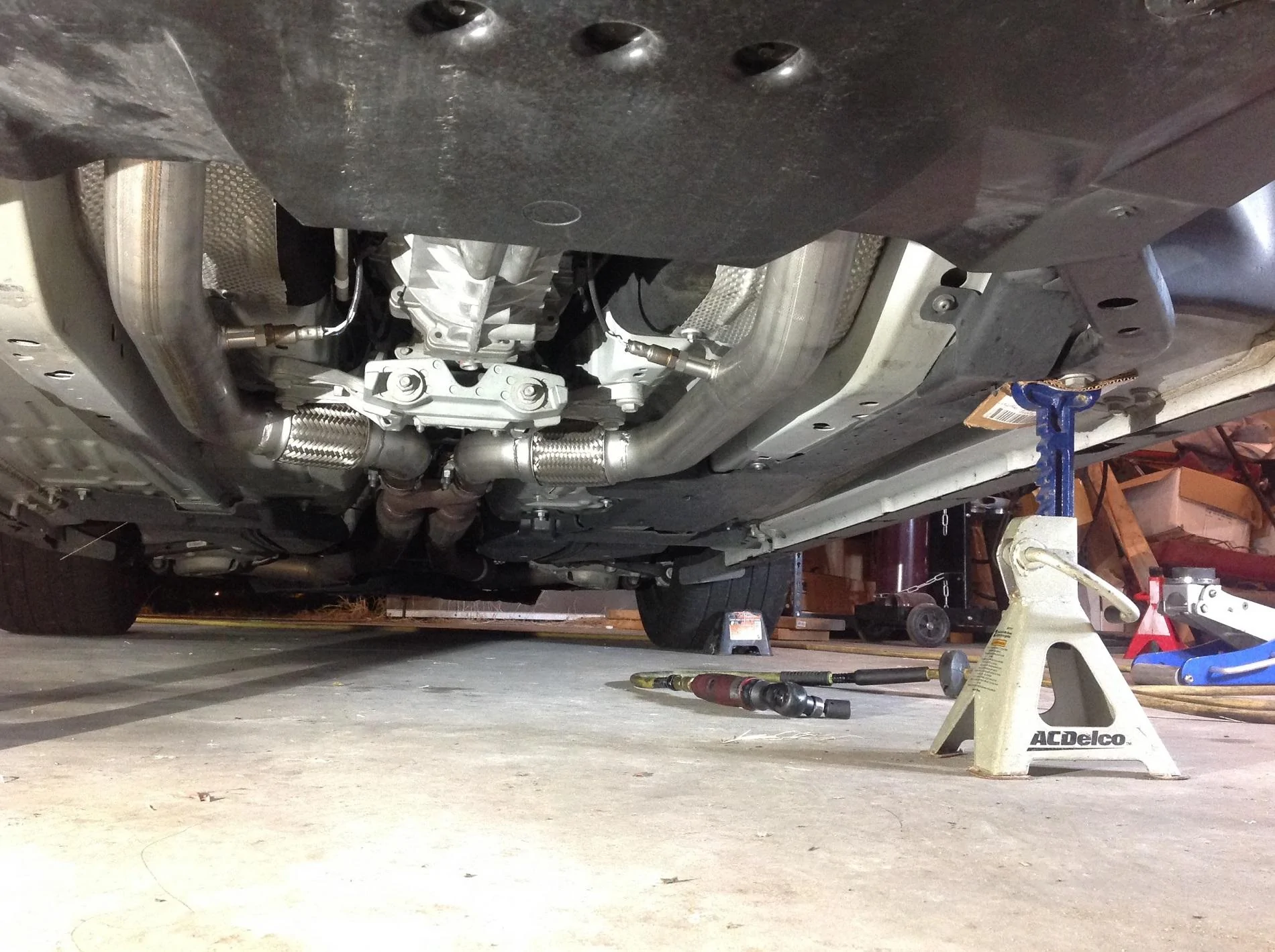

The completed install. I used ARP thread lube on all the bolts and torqued the flange bolts to 15ft-lbs then to 37ft-lbs. The X-Pipe section was torqued to 35ft-lbs.
The O2 extensions are from Vibrant Performance P#11621. I used the smallest orifice when they were assembled. Loctite copper anti-seize was used on the O2 threads and the O2 extension threads.

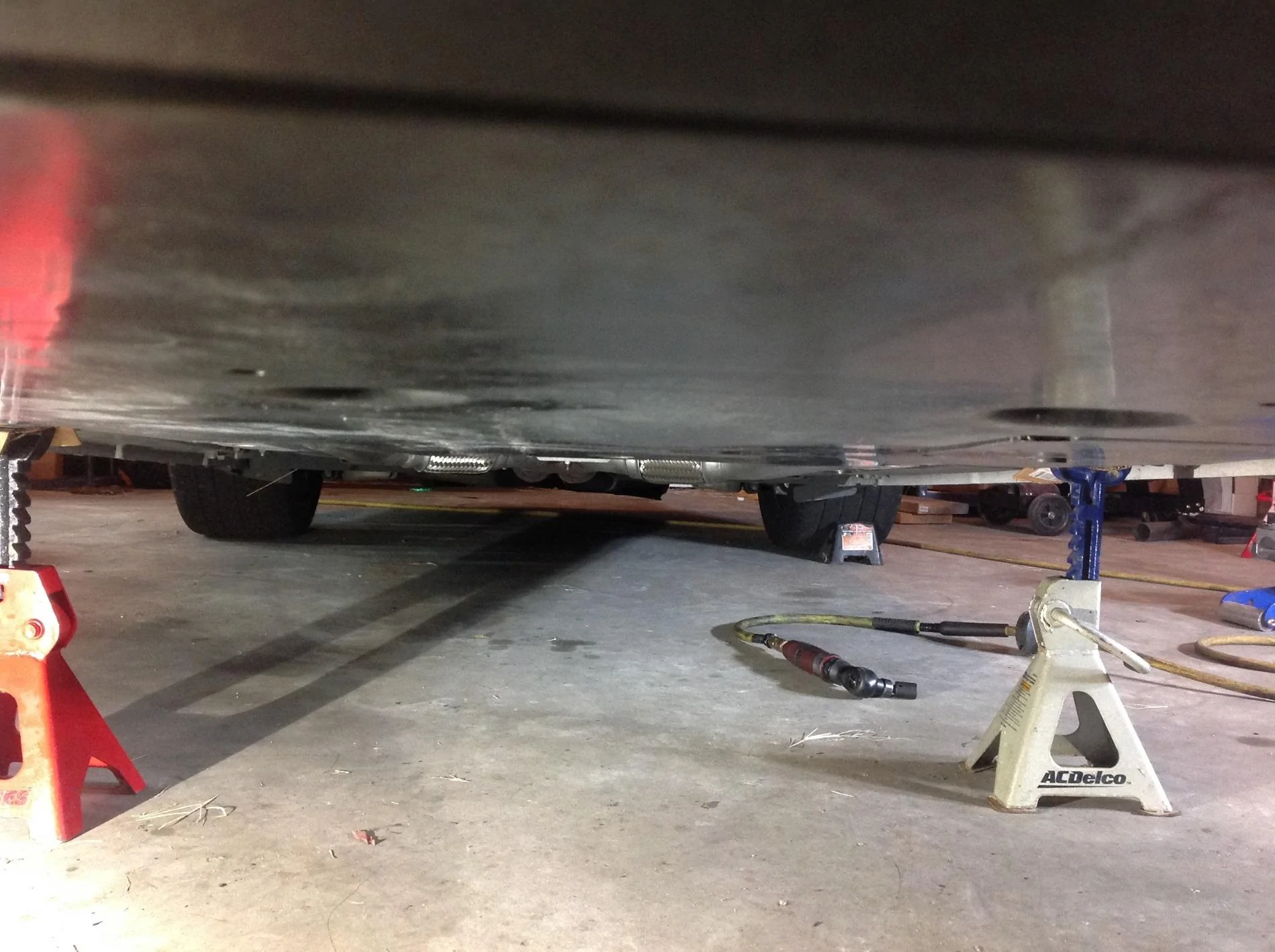

No noticeable ground clearance was lost.
