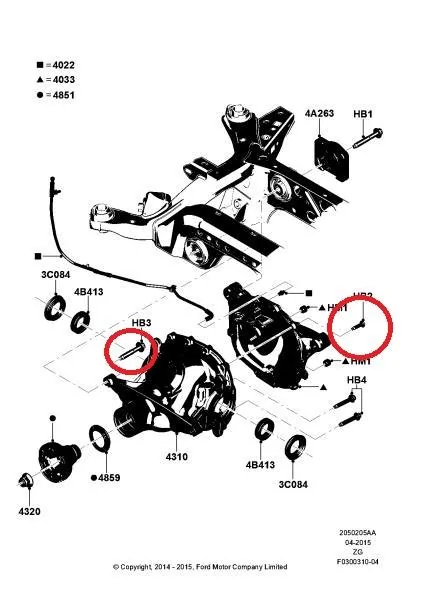

I snapped my Steeda bolts on the 555-4439 for my diff bushings.
Apparently its a wide spread issue with aftermarket bushing INSERTS that they cause the bolt to snap.
Im trying to find OEM bolts to go back to stock as it was suggesting I forego inserts and either run OEM diff mounts OR get complete Aluminum solid mounts for the diff instead of INSERTS.
So im trying to located these bolts high lighted in red. (Attached)

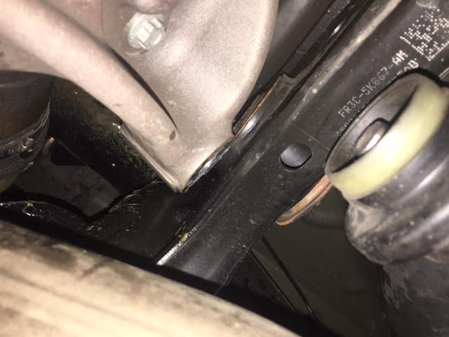

Also have pics of it on what broke on the car, half of the bolt is still in the diff housing.
Can you tell me the P/N and how much they would cost?
Thank you.

HB3 is part number W716983-S439
HB2 is part number W716811-S439
I don't have these in stock :(. Ford does have these in the National warehouse & available to us in a few days. I could put them on a quicker order and have these here Tuesday at the earliest.
I checked the locator, and not too many people seem to have these in stock. Send me a PM or give me a call Monday if you'd like to get an order going. Your local dealer should be able to order them as well, but they may have you purchase these in a package quantity (4 ea)

Hoping for some help, do the longer oem bolts go in the front or rear of the diff?

The longer bolts go towards the front of the car- closest to the pinion.
