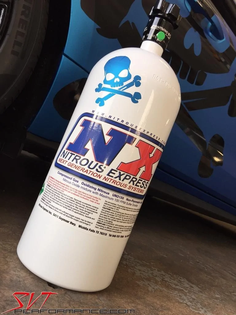

I've been running the Nitrous Express GT-350 plate kit on my 2016 Mustang GT Premium (Auto)

Nitrous Express GT-350 plate kit (jetted for 100 HP)
