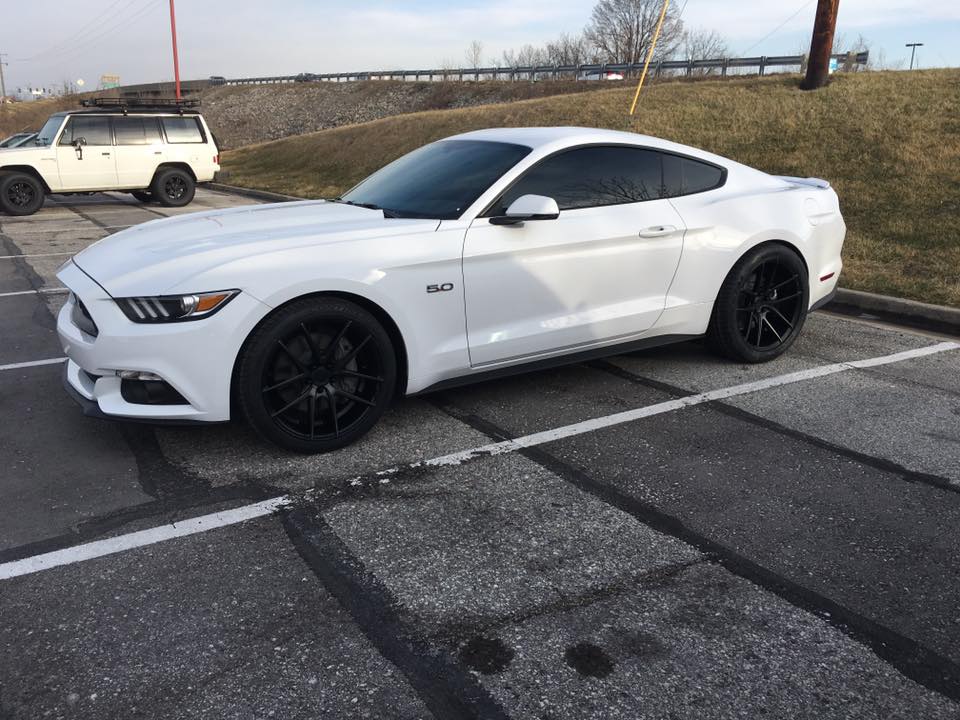

stang1971
Feb 2, 2016
522
186
kcmo
2018 Premium Plus Magnetic GT
Niche Targa 20x10 up front...20x10.5 in back
257/315 combo
tamboRL
Mar 5, 2016
79
Erie
16 GT PP
257/315 combo
wow nice stance. the 20 x 10 fronts would not cause rubbing even if you are lowered?

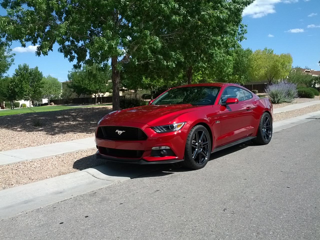

mdnt
Sep 14, 2014
205
52
Albuquerque
15GT/PP RubyRed
i use 305s mickys in rear on 20x10s look fine, 275 on 20x9 in front
