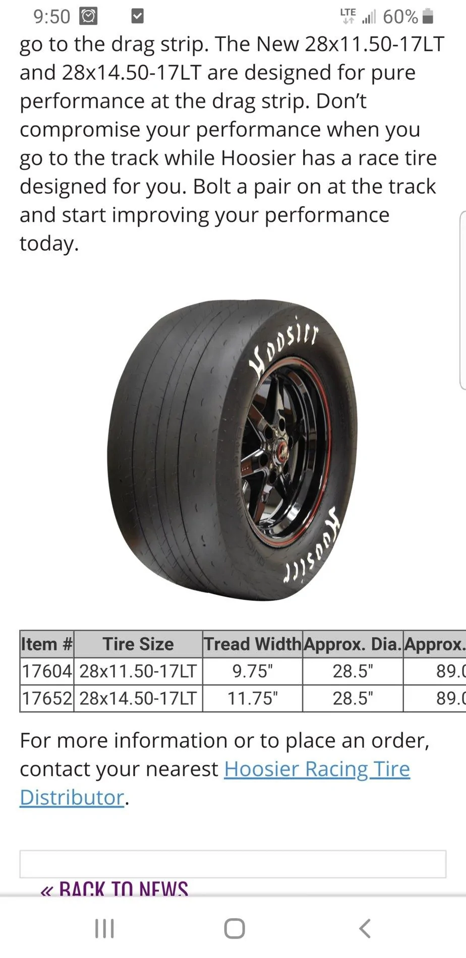

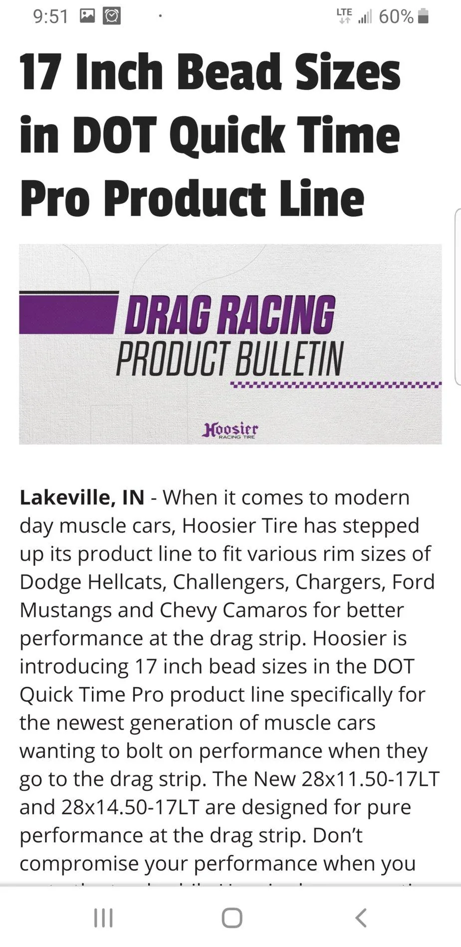

Has anyone run these yet? I was getting ready to switch to the mt bias ply street r's but I just saw these came out. I love how my Hoosier slicks hook but I'm looking for something more stable now that I will be faster and shifting into 5th. Also I like the fact that there DOT.

I talked with someone at Hoosier about these tires today. Basically he said they the same tire as the normal bias ply slick except their DOT spec and have some grooves in it. He also said that if you are getting any kind of sway to raise the air pressure, he recommended 18 psi cold for a 4k lb car. I guess I'll add some psi to the tires to make them more stable now that I'll be hitting 5th and running higher mph.
