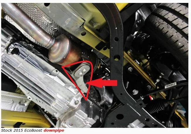

long story short when installing an aftermarket downpipe I was in a rush and had trouble on getting it aligned with the below bracket. I got frustrated (it was 95 degrees out) so I ended up cutting the part and welding it to align and now there's a rattle. So I want to replace the part and align it properly like I should've the first time but I cant find the part. I'm looking on ford parts but have had no luck, unless I've overlooked something.
Any help on tracking the part number or where I can get a replacement from would be appreciated.
***originally this was a thread asking for a part number Ford does not sell this part so i am now WTB one, see below update, mods please feel free to relocate thread if deemed necessary
* photo cred Mishimoto downpipe R&D

That bracket is VERY adjustable - its slotted on the trans side.
Loosen the two bolts that hold it to the transmission. Then line it up and tighten up the downpipe side. Next tighten up the transmission side.

UPDATE: back from the dead... so after installing my VS2 turbo I was able to realign the downpipe properly however since i modified the original bracket, now it doesn't align lol :headbonk: (bracket extends to far out) even though, as stated above, it is very adjustable it still doesn't align
all in all i just need a new bracket somebody has to have this part that they don't use due to big turbo custom exhausts etc.. for those wondering ford does NOT sell this part by itself
If you happen to have a spare please let me know ( I am willing to pay) I keep getting exhaust leaks because there is nothing mounting the downpipe to the tranny so there is a lot of movement throughout and easily loosing things
