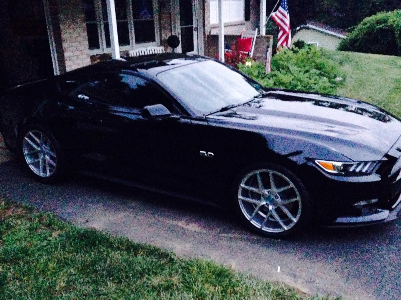

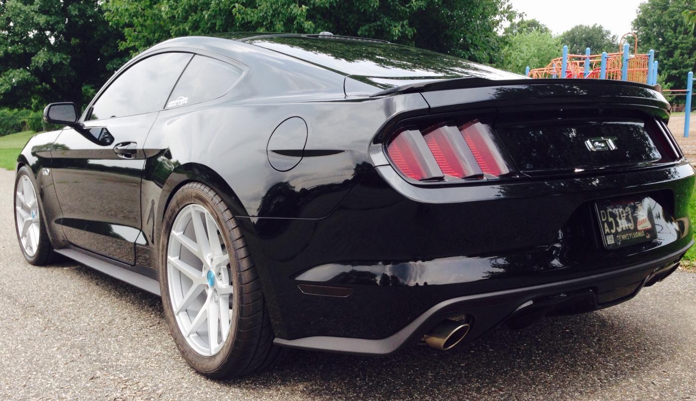

Tires mounted.....
Rear 315/35/20....Ft 265/35/20
Driver side sticks out to the point can't drive the car....removed tears and taking to dealer tomorrow

What a nightmare....
After getting the BMR lock out kit installed and tires mounted still have a problem ....315/35/20 stick out and rub with these wheels

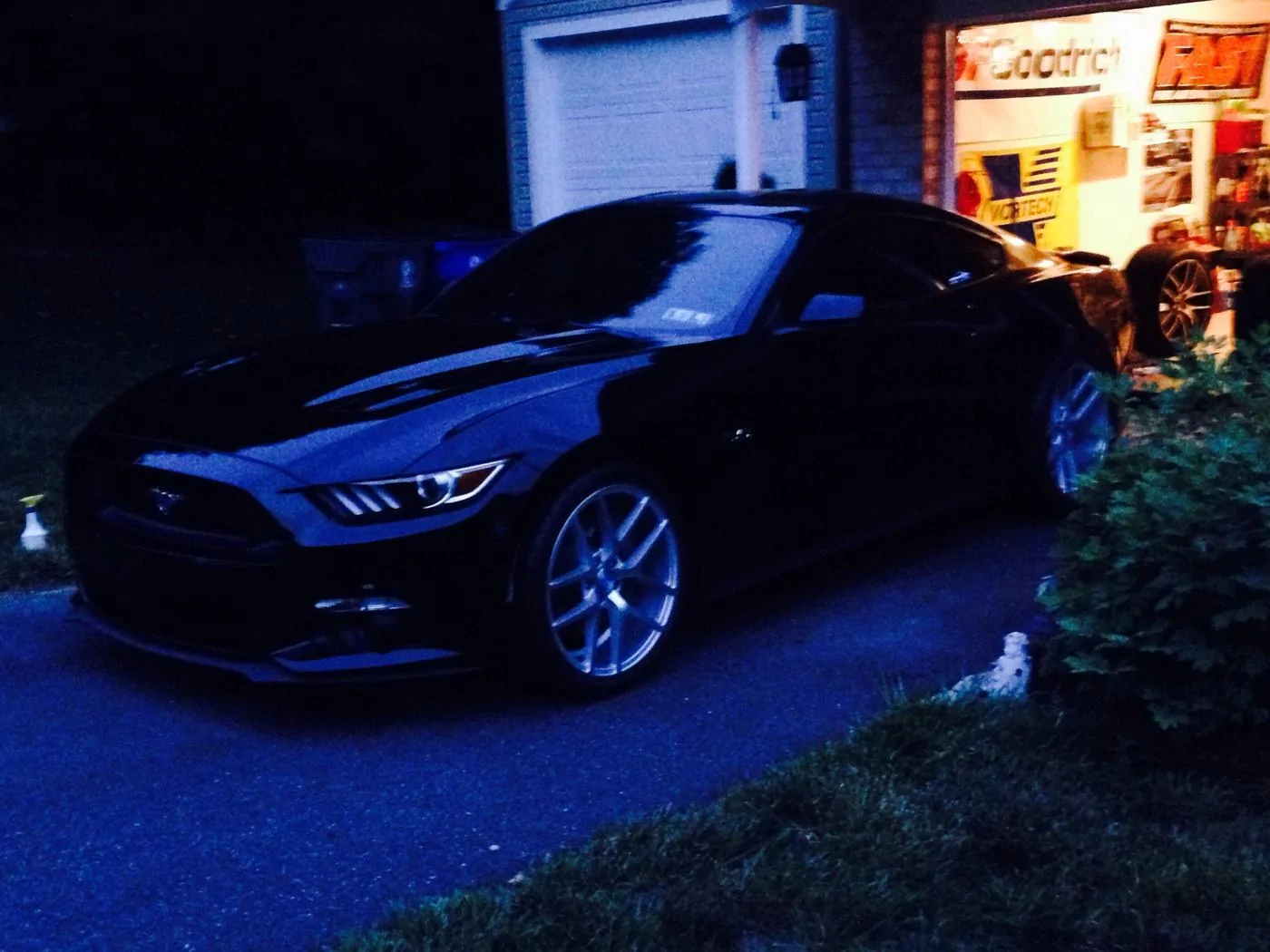

No wheel gap...

Trying to post more pics.... My dilemma is to put stock rear springs back in or change to a 285/30/20 tire.....

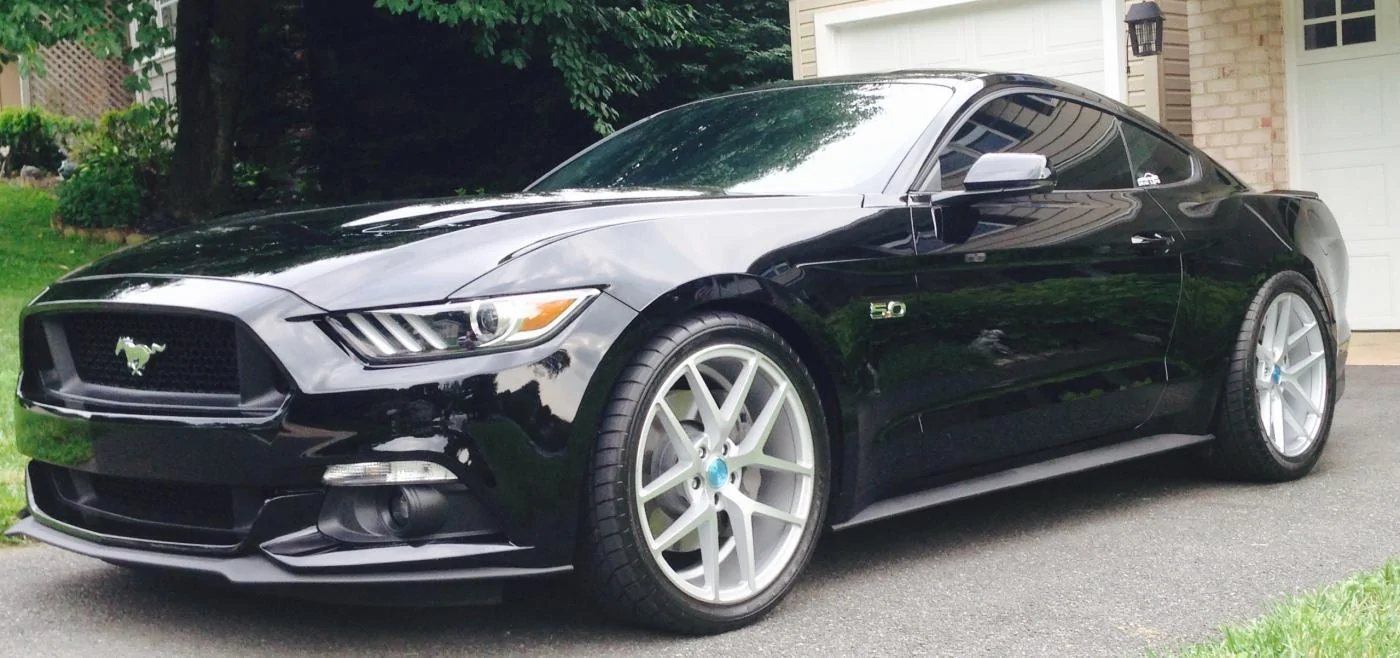

MRRDesignWheels
Mar 21, 2015
1,996
1,635
Los Angeles
Mustang
To wide Amigo, you need the max tire size we did on the mustang
was a 325/25/20 with a 55et ( the wheel was push in )
the 305/35/19 also fit perfect no rubbing again with a 19x11 55et.
i think the 285 will be your best bet.

Tires are now 285/30/20....no rub ....

Brotha what brand tire was the 315 and how much camber were you running?
when you run a 315 you need to run -2 degrees to help fit and clear when the suspension compress.
