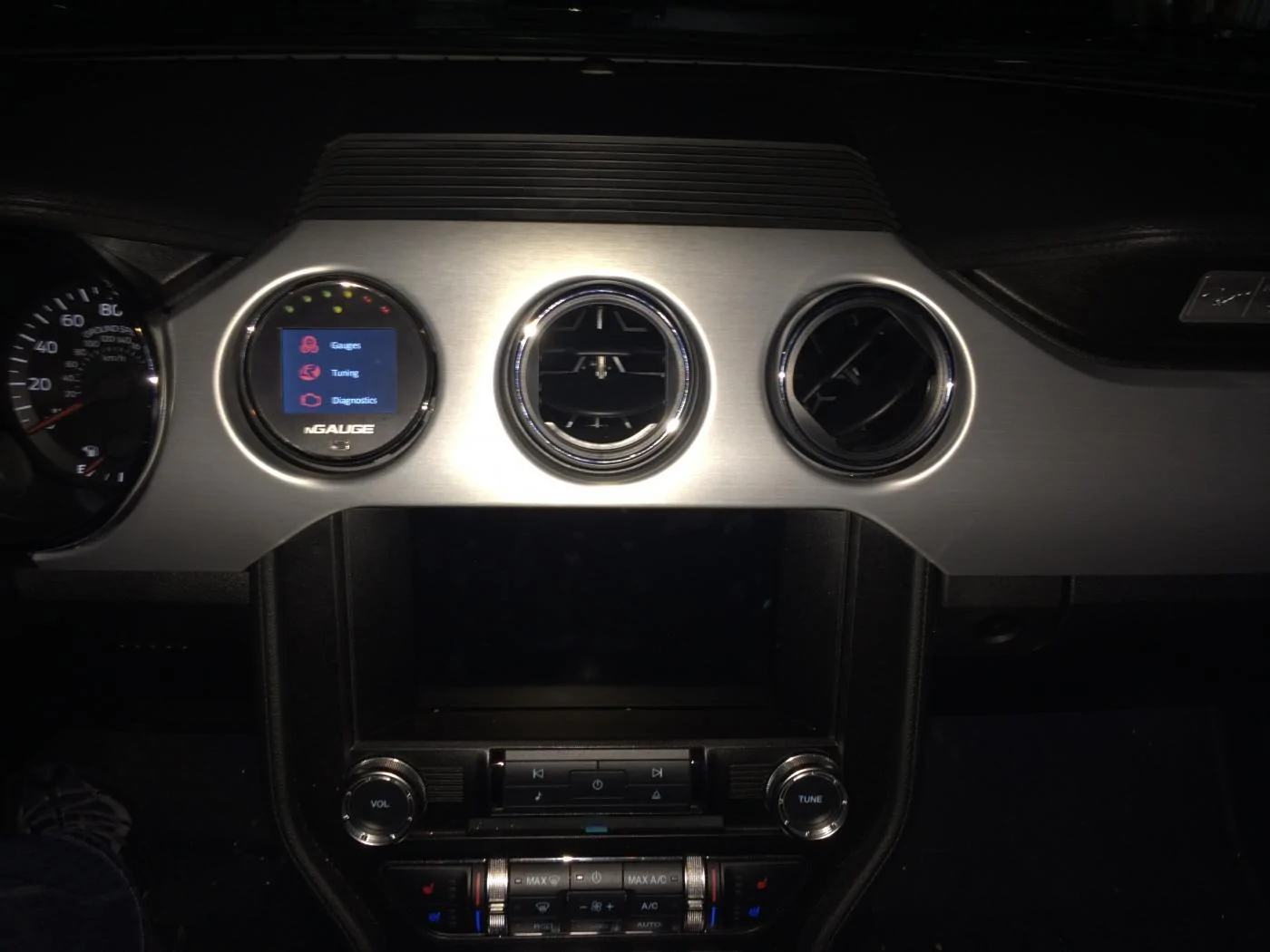

are you able to get the SD card in and out without any problems with it mounted in the dash?
I think with the tape you can pull it out to access the slot if there is enough slack in the cable? Mine does not come out so I have to use the port on the front with a laptop

Well to access the card you will have to pull the gauge out. But I think you can still access the hard drive via the mini usb cord...

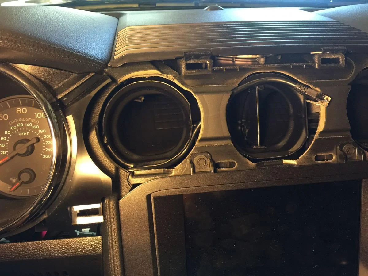

I just ordered some of the blue clips that broke off when I removed the dash. They are cheap.

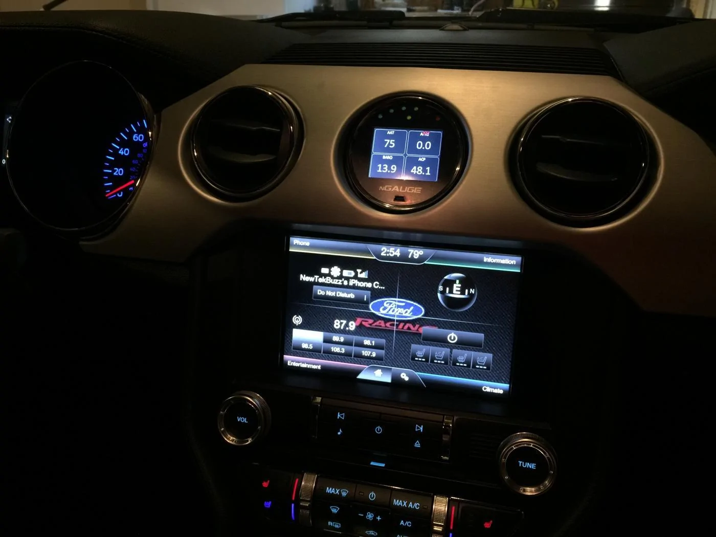

I mounted mine in the Center Vent, but not like you all did. I actually used the vent bezel to mount the nGauge into. I had to cut the outer lip off the vent bezel and carfully sand down the inside of the vent to get it to fit snug. The outcome was a more factory finish as the gauge doesnt sit all the way down into the dash vent panel and has the factory vent bezel attached. nGauge is snug but I can easily remove it if I had to. No tape of glue required.

Pic might be helpful. Sounds like it looks good.Not sure what a new vent piece would cost but I'd rather not cut mine up

I'd also like to see a pic of this please.
