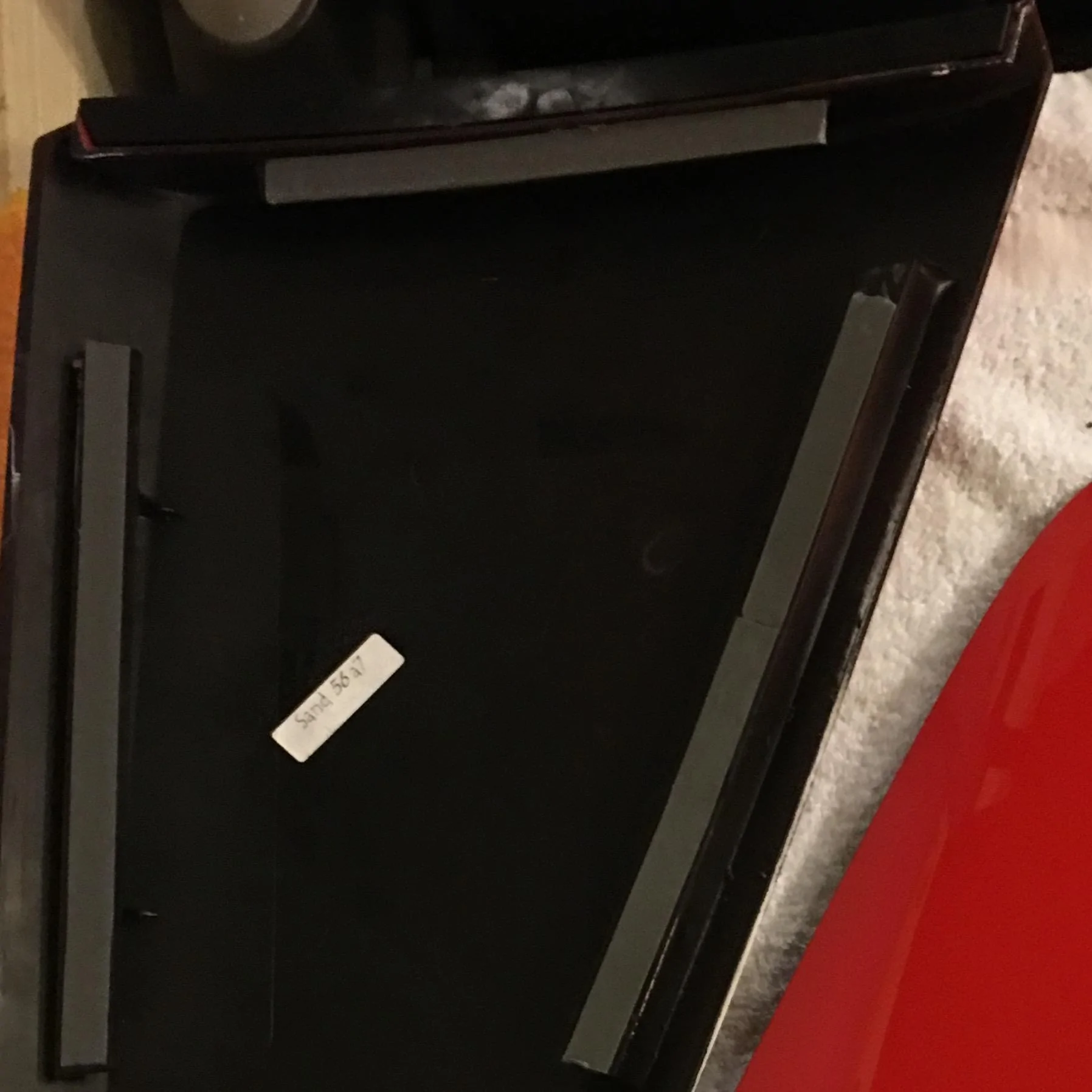

Anyone have issues with having Foose 1/4 louvers to hold on windows? I tried the supplied Velcro strips also 3m molding tape + Gorrila double sided tape and no luck. Any advise would help.... was maybe thinking of some kind of silicone but not sure

Yeah cleaned with rubbing alcohol + adhesive promoter but only had it set for 24hrs each try. It's my daily driver so can't let it set in garage for 3 days Figured 24hrs was plenty of time to set. Not sure what do to? Would hate not to be able to use them cause they look great on the car but don't want them to fly off when on the road.

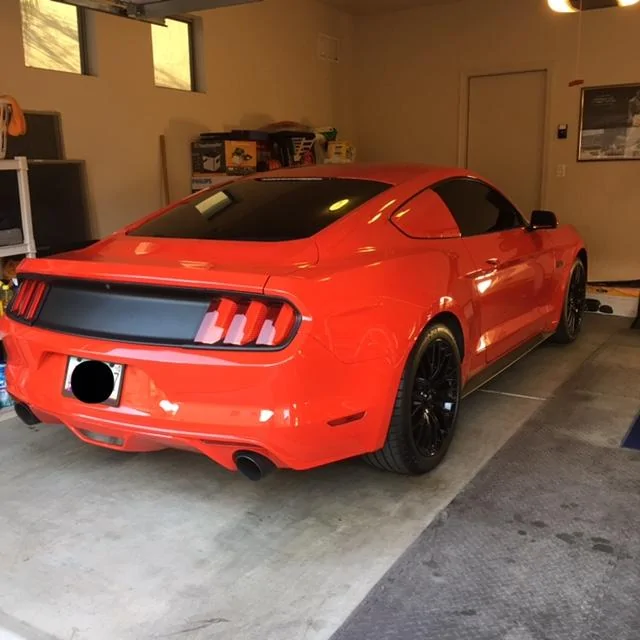

Rear view shot
