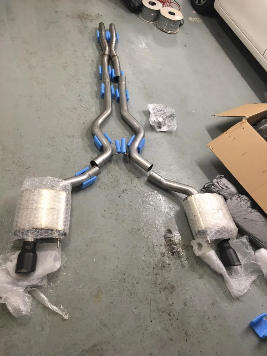

Milltek X-pipe system just fitted. DIY, on the drive by myself no problem.
Advice;
If you're doing it by yourself you'll make life a lot easier if you have a decent trolley jack and various items to support the old exhaust as it comes off (I used a sturdy box and an old bedsheet) to avoid scratching it on the floor or, more seriously, wobbling around and bashing into the underside of the car. Other than that all you need is a decent socket set, preferably with a range of extensions and some deep sockets. You only need 13mm and 15mm sockets.
1. Jack the rear of the car and put blocks under the wheels. I had 200mm high blocks of wood which was fine. The only slightly tight access was from the side to loosen the resonator clamps. 250mm would have probably made it a lot easier.
2. Loosen the clamps on the resonator (15mm socket everything else 13mm).
3. Unbolt the middle exhaust mountings from the car (the brackets hook into the chassis so they don't just fall off on your head!).
4. I found it easiest to then support the exhaust somewhere near the middle mounting with the trolley jack and the unbolt the two rear mounting brackets rather than try to get the exhaust out of the rubber while the bracket was still attached to the car. Make sure you then push the rubber/bracket well up to the silencer so it doesn't catch on the rear valance when you drop the exhaust.
5. You should now be able to unhook the middle brackets (by lifting the exhaust slightly with the jack) and pull the whole thing back slightly to disconnect the resonator. This is where something under the resonator (such as a box) is handy so it only drops a few centimeters - it stops the whole thing crashing onto the ground and/or damaging the underside of the car.
6. You should then be able move the whole exhaust forwards slightly so the silencers and brackets are clear of the rear valance, then slowly lower the jack and pull the whole system out (you'll need to leave yourself enough space behind the car to pull the old system out remember!). It's quite heavy but nothing you shouldn't be able to cope with, especially if it's rolling out on a trolley jack.
7. Fitting the new system is a doddle. Start at the front and work your way back. First connect the adaptors (the Milltek pipe diameter is bigger than the standard system) and the X-pipe. The end of the X-pipe with the slots in is the front end and don't forget to slide the clamps on before you connect the X-pipe to the adaptors. I left all the clamps loose until the whole new system was on.
8. Fit the LH and RH middle sections of the exhaust. It's easiest to attach the mounting brackets to the exhaust before you connect the middle sections to the car. Once the middle sections are in place you can hook the middle mounting brackets into the chassis to give it some support. Then insert the bolts into the mounting brackets but don't tighten them completely.
9. Loosely fit the rear mounting brackets to the car. I used just the vertical top bolt so there was plenty of wriggle room.
10. Fit the silencer to the middle section of the exhaust, slide it well on and you should then have enough room to wiggle the mounting into the rear bracket. Then insert the second second bolt into the bracket and tighten them both up. Repeat for the other silencer.
11. Fit the tips onto the silencers as it makes it easier to align the tips centrally in the holes in the valance.
12. Support the front of the system where it joins the cats with the trolley jack to ensure there is no sag in the joint but don't tighten the clamps yet.
13. I started at the back and jiggled things around until the tips were central in the valance holes then tightened the silencer to middle section clamps. It should then be an easy job to tighten the remaining clamps and the system should be on and straight, with no sag.
14. Twist the tips so you get the logo at top dead centre and tighten the clamps.
Bob's your uncle, fanny's your aunt - job done. 2.5hrs.
15. Go inside, wash hands and get changed out of work clothes.
16. Go back out to car. Get in and leave door open. Depress clutch, and press start ........ :eyebulge: :hail: Oh yes!
Cold start is, to put it mildly, a little attention grabbing - but it doesn't take long to settle down. Sounds bloody AWESOME!!!
