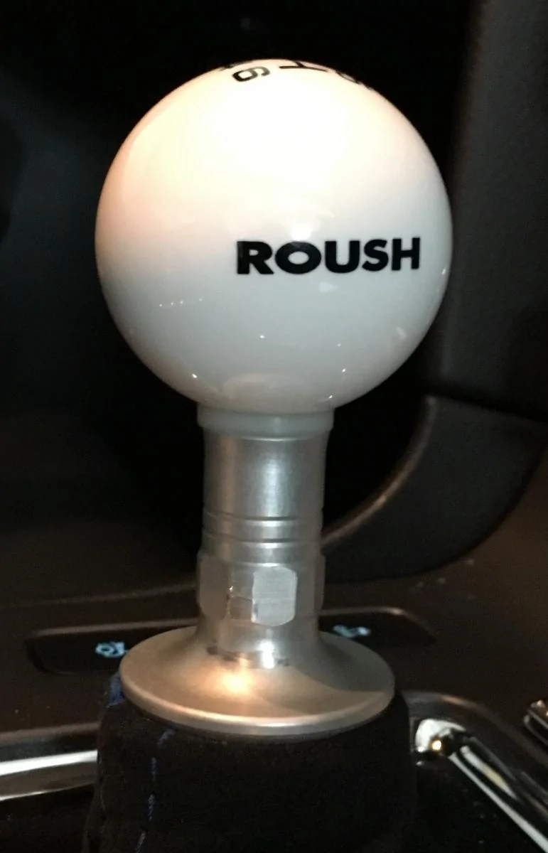

Here is how mine looks. Looks like it stands out here but I don't even notice it getting into or sitting in the car. The knob rattled/buzzed the whole time the car was running before doing this. I had the lock nut tightened hard against the shift knob too. It seems that the metal from the lock nut was tight against the metal insert of the shift knob but maybe the plastic ball was buzzing on the edges of the lock nut. I am not really sure what was going on, I just know this is what worked for me.
