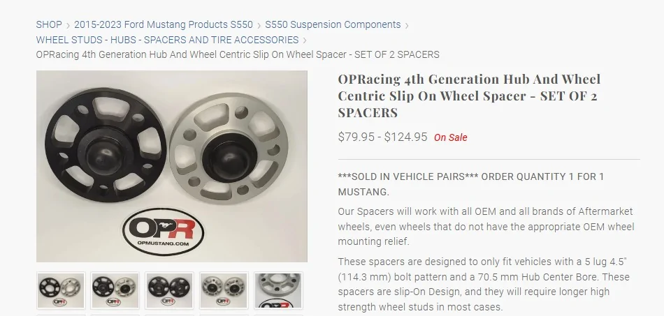

All of this information was clearly explained on our website:
1. ***Application Note: 2005-2022 Ford Mustangs with a spindle mounted front hub*** The hub/wheel mounting centering ring protrudes approximately 0.100" further than all the other hubs. Our 12 and 15 mm spacers will not work on the front of these cars. All Magnetic-Ride Mustangs, GT350/GT500's are not affected by this.
2. All the 4th generation spacers allow the use of the OEM Dust cap found on millions of Ford vehicles. If you use wheel spacers in the rear, you can utilize a dust cap in the spacer to cover the Axle Nut. This also prevents track pickup from making its way into the area of the hubs. It provides a nice, clean, finished appearance.
