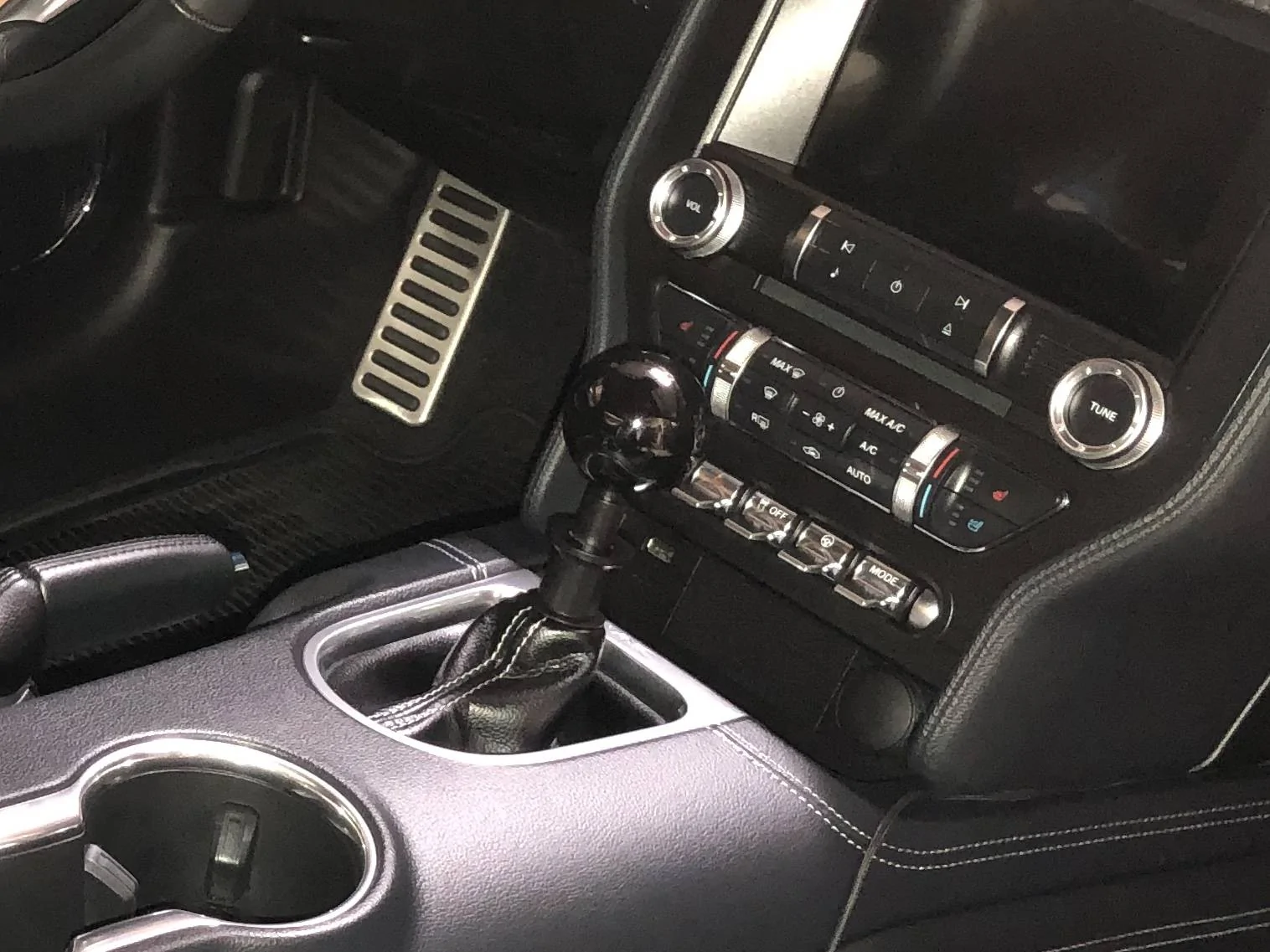

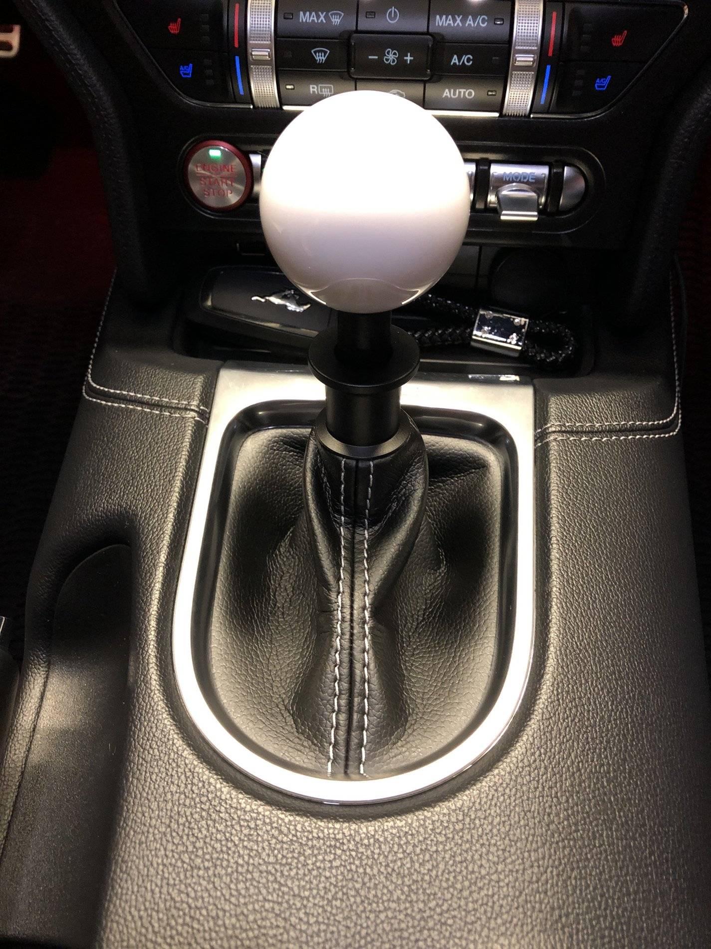

Did mine a few weeks ago. WMG short shifter with manual bezel. Straightforward install, if you get the short version you will have to trim 1” off the shifter post.

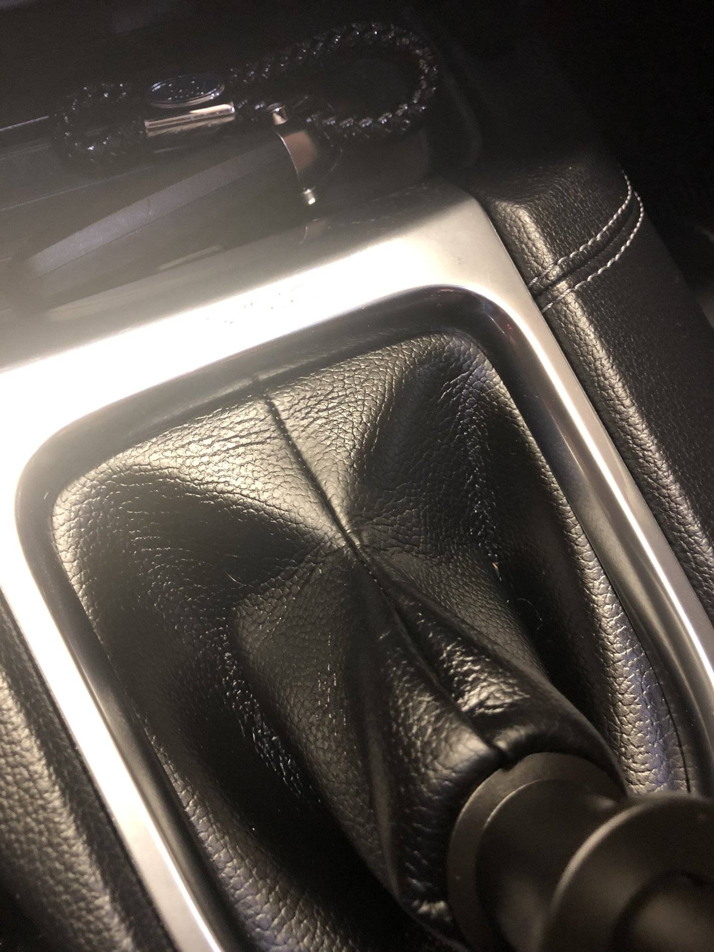

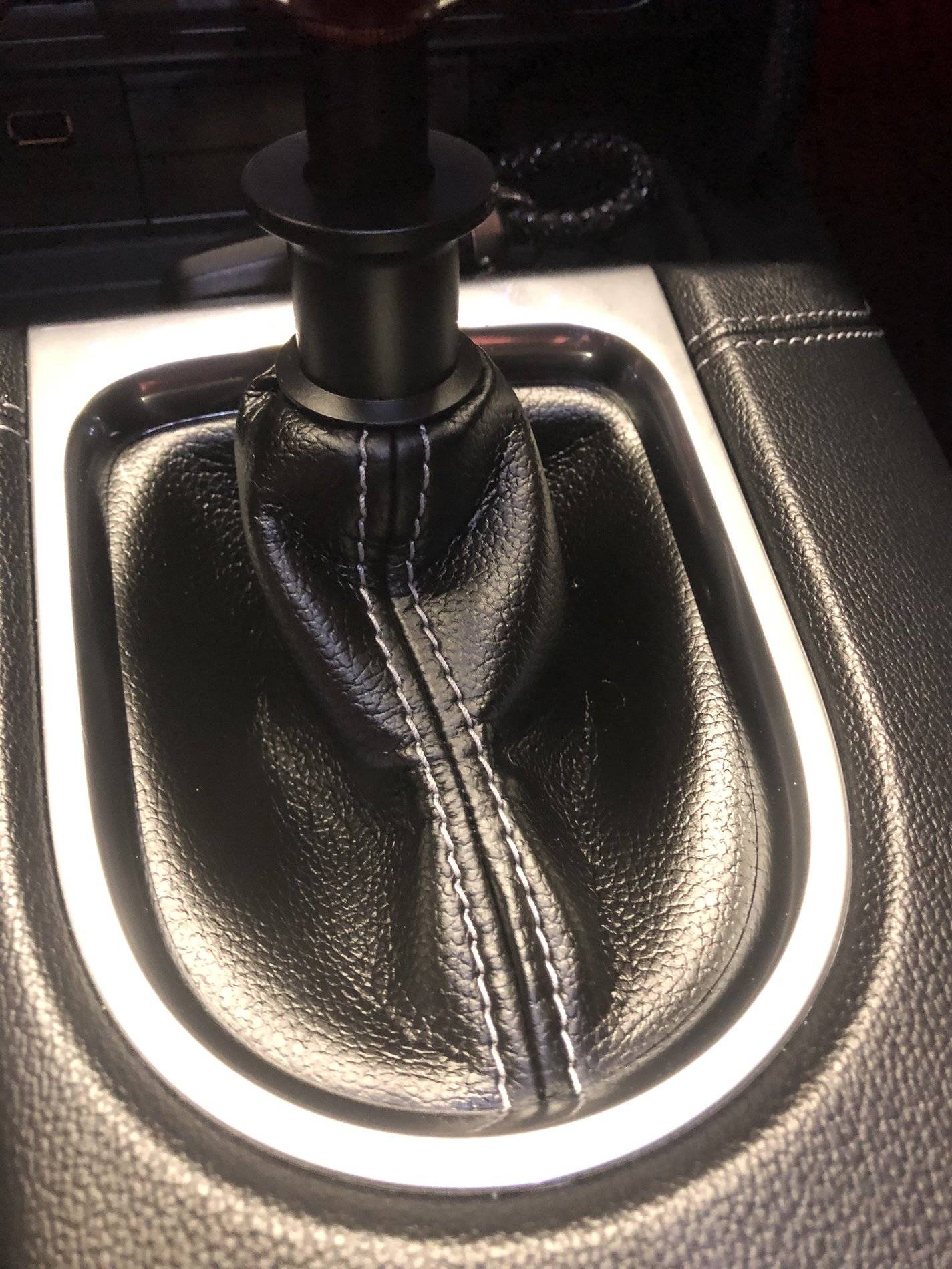

I took a part number to the dealer and ordered it... my car is a 2019 401A and you can see in the pic it has the white stitching. I think JR3Z-7277-GA. It’s says ebony but the rear part is white stitched. You can search here and see the pic of the part
https://www.tascaparts.com/oem-parts/ford-boot-jr3z7277ga/?c=Zz1ib2R5JnM9c2hpZnRlci1ob3VzaW5nJmk9SkMxNTQ4MDUmcj01JmE9Zm9yZCZvPW11c3RhbmcmeT0yMDE5JnQ9Z3QtcHJlbWl1bSZlPTUtMGwtdjgtZ2Fz
Here is a pic of mine.. rear is white stitching front is stitched inside
