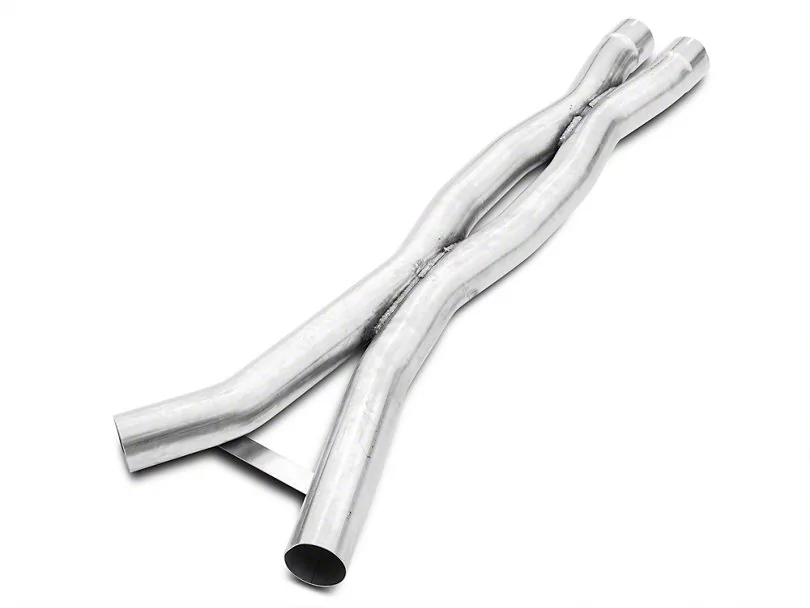

I am currently running MAK cat deletes, Flowmaster Scavenger X-Pipe (2.5 inch), and a "custom" 3 inch Magnaflow Street Axleback. I originally had the Flowmaster Outlaw axleback and never liked the sound but when I installed the cat deletes it was god awful loud and sounded like crap, so I cut the Outlaw mufflers out and welded in Magnaflow street mufflers in their place. Sounds decent but the magnaflow streets are a little to quiet for my taste.

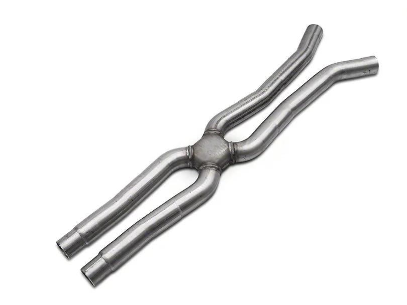

So I'm gonna bite the bullet and go the Corsa route because they sound sooo damn good. I think the Corsa Sport Catback along with the MAK cat deletes is a good sound and the level of "loud" I'm looking for. So with all that being said should I just get the Corsa axleback and pair it with my existing 2.5 inch Flowmaster Scavenger x-pipe (in order to save a little money), or buy the complete Corsa Sport catback for a full 3 inch exhaust?
Will the Corsa x-pipe design make a big difference in sound over the flowmaster design? Thanks in advance, and yes I am aware I should've went full catback from the get go instead of piecing stuff together.
For reference the flowmaster x-pipe and then the Corsa.

I'd go full 3". It will connect to the double X-pipe directly if you get the version for that, and it'll sound better (they do the Double X for sound). If you look lightly used you can find them for ~$900-1000 for the full catback, or new and significantly less than the usual $1500 you see at AM if you go with Hypermotive [MENTION=9610]jayman33[/MENTION].
