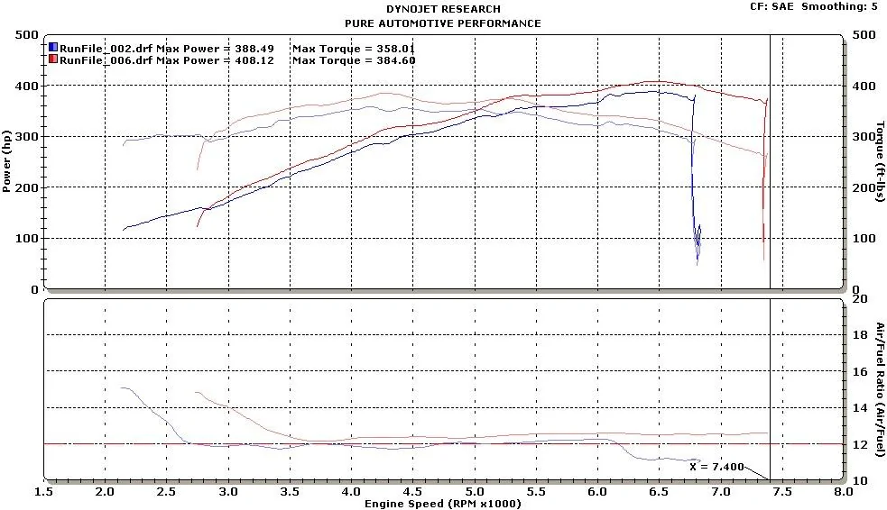

The red line going straight across is 12.0 AF RATIO , next black hash mark would be 12.5 ... Line barely goes above that so the highest afr during that WOT run would be 12.6 12.7 that's as perfect as it gets...anything below 13.0 is safe
Next hash mark is 13.0. I dont see anything above 12 really. If correct, they have left quite a bit of power on the table but who knows how accurate that AFR is. Any data log of the run? Be interesting to see the delta.

after the red dotted line going across representing 12.0 AFR there's 1 black dot just above representing 12.5, the next black dot after that represents 13.0 then the next 13.5 and so on. The AFR going across never reaches the second dot above the red Line, so it never reaches13.0 or comes close. You don't really want to touch 13.0 it could be on the too lean of side. Especially since its a email tune I'm sure he's not trying to push it since all cars run a little different. 12.8 12.9 would be maxing out so by him doing 12.6 or 12.7 on an email tune with a AFR WOT line that's pretty straight across I'd say he is. Real good at what he does there. I'm sure a lot of guys will agree.

That looks fine to me. Not too sure about being '16 SS ready though.
