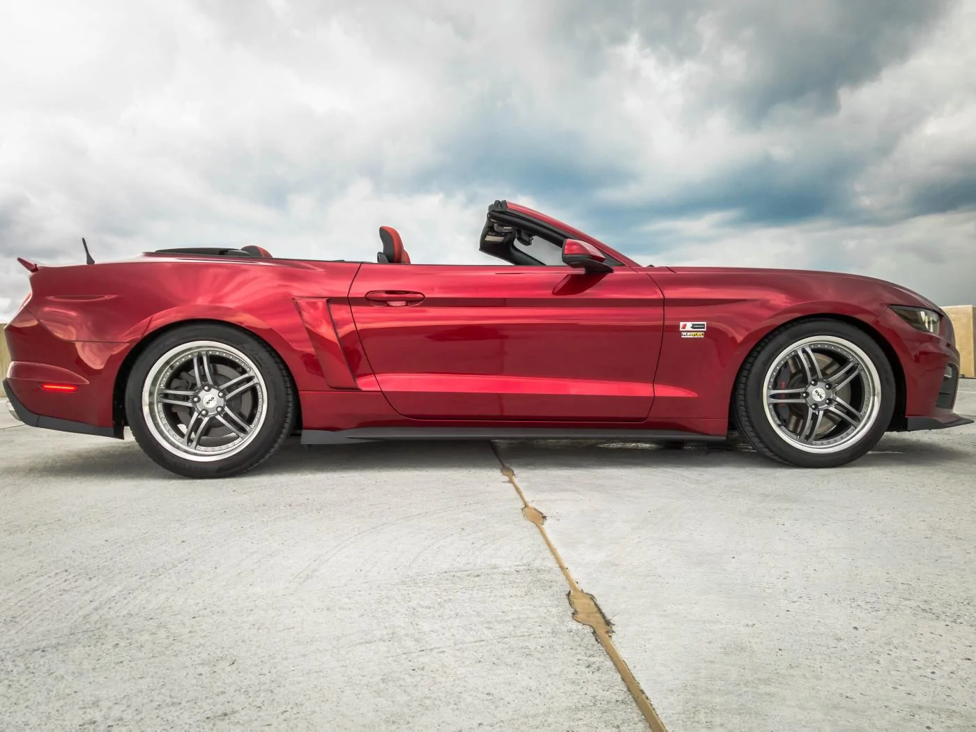

Damn I remember now....it was you that told me that you had them on a vert. I couldn't remember who it was :headbonk:.The car looks great BTW, what size wheel and tire do you have? I have a 325/30/19 on the rear of my car and the profile leaves a little more gap in the rear than the front...

19x9 / 19x10
stock 255/40 - 275/40
eventually the rears will be replaced with 305/35. Going to wait till i need more power or the tires wear out though.
