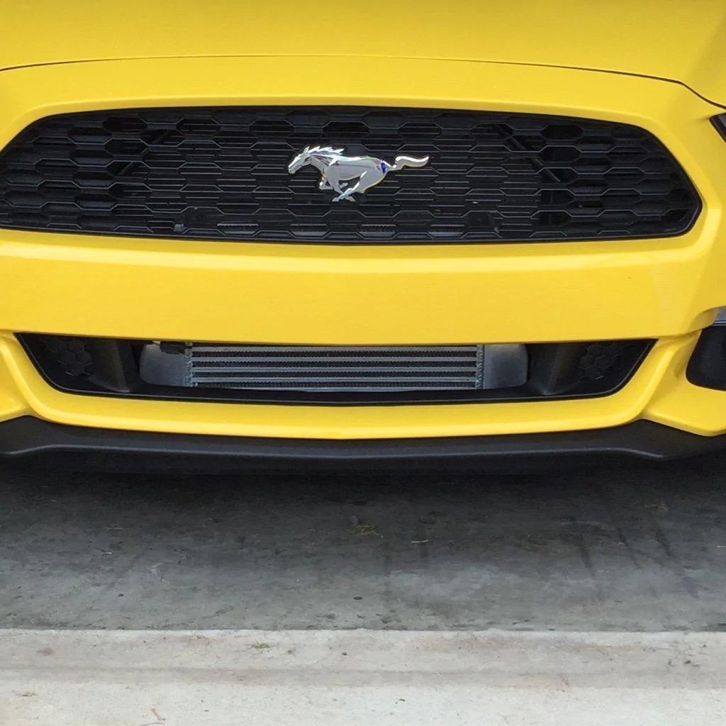

If you're worried about airflow, this was just posted in the eco section:
Deleted my lower with a GT lower, trimmed the center section out, I think it looks awesome.
I have the lower GT grille sitting on my table right now. This is my plan, maybe with some light mesh behind it to avoid destroying my MAP intercooler with the insane amount of construction debris around here.
Honestly, you're probably not going to see much of a difference in IATs. Open is open. A slightly higher cross sectional open area is not going to affect your intercooler as much as replacing that oem piece with a good aftermarket upgrade. Don't know what you're getting, but unless its a a Mishimoto, it likely has enough core volume and flow area for well beyond stock hp.
