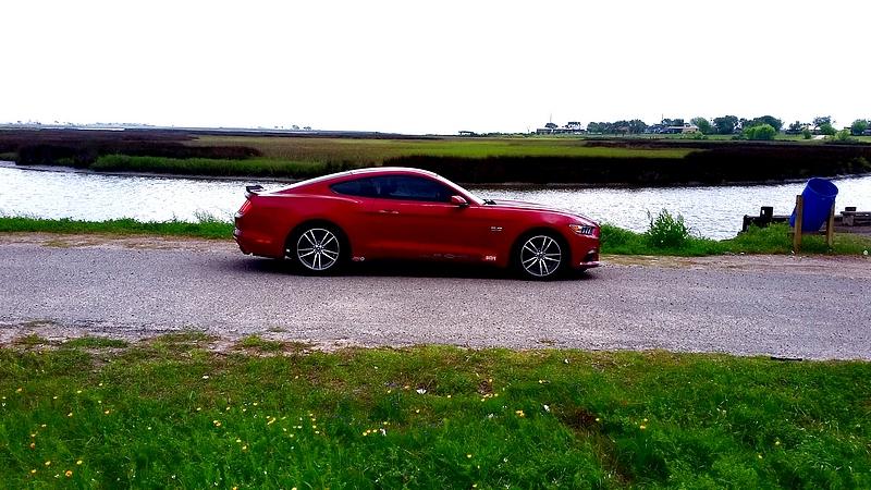

Dropped
I am happy with the SVE progressives and they are ok with oem shocks. Adj. shocks will make them work much better. The stance is very nice.
