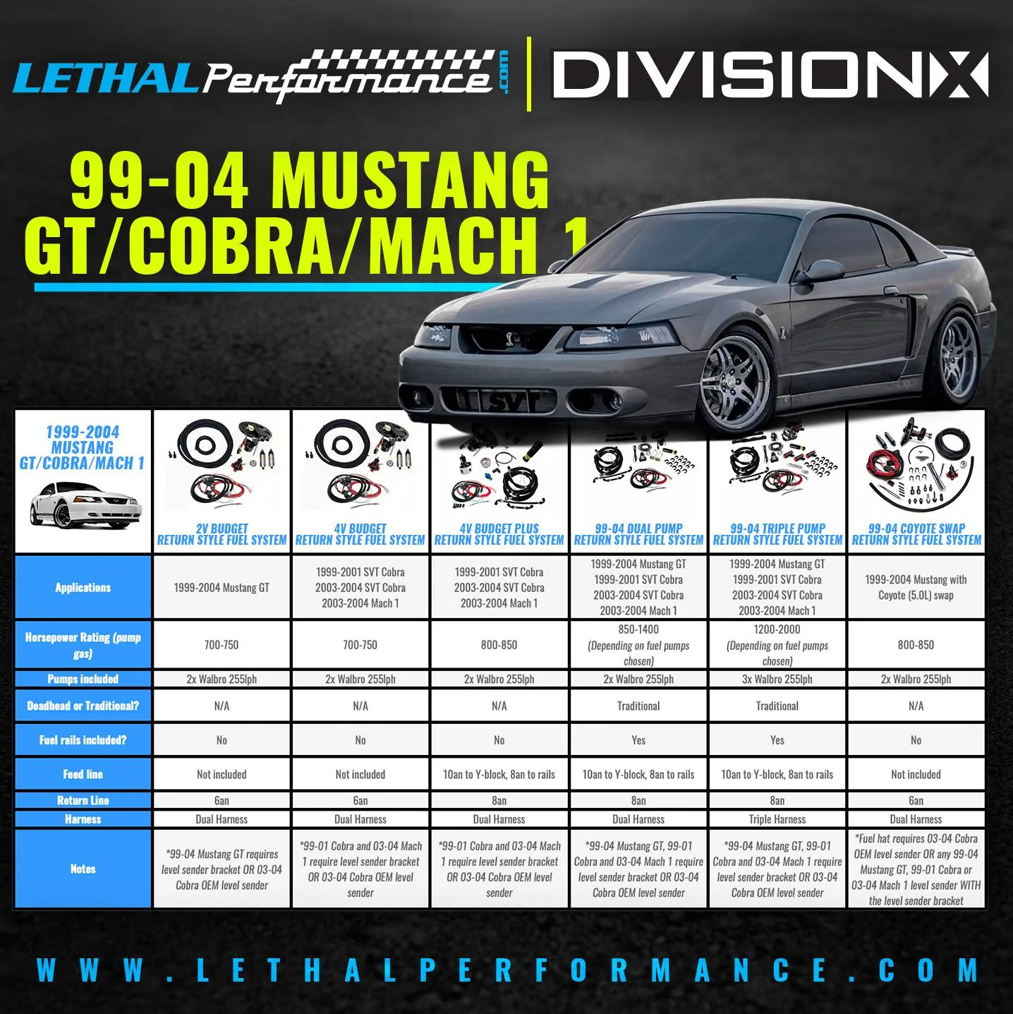

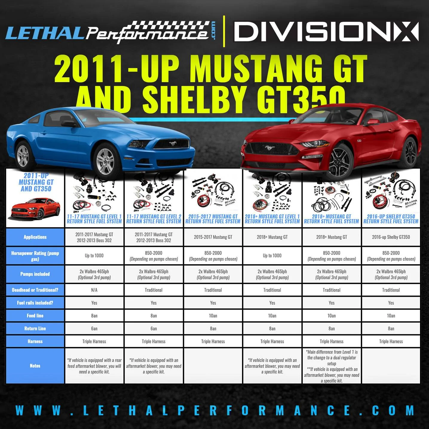

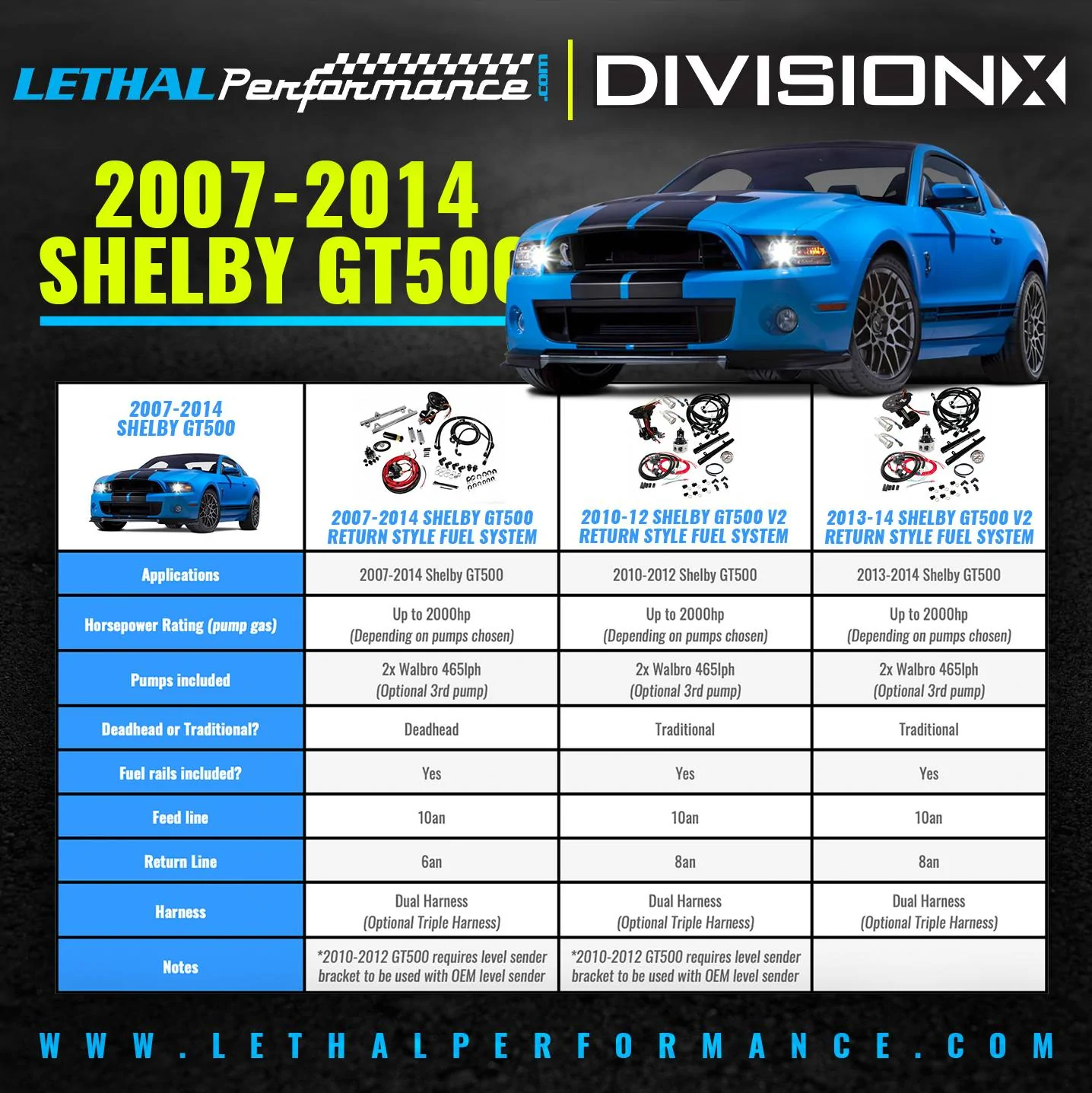

We got a lot of questions related to the fuel systems on late model Mustangs. We've actually compiled an FAQ page with our most commonly asked questions (click here to check it out).
With that said, we're going to dig a little deeper and let you know all the details on our very own Lethal Performance fuel systems: from their horsepower ratings to what size feed & return lines they come with. Check out the charts below for each vehicle group to help you decide which of our fuel systems is the right one for YOUR BUILD.
LETHAL PERFORMANCE FUEL SYSTEMS: A REFERENCE GUIDE Link - https://www.lethalperformance.com/info/lpfuelsystems
