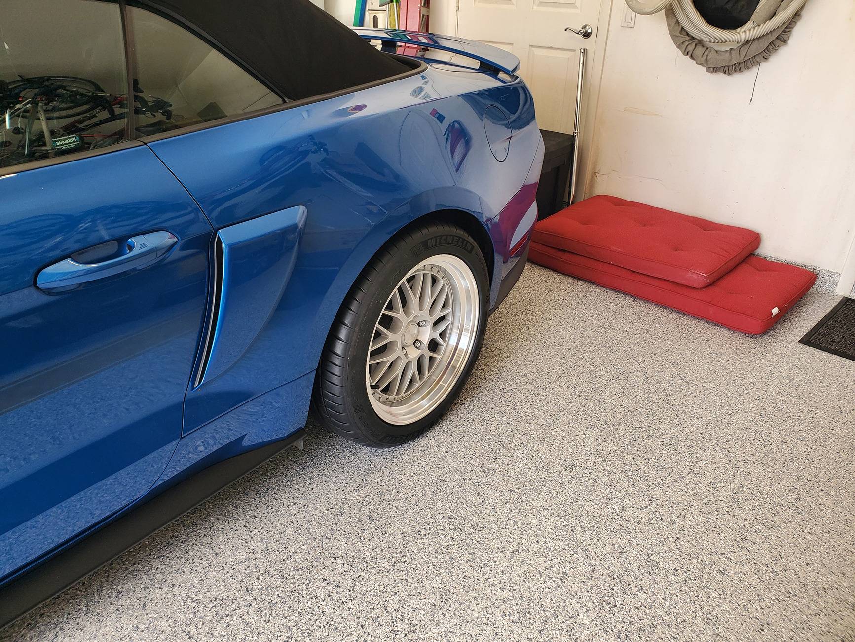

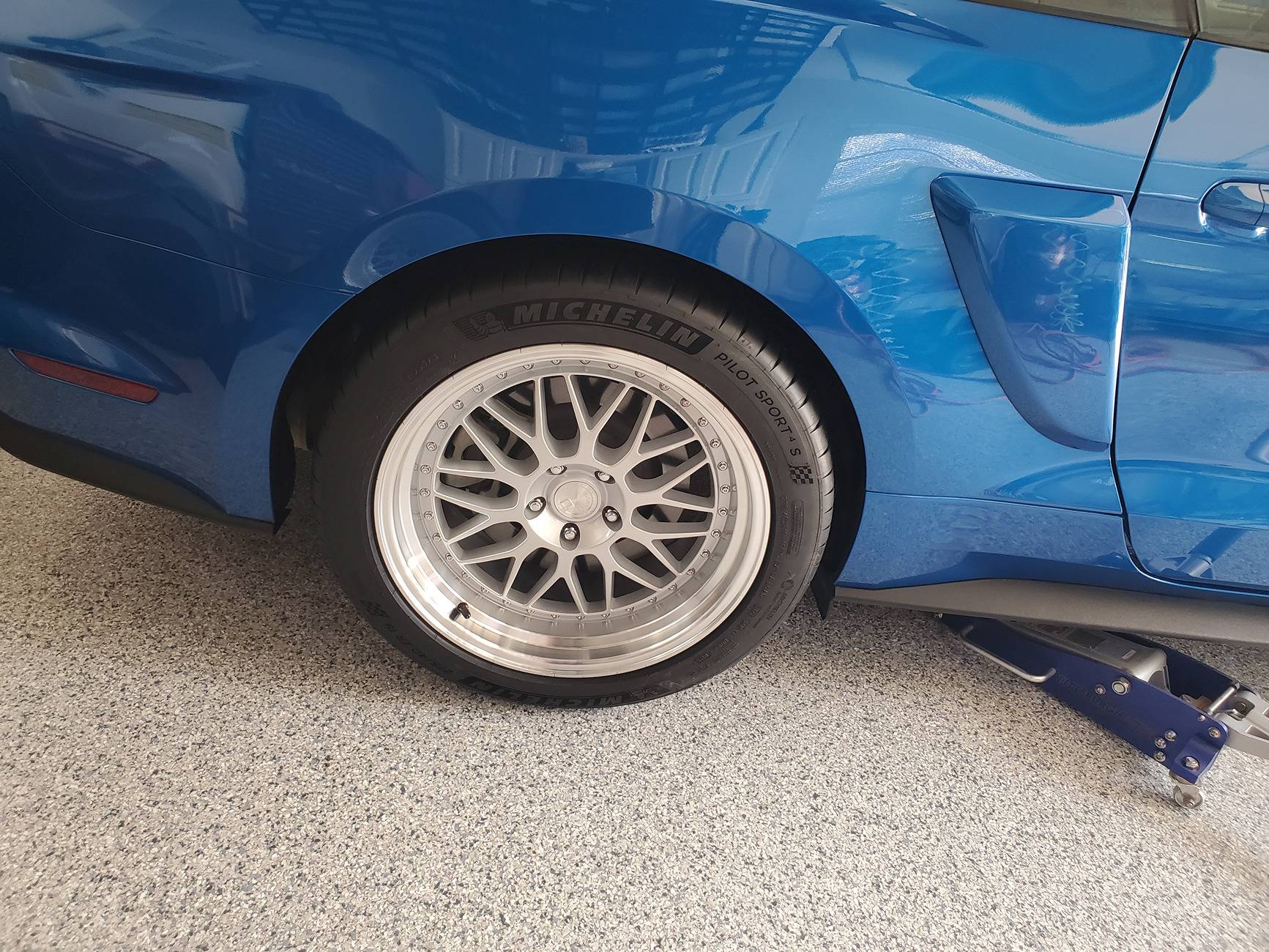

The wheels and tires arrived finally. It had been a moment I was patiently waiting for all week. I got out into the garage to unwrap everything and do a test fit.
Turns out, the Adohan AH02 in a 19"Ă—9.5" 30et just barely kisses the caliper in front. Rears fit fine with a tiny bit of poke. The new wheels and tires weigh in 3lbs less than the OEM.
I ordered a pair of 3mm spacers for the front that should arrive tomorrow.
