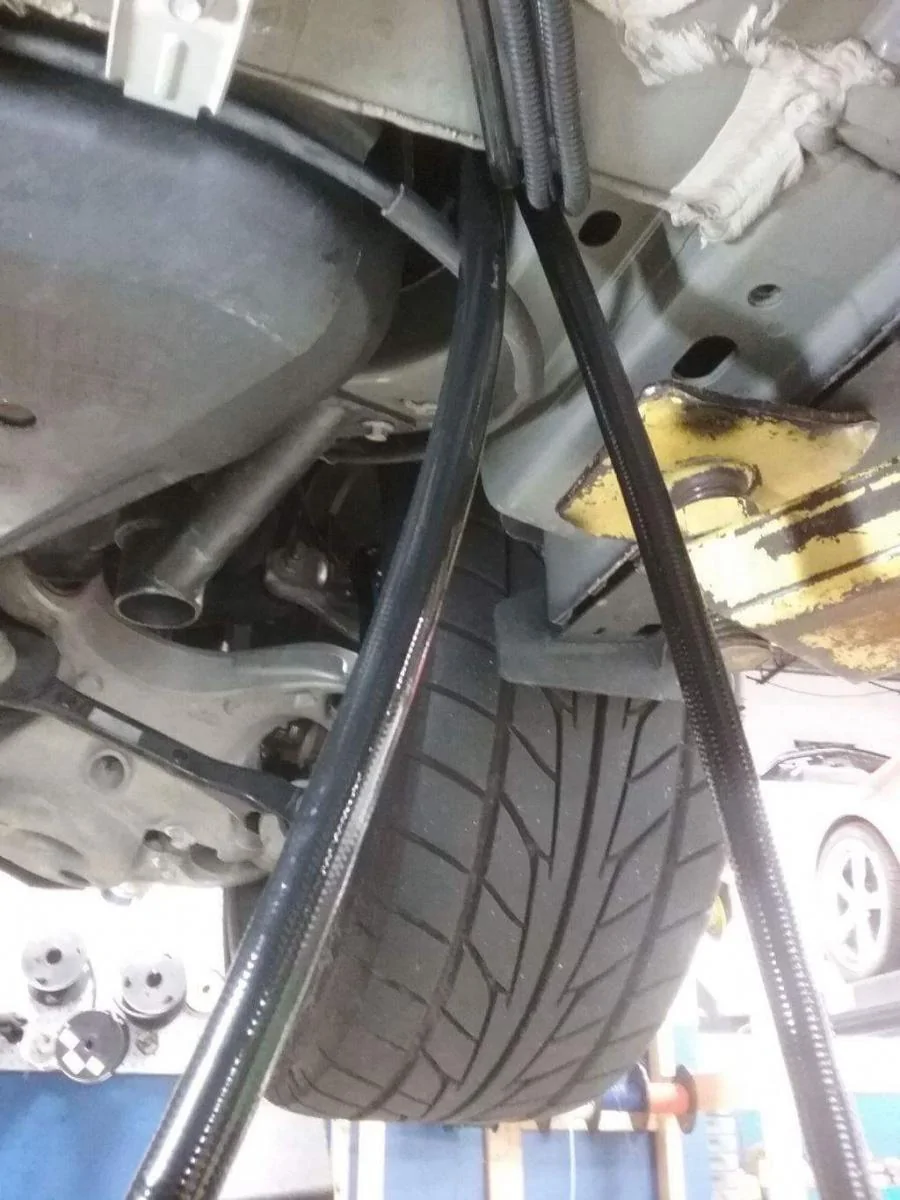

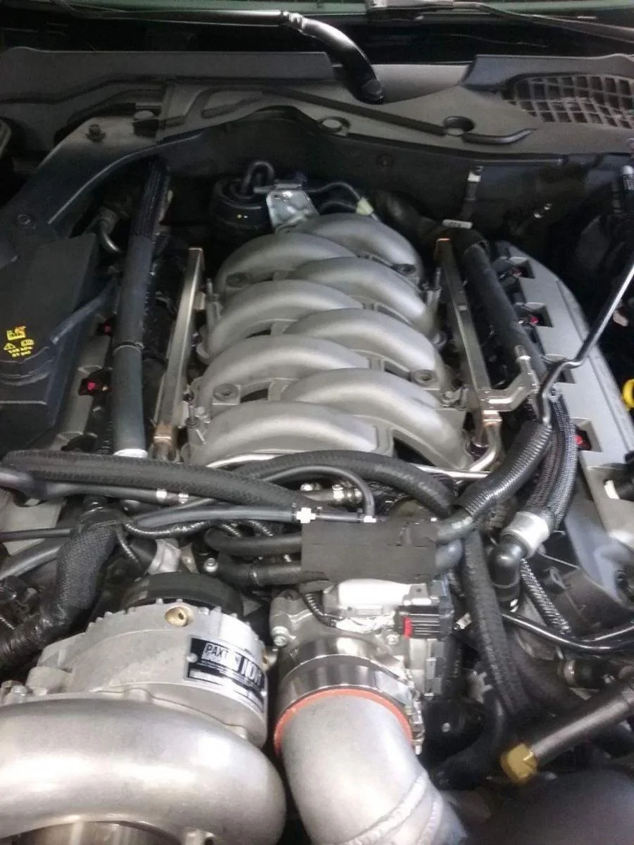

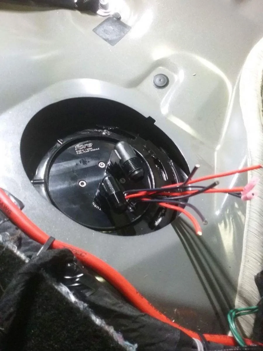

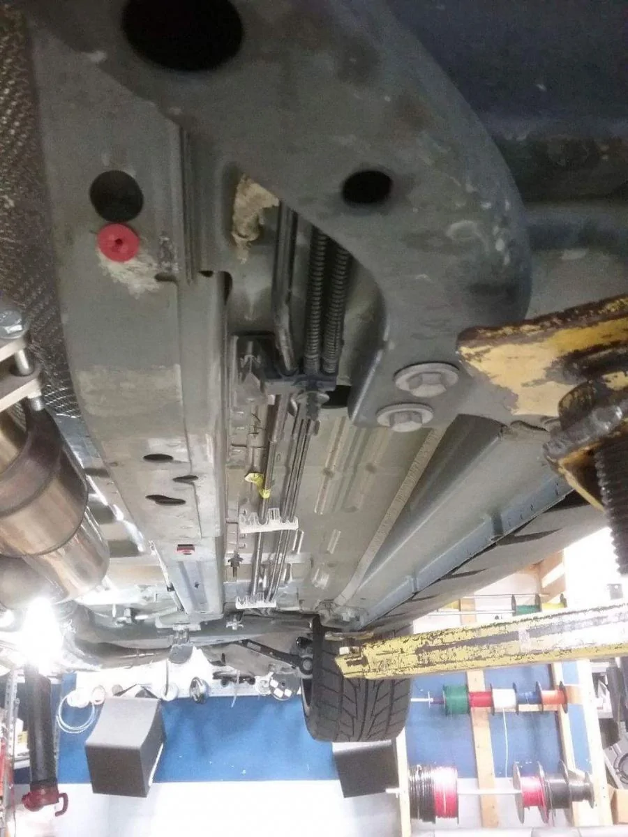

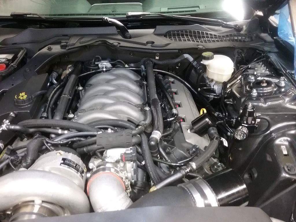

Looks nice, couple questions.

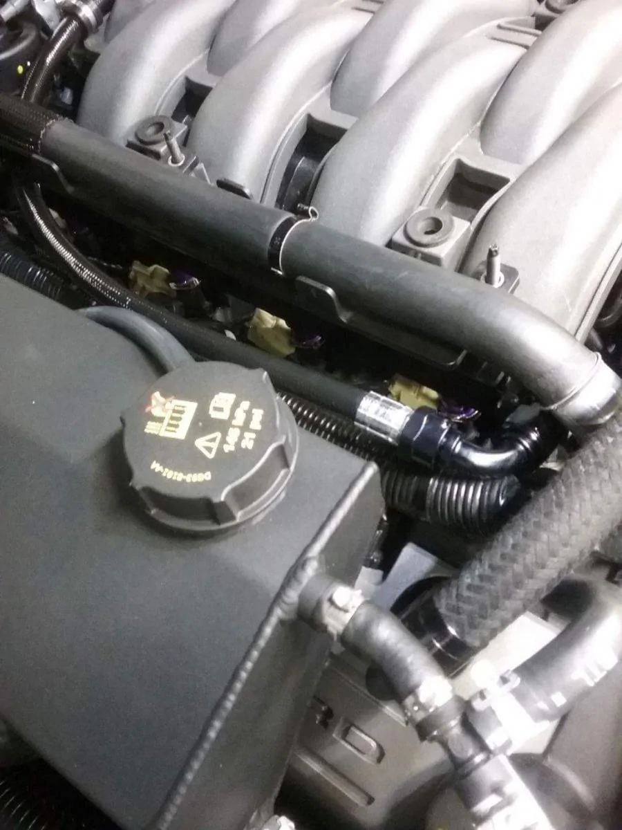

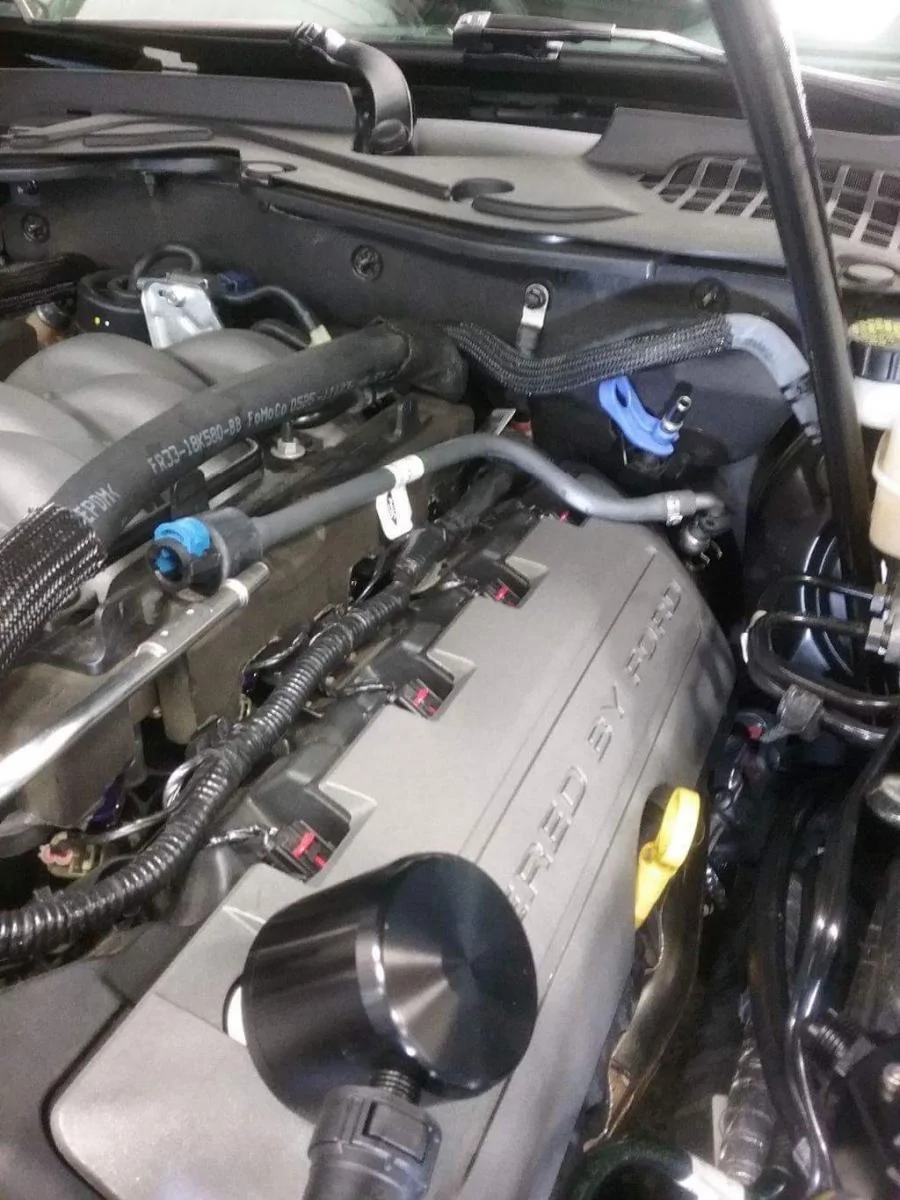

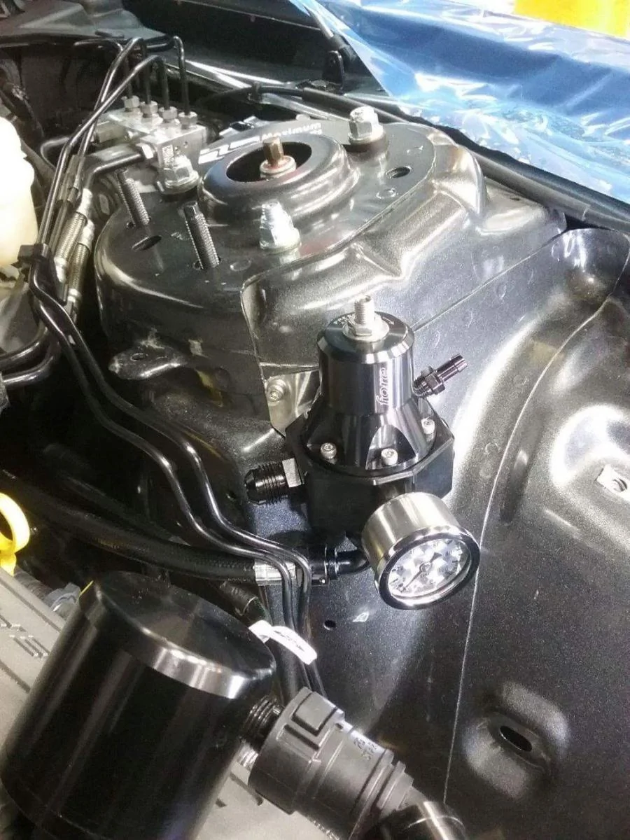

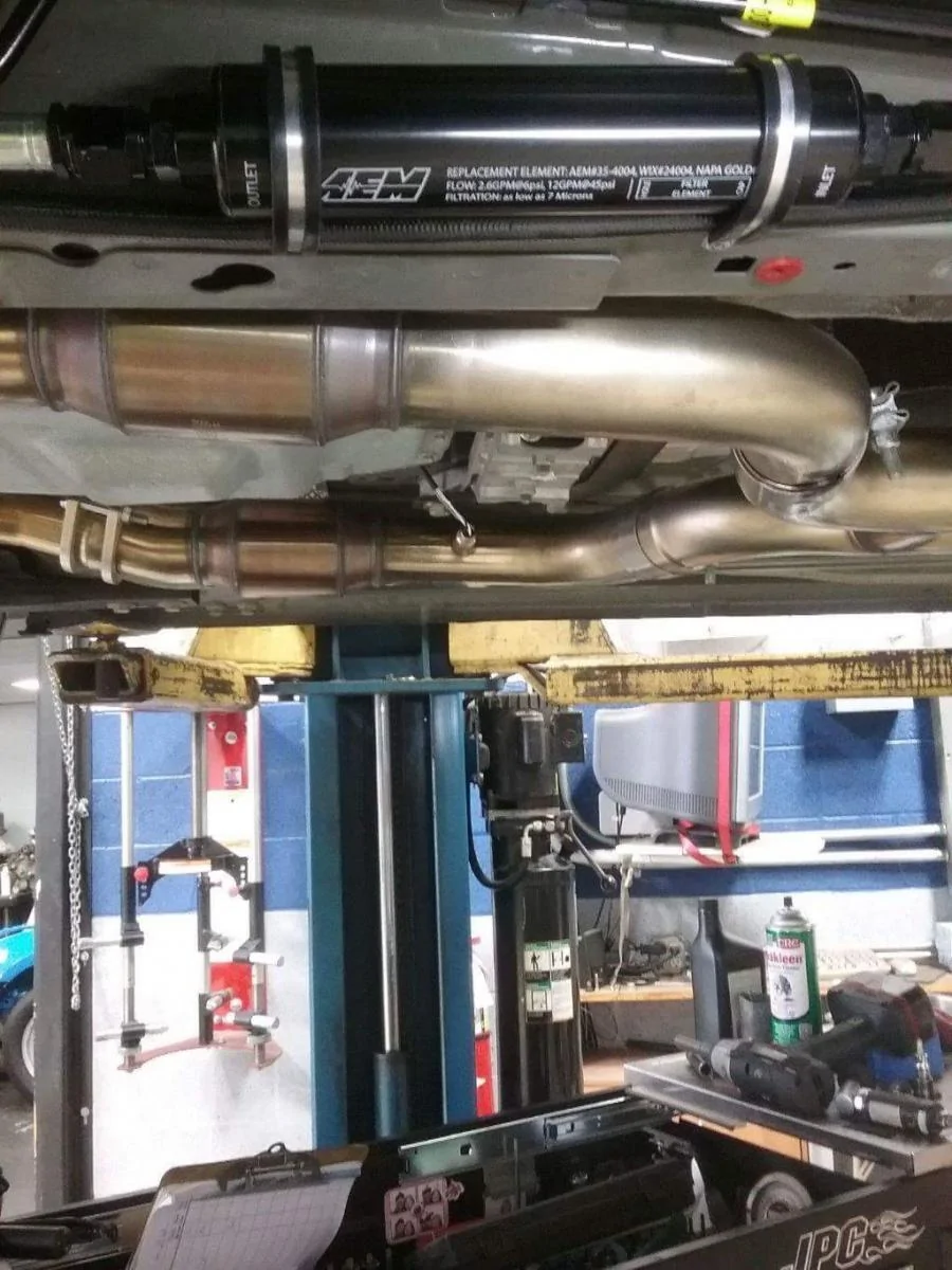

What line material was used? Kind of looks like Fragola 6000 but in other spots looks like pushlock goodyear hose.

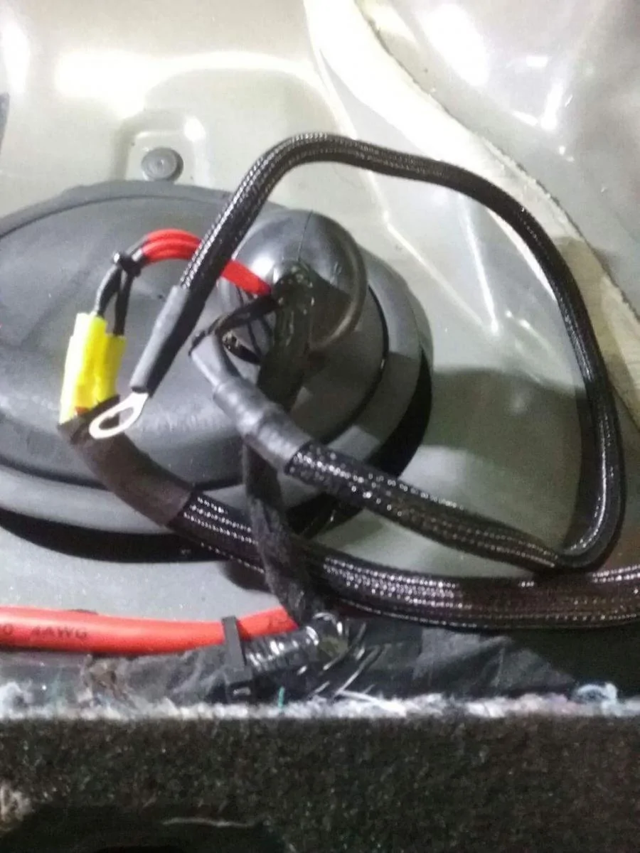

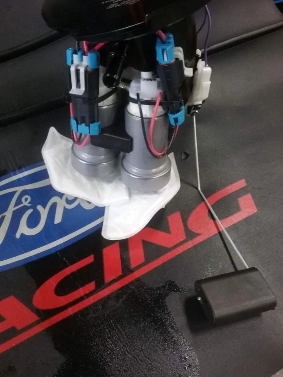

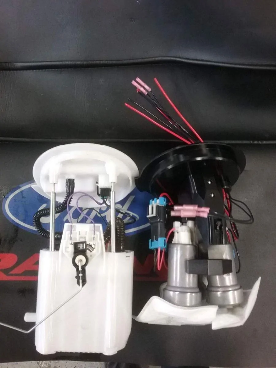

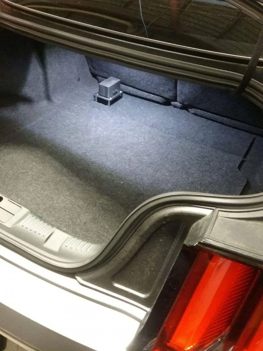

I didn't see an FC3 controller, what are you using to trigger the pumps on and off? Youre not running all three all the time, I presume.
All PTFE hose -10 feed/ -8 return. I currently have 2 wired up full time and 1 on a Hobbs switch. On long drives I usually just pull the relay for one pump so it's one on full time. The relay box is mounted in the trunk.
