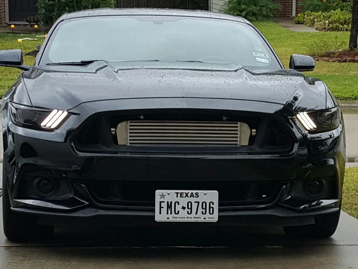

I'm currently running a cxracing core on my car. Custom set up that my friend came up with and fabbed at his house. Has been working well for the last 7 months, no complaints! I like how it's different from everyone else.
Different is correct and looks bad ass.....good job.

I will take a pic and upload for you. He made a map flange and drilled a hole in the side of the core. Then I had it welded on to the core.

Yea all in for parts, fab work, and welding I paid about 500. That was with charge pipes and bov as well. Piping route is a bit shorter then running down low too.
