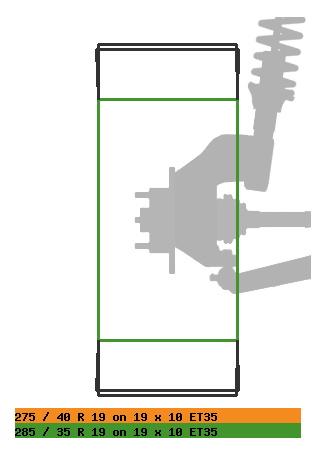

So this is what my 275/40 l;ooks like against a 285/35. Im thinking the 275/40 is too tall
Scott Wilson
Scott Wilson
s550 is life
Feb 1, 2016
313
99
Central TX
2016 Mustang GT
Even a 275/35 looks like it would be better

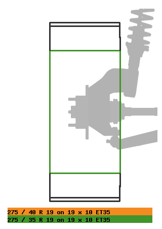

Here is the real head scratcher though. a 275/35/20 has the same height
